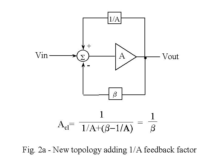

Consider a physical implementation of the amplifier block A.
Given an input signal Vi, the output of this block will be
A*Vi+f(Vi)
where f is a function that corresponds to distorsion
products, noise etc. The problem with your circuit is that your
feedback block must implement the inverse of this function,
that is,
1/(Vi*A+f(Vi))
and not just 1/(Vi*A).
Edit: Actually, I realize now that even this was way too much
simplified. One would have to implement some even nastier
function, but I think the above should at least visualize the
problems with this approach.

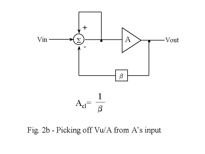

Jan,
Sorry for being rather off hand, I was in a hurry
. Christer raises a good point too: that making 1/A is practically very difficult. However, my point is simply this - you cannot remove the affect of a component in a signal path, completely, unless you are applying infinite feedback or a perfect pre-compensator.
Take circuit 2b. There is no finite solution to the summer output voltage unless Vin = BVout exactly. In any other case the summer output will be infinite. This is because the summer output is fed back to its input - positive feedback. Consider the case when A=0; it most certainly has an affect on the transfer function. The maths includes the assumption of infinite gain: the summer is now effectively an op-amp with infinite gain.
In the first circuit you have employed the perfect pre-compensator and then apply infinite feedback as well. I reason that if it were possible to make 1/A then why not make n/A and put it in series with A as a precomp, thus avoiding any feedback at all? In this case the transfer function would be n.

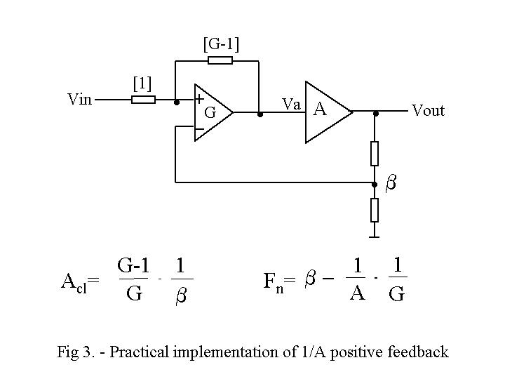

New Fb
Christer, now we're getting somewhere!
Of course I don't agree: the output of the system Vo=A*Va+f(Va), where Va is the input to the A-block, and f(Va) is the noise, distortion etc generated inside A, as you noted.
Referring to my last diagram, if you calculate Va as function of Vi and beta*Vo, and make that equal to Vo/A (which is Va of course), it will become very clear how such a simple circuit can be very elegant: A disappears!
I don't have time now, but will post the calculation this evening.
Jan Didden
PS Just saw Traderbam's post: 1/A is very easy to make, or rather: 1/A*Vo, because that is Va! (See 2nd diagram). Realising that was a huge time saver for me. And yes, A must not be zero, agreed. A must always be positive in this application. Your last point is interesting, let me think about it.
Jan
Jan Didden
Jan

fb
Referring to my 3rd diagram in the earlier post:
First calculate the V+ and V- input voltages at the summer block:
The contribution of Va to V+ = 1/G*Va = Va/G; the contribution from Vi = (G-1)/G * Vi, so by superposition V+ = [Va/G + (G-1)/G*Vi).
V- = b*Vo (I'll use b to indicate beta, the nfb factor)
Since Va = G*(V+-V-), Va= G*[Va/G + (G-1)/G*Vi - b*Vo] = Va + (G-1)*Vi - G*b*Vo.
You're still with me? OK: subtract Va on both sides, you get:
(G-1)*Vi-G*b*Vo=0.
So, (G-1)*Vi=G*b*Vo, therefor Vo/Vi = (G-1)/G*b. No A. (The attenuation factor (G-1)/G comes from the fact that Vi is attenuated this amount by the pos fb network). QED. There are other ways to get the same result, like substituting Va=Vo/A, but the result is the same.
Jan Didden.
PS Just in case you guys think that this is a purely theoretical exercise, I have built a power amp using this concept and will post some measurement results later.

Jan,
There is nothing wrong with your algebra. My earlier point is that when the closed loop gain is evaluated an "infinity" is assumed. If you try calculating the open loop gain you may see what I mean.
BAM
BAM

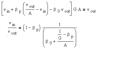

Jan;
Setting your positive feedback to 1/G is still begging the question. I believe keeping the positive feedback separately labeled prevents premature cancellation.
The following reduces to your "ideal" relation when Beta_p = 1/G but clearly shows what occurs where that identity is inexact:
A is now seen to have the normal role in negative feedback error reduction
It is physically impossible for Beta_p to equal 1/G over all frequencies as any real amplifier G must ultimately be low pass, requiring Beta_p to become an ideal differentiator at high frequencies. This doesn't preclude the equality being approximately met at low frequencies and for the circuit to have extremely high loop gain at these low frequencies.
