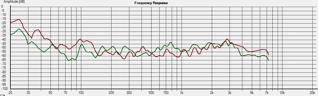

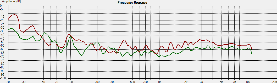

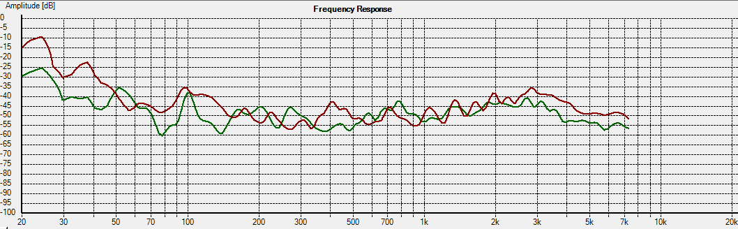

I've attached harmonic distortion plots of this design and my Griffin mini-monitors which also use the Aurum Cantus ribbon but with the smaller JX92 unit. Crossover point on the mini monitors is 3000Hz vs around 3500Hz on the larger JX150ng design. Both were made without mic calibration but using the same set up and show frequency response curves tracking each other very closely.
The JX150ng distortion, shown in green on the attached, appears to hold up very well against the JX92 with only marginally higher 3rd harmonic and much lower 2nd harmonic. Not bad, given the high X-over point, possibly endorsement for the design of the larger unit's cone profile.
Given that the tweeters are identical the much lower THD above 2500Hz in the JX150ng design was unexpected but I wonder if this might be due to the steeper JX150ng X-over roll-off and correspondingly less overlap and/or the much smaller baffle width of 4.5" in the JX150ng design vs 7" on the mini monitors.
Attachments - THD, 2nd harm. 3rd harm.

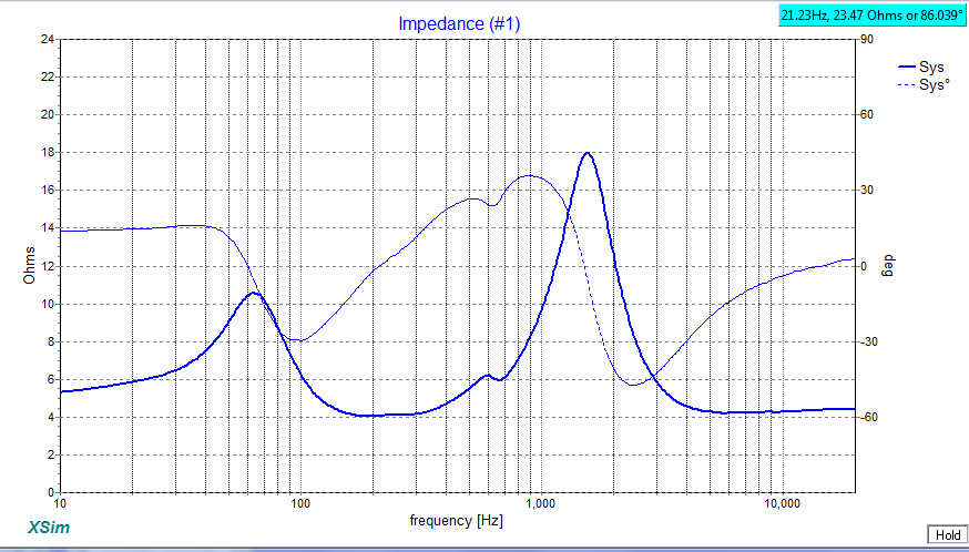

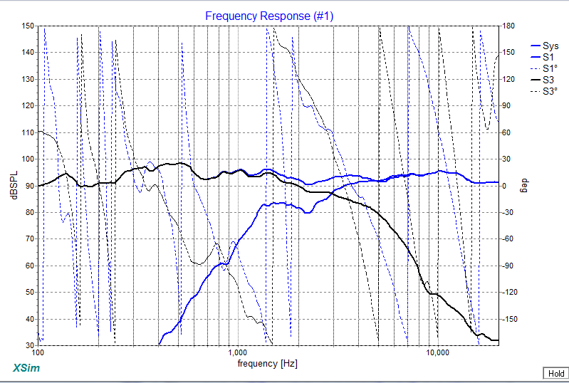

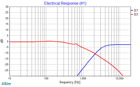

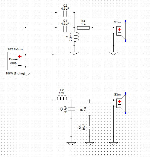

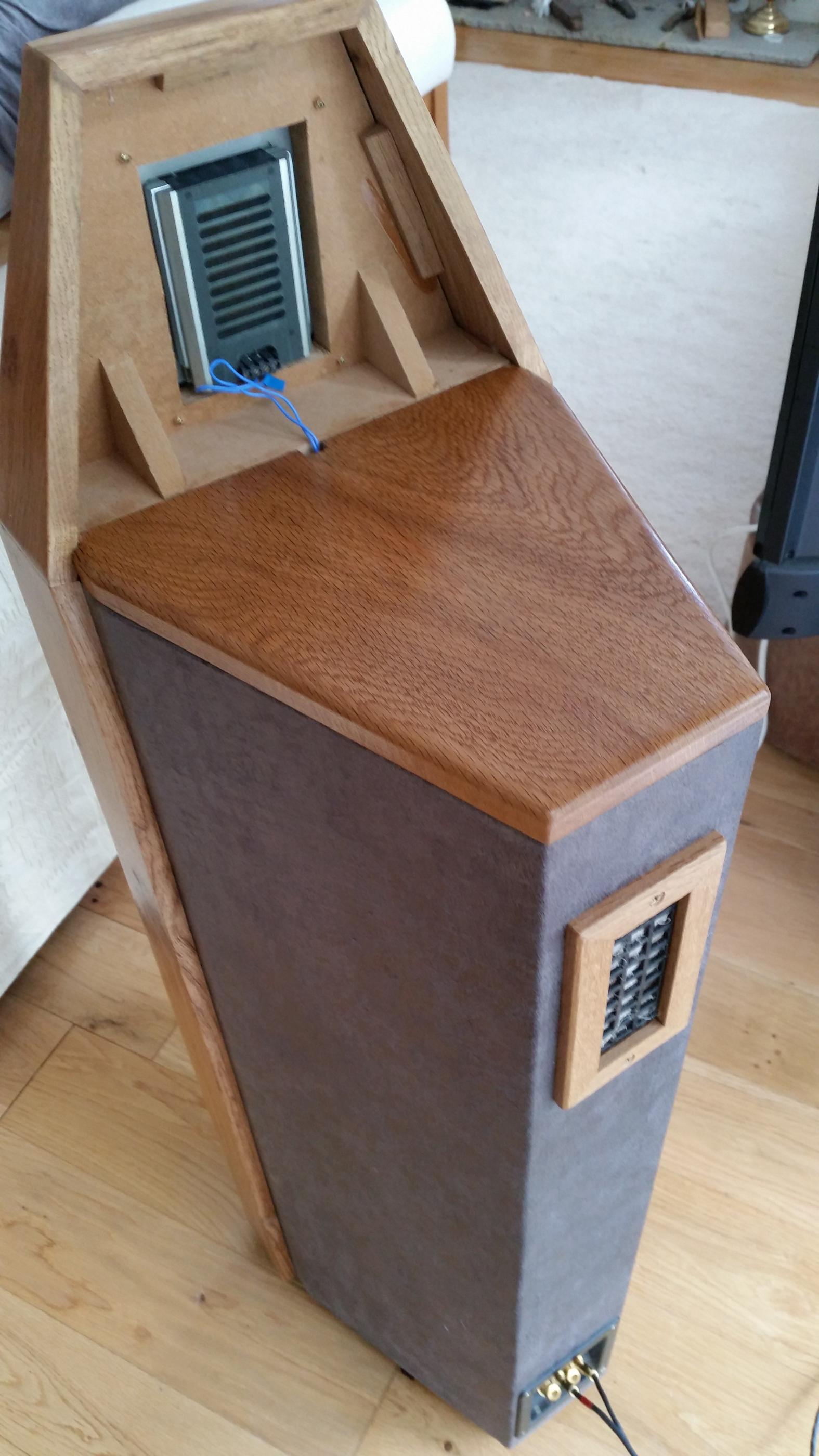

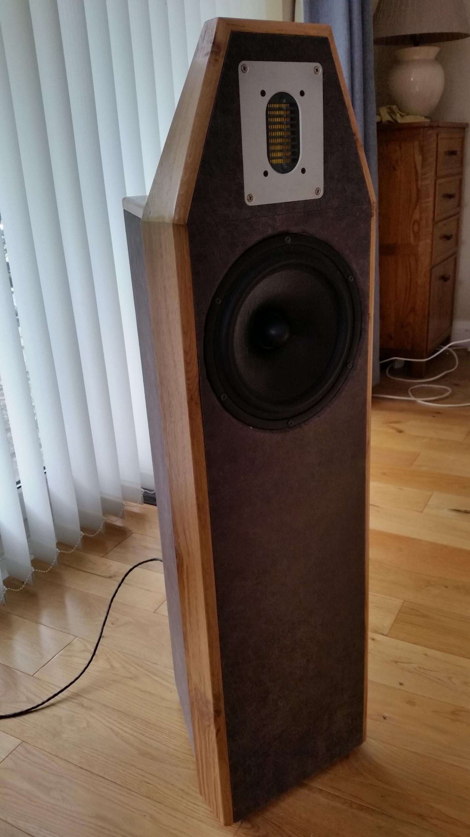

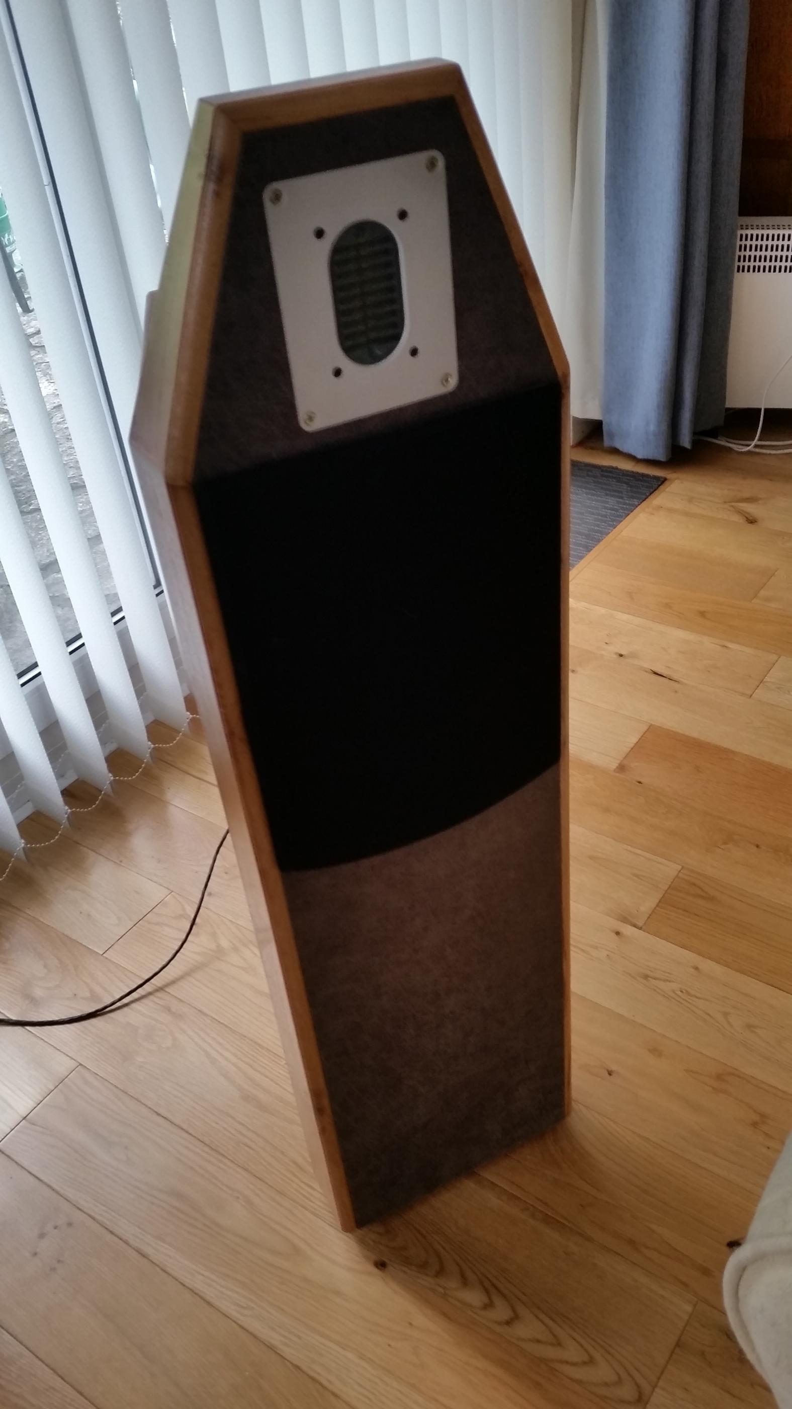

I have reworked these. Drive units are now Seas U22 (early 4 ohm version) with aperiodic vent
and Mundorf AMD 2430 on an open baffle. There remain a few cosmetic jobs to be done such as a trim around the recessed Seas woofer which has a smaller chassis than the Jordan it replaces, and rear tweeter grille.
The aim with the vent is to allow as much sound as possible (within reason) to escape from the enclosure to match the rear radiation of the AMT tweeter and to that end the path directly between the driver and the vent is clear of box stuffing.

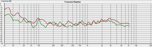

I have attached a few graphs etc. The response below around 500Hz is probably not accurate and is likely due to measurement conditions. In any case there are separate subwoofers in the room to fill out the bass.
Soundwise, there's an addictive sense of space and perspective. Treble is silky smooth, extremely open and clean and the Seas U22 seems very neutral too with clean midrange. Its revealing to damp the rear tweeter response with cushions placed behind, this results in a darker top end with reduced sense of space, so they are certainly staying open.

'Might sound even better with stuffing in the cabinet and with the back off.'
Yes, that's a thought, though I think I'm already pushing the limits using minimal aperiodic loading of these particularly low Qts woofers. They're around 0.23 so I consider it fortunate that I have the bass that I have.
