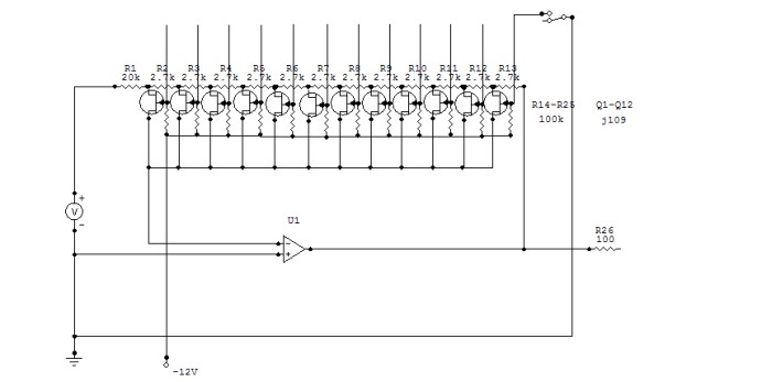

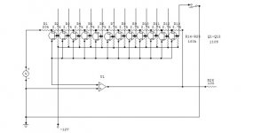

Hi all,
what do you think of this? I haven't seen this topology anywhere. Am I missing something or is this a great way to overcome limitations of JFET switches:
- no current actually passes the JFET. It is just used as a switch passing voltage to the inverting op amp input - the inv input being essentially a voltage sensor anyway and not a load
- R(DS) should therefore remain constant
- any minor variations in R(DS) will be insubstantial compared to the input impedance of the op amp.
Potential for problems would be
- nonlinearity for bipolar voltages - however at virtual ground there won't even ever be any V(DS) *or* I(DS)
- leakage of control voltage of the JFET - however, again, at virtual ground on one end and "infinite" input impedance on the other that shouldn't be a problem.
Have a found the elusive non-distorting JFET switch application?

Nonlinearity would be my concern too. Isn't that the basic problem with commercial analog switches?
Also be aware that the drain-source capacitance of FET's goes way up when there's no DC voltage on them.

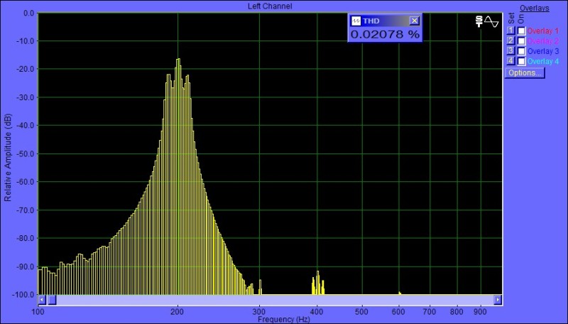

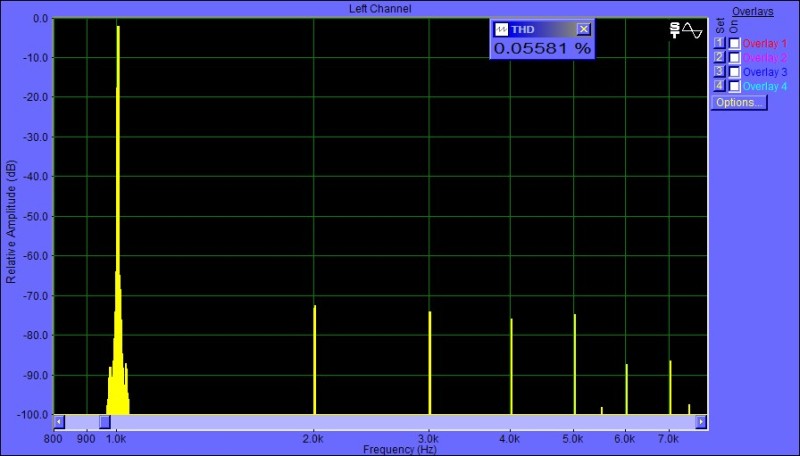

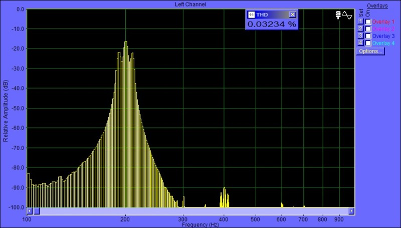

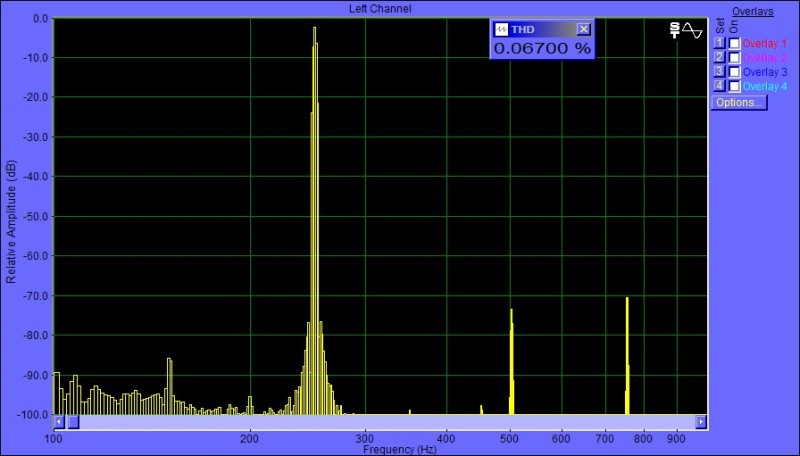

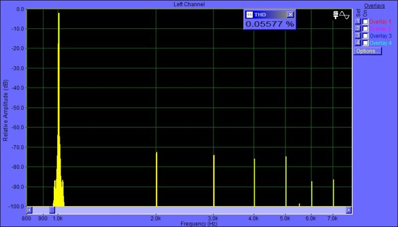

actually I've tried it
... with 2 stages (not the full R ladder), one JFET "on", the other "off", and a TL072. Didn't listen, but did distortion tests. My soundcard is not the greatest I'm afraid, but at least I see no difference between just resistors, and resistors plus the switch. Photos of distortion spectra below. The source was test CD's with either sine waves (250 and 1000 Hz) or a 200 Hz sine wave modulated tone burst (Linkwitz test CD). The sine measurements show distortion which is equal to the passive R setup and the JFET setup; this may have come from the source recording or another limiting factor. The burst spectra are cleaner. The noise floor especially below 200 Hz mocks things up a little. Regardless - I see no difference at this stage and with this equipment, between passive resistor divider on the inv input, or a JFET switch.

The point of my design however, if my assumptions are correct, is that it truly removes the switch from the signal path. In my circuit, the JFET simply switches the (-)input of the op amp "into" the various positions of the voltage dividers formed by the resistor array, the same way as a pot wiper would. The (-) input with its practically infinite input impedance solely acts as a voltage sensor. If you use a FET input op amp, the JFET switch at the (-) input never passes any current, unlike in all other topologies I have seen, where the JFET is usually placed in either the input signal path, or the feedback path, with op amp virtual ground on one end. These topologies leave open questions as to JFET nonlinearities dependent on signal voltage and current.
My topology just uses the JFET as a one way extension of the op amp input. It allows the (-) input to sense the voltage at various positions of a passive resistor array that passes the signal. Therefore it *should* (and this is my unanswered open question) be immune to most (all?) nonlinearities of the JFET switch.

Err... yes, I admit in my enthusiasm I breadboarded it and *measured* it rather than *listening*... before the FFT software expires its demo status... Won't get around to do a listenable full stereo prototype before next week.
