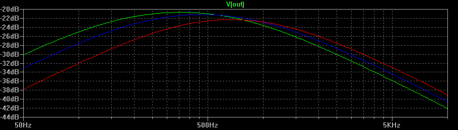

I also simulated one of the preamps mentioned in the begining of the thread; the Runoffgroove Cabsim. This is typical cabsim and I think that it shouldn't be used as a preamp (especially that it has gain < 1). Attached is frequency response of the cabsim.
Mark

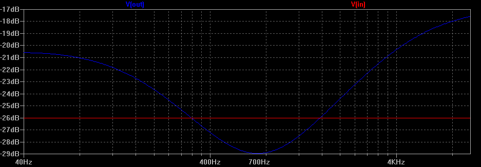

I simulated the preamp. Attached is the frequency plot of the preamp. Looks good but I'm worried about two issues; the gain changes with the frequency and it's x1.8 at low frequencies and x2.5 (and not x6.5 as mentioned in one of previous posts), and other issue it that it's quite difficult to buy J201 (with other transistors I get much lower gain).
But still it looks interesting.
Mark

The surface mount JFET I used in the circuit shown in my picture was actually a surplus Interfet device that is similar in specification to the Interfet SMP4867. There are certainly other JFETs you could use but remember, if you plan on using a JFET as an amplifier in an "on-board" circuit with a 9.0 Volt battery, there are definite limitations to power-draw and headroom.
I have said many times that the J201 is not a "magic" device, other devices that can be used are the Toshiba 2SK170 and the 2N5457 (provided that the devices chosen are on the "low-end" of thier specification scale). However, to function properly in the self-bias "Hugsley" circuit described in my previous postings, the 2SK170 and 2N5457 may have to be "screend" for an optimal fit.
If you have other JFETs you would like to try then, by all means, feel free to try them (preferably ones with characteristics similar to the J201). If you bias them up in thier optimal linear region as described in my previous postings, then I'm pretty sure you will have a viable circuit.
I hope this helps,
JP Hugsley
Thanks for the answer. At the moment I'm only simulating the preamp in Spice. And when I change J201 to other FETs, gain drops down - the transistor is definitely incorrectly biased.
BTW, I'm looking for similar preamp for bass guitar. You mentioned that it is based on Fender. Which Fender model did you mean, Bassman 135? It seems that for bass guitar you need different components. Especially that the Mid frequency minimum is at much lower frequency. With your preamp the minimum is at 700Hz and with Fender it's below 400Hz. Do you have a set of components for bass guitar? Or you advise me to use just the components from Bassman 135?
Mark

Hi Mark,
The EQ used in the Hugsley preamp is a generic topology that Fender used for many of thier early tube designs. This topology was "standard" on many of the RCA Tube Manual public domain schematics for preamplfiers in the fifties and sixties.
The values I used for the Hugsley preamp were scaled to more-or-less 1/2 the resistance values and 2 times the capacitor values of some of the "classic" Fender designs; e.g. the Bassman, Bandmaster and Deluxe Reverb (this was done because the drain resistor of the J201 was roughly 1/2 the value of the standard Fender 12AX7 plate resistor).
If you have Spice, I suggest that you simulate the EQ's that you actually like and then use the resistance and capacitance values based on thoses simulations. After that, construct the EQ's and spend some time listening to the different "tonal" configurations.
The best advice I can give you is to listen and re-configure the EQ's until you converge on a set of values you like best.
Remeber, in the design of guitar preamps (including bass guitars), the Spice simulations are an excellent tool to help you in the development of a design but, ultimately, it's your ears that will have the final say.
