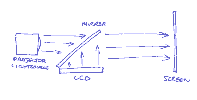

right, attached below is a diagram of wha ti believe you're trying to do
if it is wrong, then i apologise for my earlier comments. if it is correct, then I stand by the fact that is simply will not work. ever
well if you won't take my word for it, think about this
replace the LCD in the above diagram with a blue light with a circular template (ie to project a blue circle)
if you project a blue circle onto the mirror, then shine a white light thru as per the diagram, you will NOT get a blue circle on the screen
you'll get ONLY the white light from the projector, whilst on the mirror you'll see the image if the blue circle
you see what i'm getting at? it's absolutely impossible
the HUD glass won't help either. it simply will not work.
and might i add, i this idea DID work it would have been explored already by the people who invent projectors etc. the reason it hasn't is because it simply can't work
