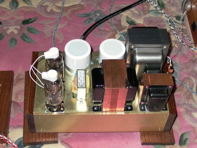

I did this project not too long ago, the idea is separate the out-put tube (805) and the out-put transformers in 3 cabinets for stereo . key point is shorten the speaker's cable , I can put the out-put transformer unit close to the speakers and use very short wires for connection, but the cable for connecting the out-put tube and the out-put transformer unit has to be long enough for your set-up,and this cable is driving in 800 dcv and 120ma , no need thick wire, only make sure for safety .
this amp is all DHT (#26 WE300B RCA805) in transformer coupling with no feedback, all silver include all transformers in sound path, each tube has it's own power supply.
result ? perfect , even I only use the small bookshelf place in floor for test, sound stage is open behind and up in the air

pot a transformer cost too much money , also come up with material issue ,noise problem for a power amp mainly is hum, although the out-put transformer is set with the power supply, but it is step down trans, so no noise there, cooper strip mainly for cosmetic, 800v and over 200 ma will ring the choke in power supply, 120 ma is OK, separate power supply from the amp will erase all noise problems,

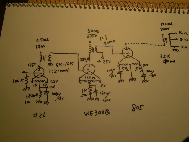

the picture show the amp's schematic I hope you can read and understand, I don't know how to use computer to draw, my computer knowledge's level is very low
the circuit is quit simple, most diyers can handle I believe , only 800v high voltage will be a little bite too high to someone. the 805 tube is working in positive bias, so it sound different compare to those negative bias amp (300B 211 845 etc,) they sound like a bucket of water with holes in the bottom, water flow out just by nature, but positive bias amp sound like water come out by pressure just like jet, make image to have real body feeling and close to the real sound, if you want to try this taste and you are not a diyer, you can buy one from WAVAC, but the price !!!!

Fax bias is good but for negative bias needs protection, once fail will damage the tube, self bias is doing protection, but in positive bias when it fail there will be less current, the tube is save, one thing , in interstage transformer, both dc currents has to be in opposite direction

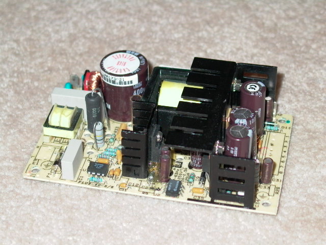

there are 4 power supplys per channel, I use 5dcv 6A power pad x8(picture) for all the tube's filarment ( not the rectifier) it only cost 10$ each form computer surplus, cheapper than make by ourself, 2 for 805 in 10v, 1 for 5v 300B another one for #26 reduce to 1.5v with resistor.I put all this in a metal case, a lot of heat need ventilation, power transformer all from Hammond #728 for 805 , 273X for 300B 270CX for #26 and rectifier 3B25, 3B28 or 866A for 800v 5V4G for 300B 6cA4 for #26, another transformer 166S2 for 3B25 or 866A's heater, circuit is very simple with choke in put and filter with caps choke 193G for 805 193C for 300B 155J for #26. after rectified the voltage will higher than what we want, I use a power adjustable resistor to check and work out how much to reduce, the only thing has to be care is to find a safety connector and cable for HV, there are threads talking about in here,I am using Neutrik Powercon for the job, it is for AC (250v 20A) use not rate in HV, but as long as no pull out with power on, it will be safe cable I use Taflon hook up wire to braid for it, because Teflon can last higher temperature it rate only 600v but two wires togetter means 1200v, so far no spark happen, just make sure power off and dischage( HV off filament on for a while) all the caps for off or connecting cable, anyway so far so good no problems, allway pay attention to HV with care, this days not too good for DIYER because ElectroSonic Canada close down the warehouse no more pick up only by mail, will take longer for a new project

It's a terrible design, running HV cables and low-level drive signals several meters toward the speakers. There are many good reasons why manufacturers and most DIY'ers don't do this. Too bad, it looks like a nice design otherwise.
Thank you for the reply, I know there will a lot of argueing for this idea. manufacturers of cause won't do this too cost more cabinets and more parts, but why speaker cables can have so many different sound qualitys, and poeple will pay high price more than a amp just for a cable, I guess to drive high current for signal has a lot of factors, in power plant they send out power in high voltage and reduce in the other ends for less loose, that is my idea came from. if you don't try you never know, and this amp is not suitable for everyone especially with small kids and pets in home but result came out supper compare to the conventional one, maybe not all system can notice the different but the hi end system must can
