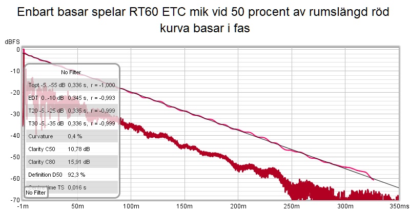

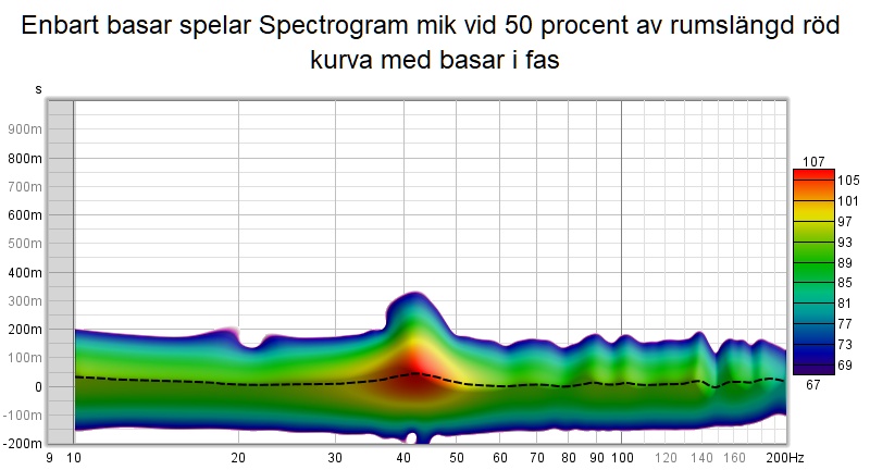

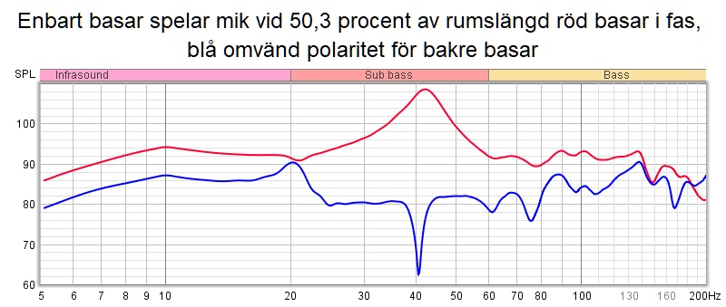

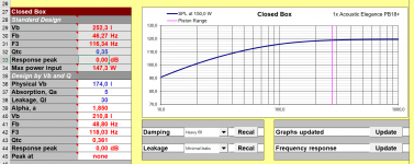

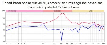

For my concrete bunker and DIY-subs I used Qtc of about 0,36, tuned to around 48 Hz and starting to fall off with F3 as high as 118 Hz. It turned out quite well. The SPL is fine all the way down to 10 Hz. See enclosed pictures. A normal / high Qtc for the subs would have made the bass modes and their ringing much harder to control with reasonable bass traps.
The diagram with the red and blue curve, have no smoothing, no EQ and no time delay applied, with subs at front wall and rear wall. (Yes, I know the curves look smoothed but they aren’t.) Microphone is placed in the vey middle of the room, where one has a minimum SPL of lowest room mode and a peak for 2nd length mode. Red curve is with subs at front wall playing in phase with subs at the rear wall. Blue is with subs at the rear wall playing with opposite polarity versus front subs (180 degree out of phase). Notice the SPL at 120 Hz is 91 dB and at 20 Hz it is also 91 dB. Not 20 dB down to 71 dB or so, as from the simulation. The substantial room gain in the concrete bunker is the cause for the same value at both 120 and 20 Hz. A few Hz below lowest room mode frequency, the pressure gain starts to show up and SPL rises to 96 dB at 10 Hz. Higher than both at 20 and 120 Hz. It is actually about 103 dB if one is to trust the calibration file for my UMIK 1. At 10 Hz it shows 7,4 dB too low value. Under 10 Hz there is a filter in the electronics so the SPL starts to fall again.
The red curve shows a huge peak for 2nd room mode around 42 Hz with all subs in phase, and a deep dip for the blue curve when subs have opposite polarity. If the rear subs had been time delayed, it would be more or less flat at around 40 Hz. The peak can easily be EQ:ed down so it is less noticeable. Actually it is not very noticeable even without any EQ. At around 40 Hz it takes only about 0,34 seconds to drop 40 dB as can be seen in the Spectrogram, so the peak doesn’t linger on for eternity. The rest of the bass has even lower decay rate. The same figure 0,34 seconds shows up in the ETC for a 60 dB decay with a more or less a straight line for the Schroeder integral curve.
Conclusion: A strong room and pressure gain can be used to your advantage, -no beefy power amps for mega bucks may be needed when aiming for high SPLs in the very low bass. (In the diagrams less than 1 W / channel goes out from the amp if I remember correctly.) It can also turn out disastrous with a too boomy bass which is impossible to “cure” with any normal bass traps if one doesn’t take it into consideration beforehand. )
