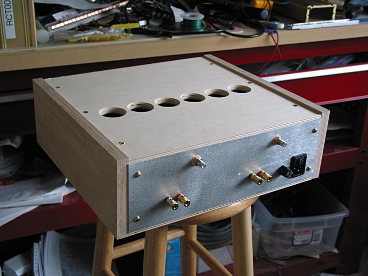

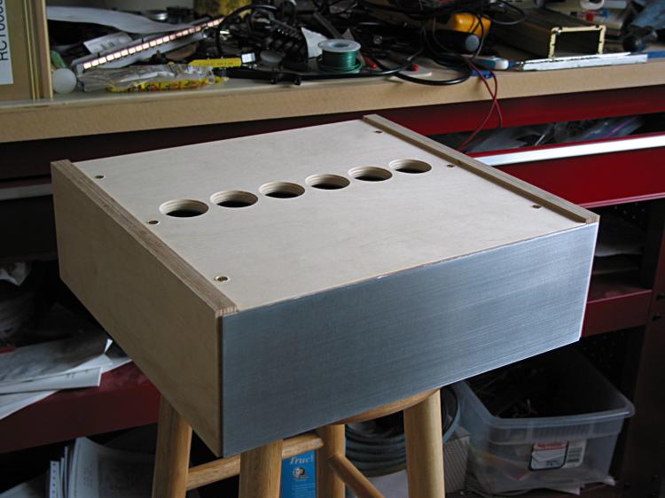

Thank you very much. I'm very pleased with the way it turned out. It's inspired by an old Audio Research pre-amp, I think, that I saw in a recent Absolute Sound.

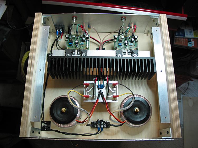

Nice work, Ultrachrome! Thanks for posting pics; very elegant layout, with due regard for good wiring practice, particularly the short input leads to each module and the use of the heatsink as shield between AC supply and amp modules.

Raka, the kit is from Australia, and includes heatsink, power supply pcb, caps, and fast diodes. It does not include toroids, however, which are VERY heavy and normally available locally.
The circuit is a highly refined, tweaked classic, specifically voiced for large orchestral music where layering and TIM are traditionally the biggest issues.

Nice shot of the inside, it's seen very well the grounding of the amp. I like it.

I am building my AKSA also. In a few days I will post some pictures also. How did you support the heatsing to the chassis?

To support the heatsink I made standoffs out of 1/2" square aluminum specifically so the fins would be close to the holes in the lid. This was strictly for asthetics.
I then drilled holes in the shelf and ran a 10-24 brass screw into the aluminum standoff. I'll post a better picture tomorrow evening.
Thanks all for your kind words. I'm very pleased with how it turned out. I think the amp sounds absolutely fantastic. I'm currently using a Bottlehead Foreplay preamp.

Out of curosity, did you notice a difference in sound when you put the AKSA in the box?
I ran my AKSA of six months in a frame and thought it sounded different when I finally mounted it in a proper case. (or was it just my imagination???)
