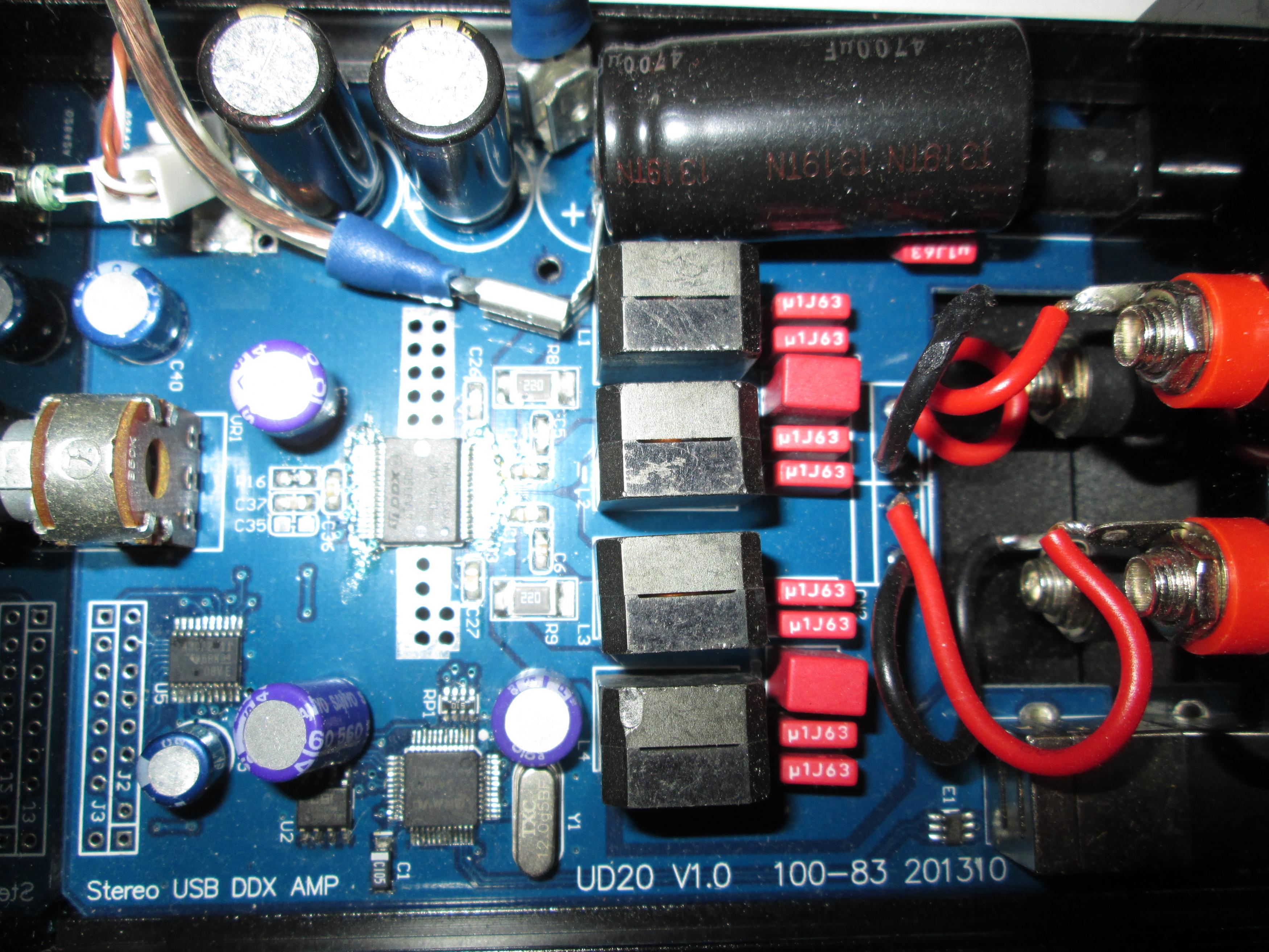

sigh ...
"This is quite different from how a regular class D or T amplifier with digital inputs works - they include a DAC which first convert the digital signal to analog which is then passed on to the amplifier section where it is converted back to PWM. The fully digital technology avoid these extra steps of D/A and A/D conversion."
STA335BW
Features
■ Wide supply voltage range (5 to 24V)
■ 4 Power Output Configurations
– 2 channels of ternary PWM (stereo mode)
(2 x 20 W @ 8 Ω, 18 V)
– 3 channels - left, right using binary and LFE
using ternary PWM (2.1 mode) (2x10W +
1x20 W @ 2 x 4 Ω, 1 x 8 Ω, 20 V)
– 1 channel PWM output (parallel-mode)
(1 x 40 W)
– 2 channels of ternary PWM (2 x 20 W) +
stereo lineout ternary
■ 2.1 Channels of 24-Bit DDX®
■ >94dB SNR and Dynamic Range
■ Selectable 32 KHz to 192 KHz Input Sample
Rates
■ I2C control with Selectable Device Address
■ Digital Gain/Attenuation +48 dB to -80 dB in
0.5 dB steps
■ Soft Volume Update
■ Individual Channel and Master
Gain/Attenuation
■ Dual Independent Limiters/Compressors
■ Dynamic Range Compression or Anti-Clipping
Modes
■ AutomodesTM
– 15 Preset Crossover filters
– 2 Preset Anti-Clipping Modes
– Preset Nighttime Listening Mode
■ Individual Channel and Master Soft and Hard
Mute
■ Independent Channel Volume and DSP
Bypass
■ Automatic Zero-Detect Mute
■ Automatic Invalid Input Detect Mute
■ 2-Channel I2S Input Data Interface
■ Input and Output Channel Mapping
■ 4 x 28-bit User Programmable Biquads (EQ)
per channel
■ Bass/Treble Tone Control
■ DC Blocking Selectable High-Pass Filter
■ Selectable De-emphasis
■ Sub Channel Mix into Left and Right Channels
■ Advanced AM Interference Frequency
Switching and Noise Suppression Modes
■ Selectable High or Low Bandwidth Noise
Shaping Topologies
■ Variable Max Power Correction for lower fullpower
THD
■ Selectable Clock Input Ratio
■ 96 KHz Internal Processing Sample Rate, 24 to
28-bit precision
■ Thermal Overload and Short-circuit Protection
embedded
■ Video Application: 576 x fs input mode
supporting
■ PSSO-36 Slug Down package.

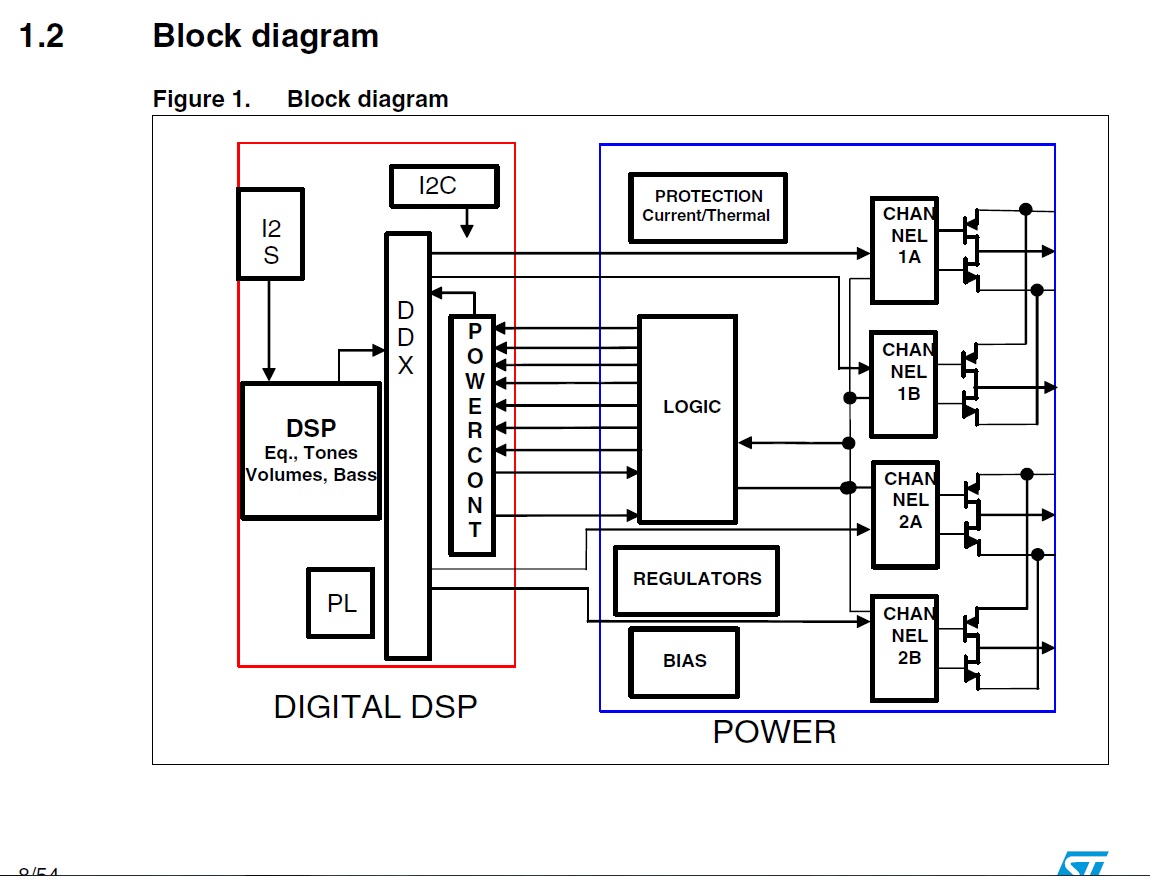

Description
The STA335BW is an integrated solution of digital audio processing, digital amplifier control, and DDX-Power Output Stage, thereby creating a high-power single-chip DDX® solution comprising of high-quality, high-efficiency, all digital amplification.
The STA335BW power section consists of four independent half-bridges. These can be configured via digital control to operate in different modes. 2.1 channels can be provided by two half-bridges and a single full-bridge, providing up to 2 x 14 W + 1 x 30 W of power output. Two channels can be provided by two full-bridges, providing up to 2 x 30 W of power. The IC can also be configured as a 2.1 channels with 2 x 30 W provided by the device and external power for DDX® power drive.
Also provided in the STA335BW are a full assortment of digital processing features. This includes up to four programmable 28-bit biquads (EQ) per channel, and bass/treble tone control. Automodes™ enable a time-to-market advantage by substantially reducing the amount of software development needed for certain functions. This includes Auto Volume loudness, preset volume curves and preset EQ settings. New advanced AM radio interference reduction modes. The serial audio data input interface accepts all possible formats, including the popular I2S format.
Three channels of DDX® processing are provided. This high quality conversion from PCM audio to DDX’s patented tri-state PWM switching waveform provides over 100 dB SNR and dynamic range."

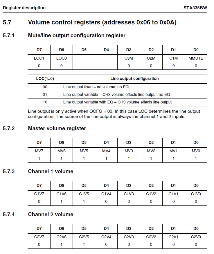

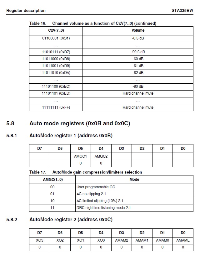

Here's the vol reg:
And you don't wanna know how many features this thing has ... 😱

You don't understand 😀
Had you left out that part I would have let this pass... But yes, I do understand your simplistic argument. You don't seem to understand that "digital" has many different definitions, depending on the context.
There is no such thing as an analog electrical signal to sample in the first place. All electrical signals are inherently digital because digital just means it's discrete values, or in other words that the smallest possible component is indivisible.
Yes. That means they are discrete. That might satisfy some definitions of digital, but not others, as the electrical signals still aren't represented as values encoded as combinations of bits. All depends on which definition, in which context, you choose to use.
