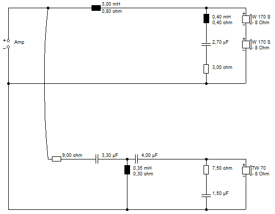

A couple of posts back I stated that I was going to do exactly that and use Steve's crossover. Steve mentioned "To series MTM them, double coil and resistor values on bass filter, halve the capacitors. Easy..."
My question is for the crossover diagram Steve presented, is that for a single driver? If yes what would be the difference or benefit of using parallel vs series connected drivers?

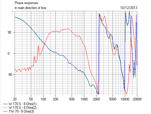

I've modelled the closed box MTM on 60cmX 20cm baffle here. Deep to suit 40L shared enclosure.
I did think that coil was on the big side. 1.5mH per driver might be better. We'll have to hope the bass does roughly the right thing. That bit is guesswork. 🙂
