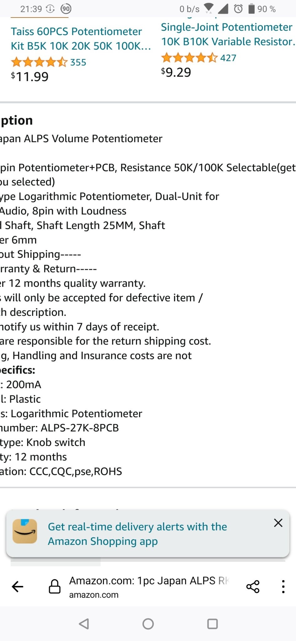

New here have Q: Alps 50/100k selectable - how to select?
Description from seller says " 50/100k selectable" , it means you have a choice to select 50k or 100k variant , by messaging to seller. If markings on potentiometer says 50k or 503 , it's 50k version. I very doubt if there's any need to make dual potentiometers with different resistances, for stereo you need matched .
The part number says 50k, and brand says generic. Just return it and get the genuine Alps 100k,
which costs more than the $5. generic pot. Also, Alps does not make the RK27 with a knurled shaft.

You may be able to use it anyway, if the 50k value works in your circuit, and if the unknown quality is ok.
This screenshot was made after clicking link from post #1 , scroll down till Description .There's clearly seen word selectable , which explains why op got not what expected .With "ad" you mean shopify app banner at bottom of screenshot ,or something else ?
