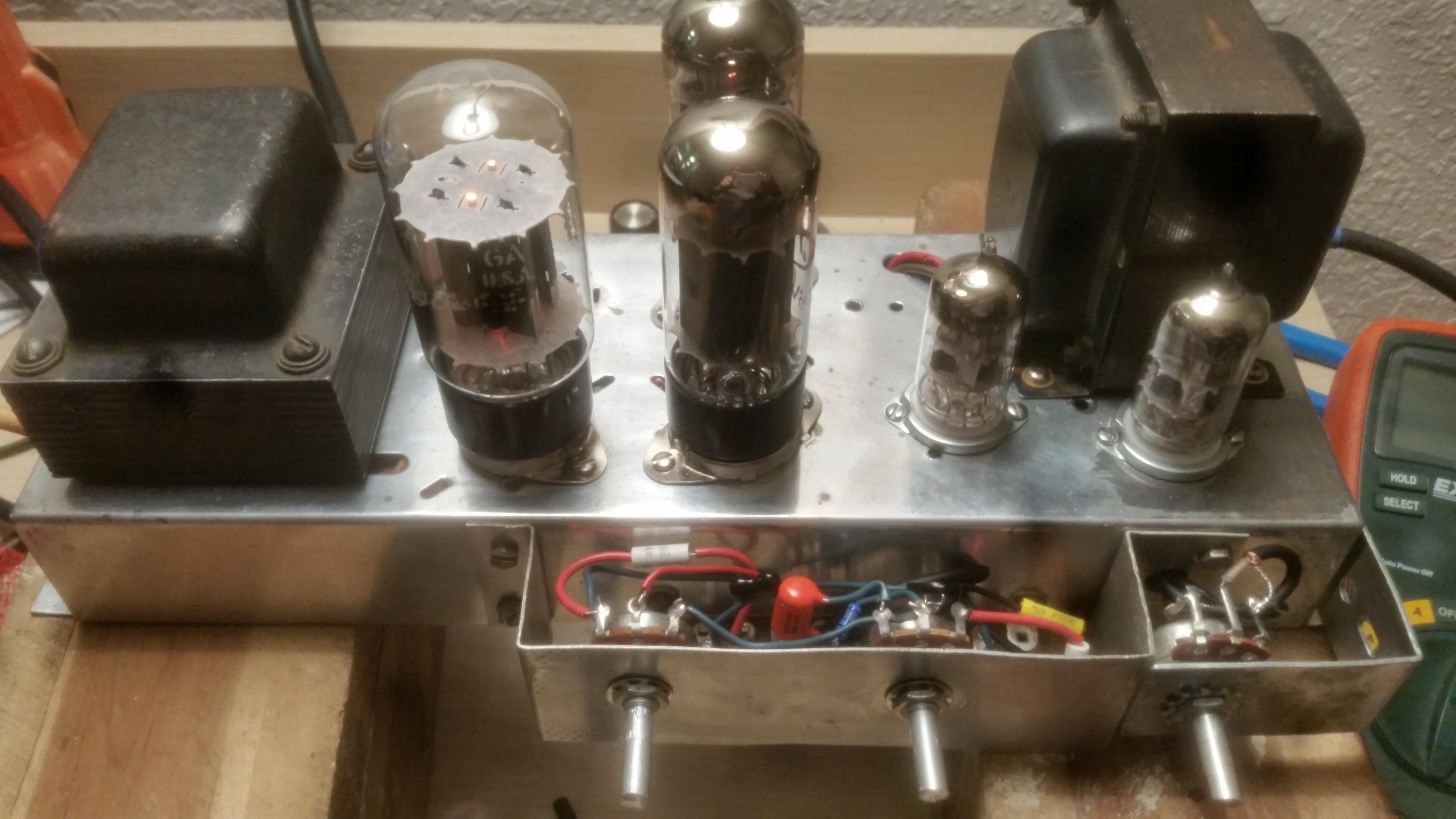

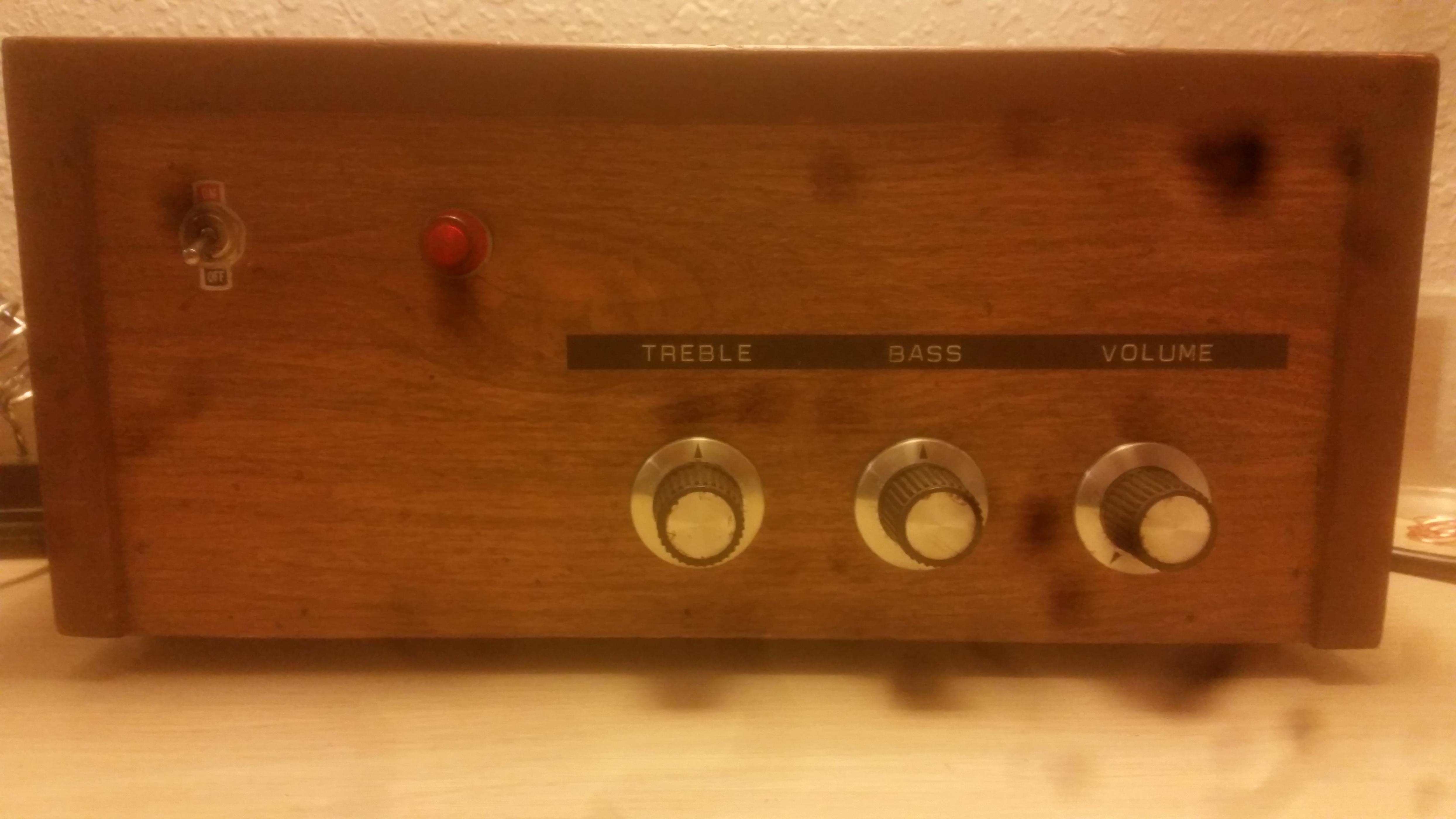

I picked up this old phono amp and rebuilt it to a modified Deluxe 5e3 with Judge Roy Bean tone stack.

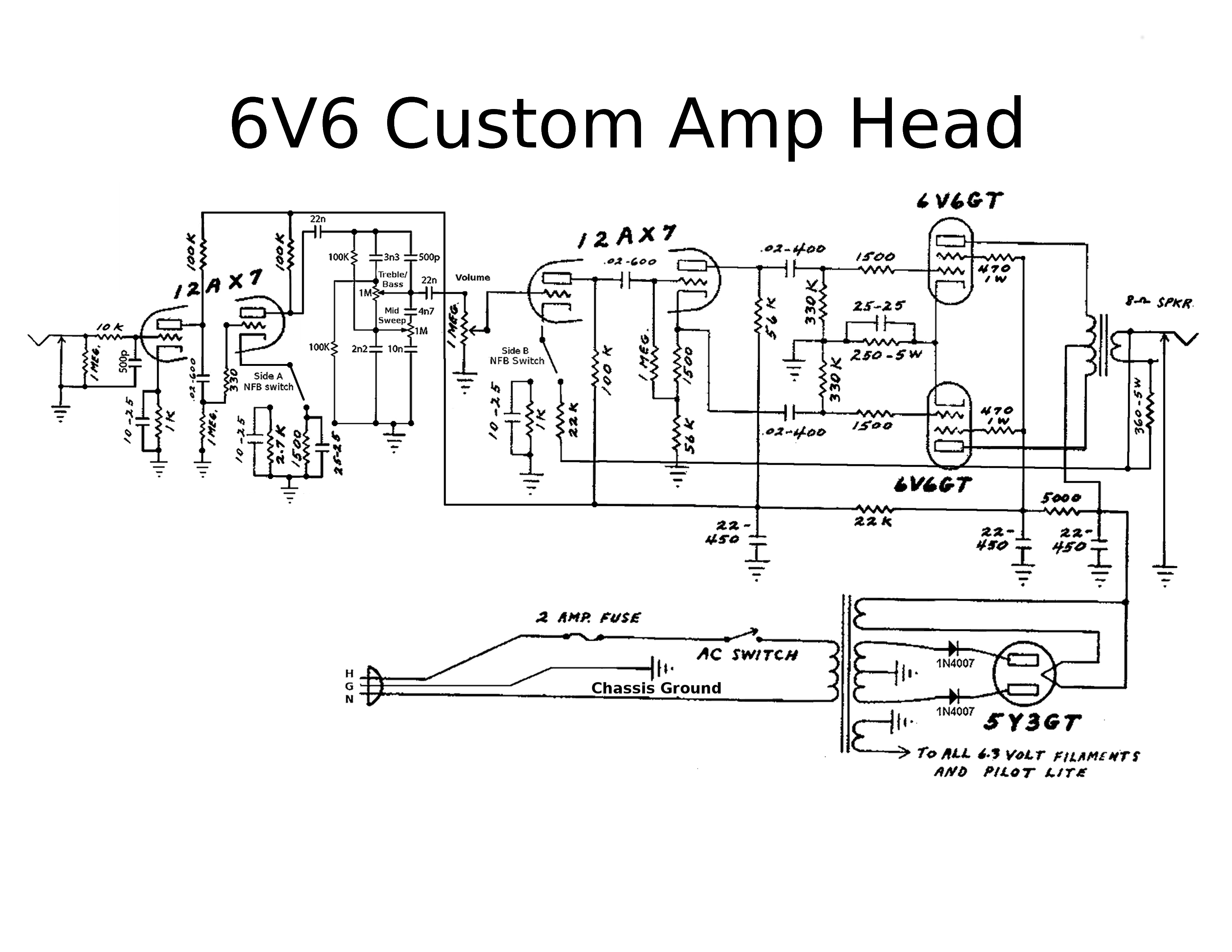

This is my first scratch build, I modified the schematic and built the circuit from that. It sounds ok but there's something funky about the dirty side. It sounds ok if you keep the volume way down but it gets quite a bit louder and produces squealing sounds as you turn it up. The clean side is pretty nice but not real clean. It sounds better with a 5v4 rectifier.
Is there anything obviously whacked in the schematic?

How do you get any clean sounds at all with the volume pot after two cascaded 12AX7s? Normally the volume (gain) pot is placed between first gain stage and the second, so the second isn't overdriven at all times.

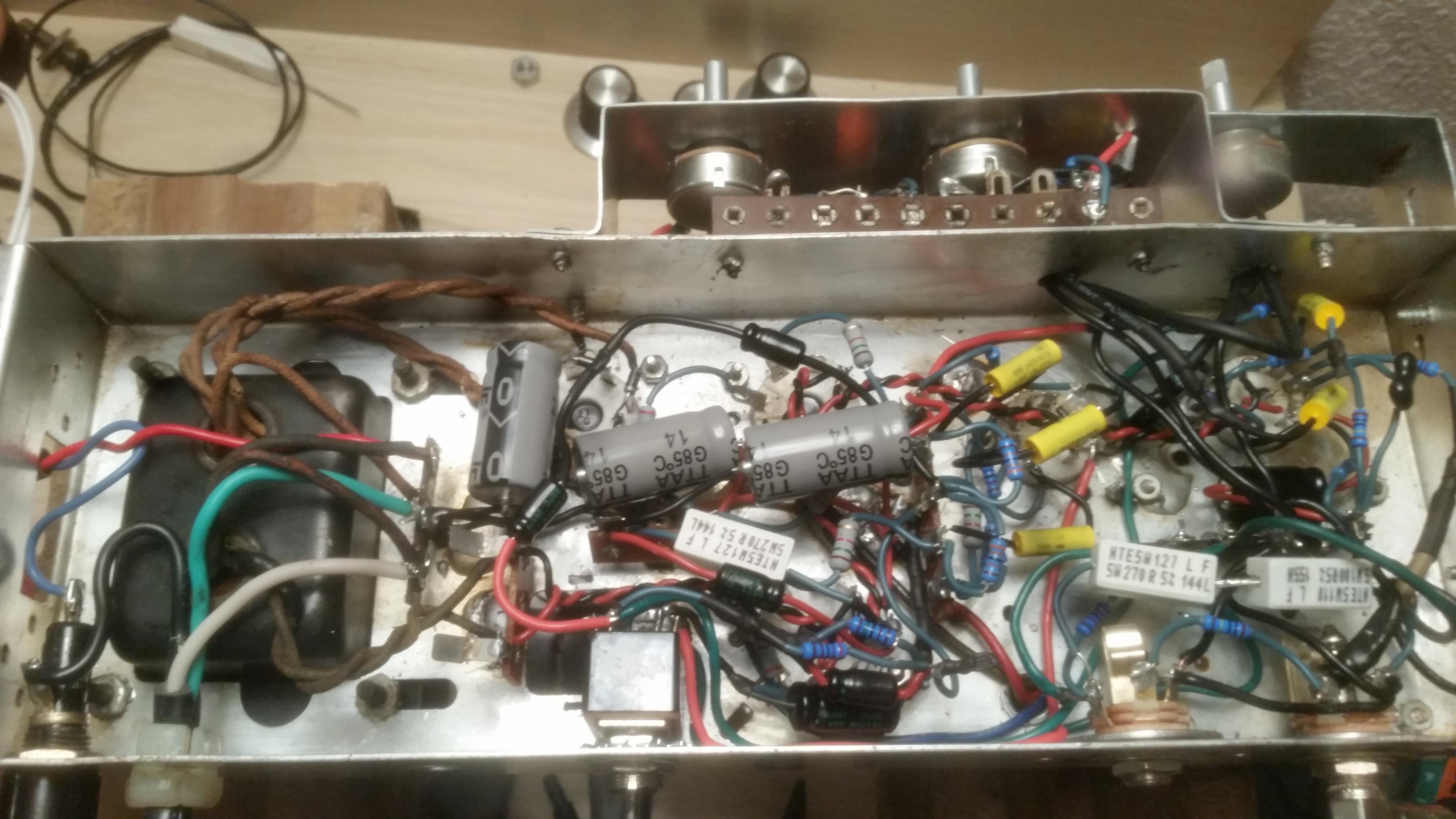

Impossible to see how your wiring is laid out. The signal - return, as well as the b+ with return, is critical with high gain ckts.

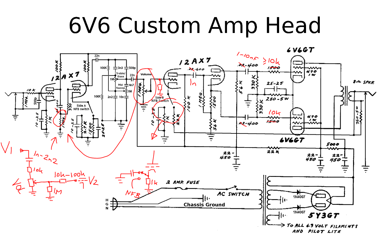

Other than that I'd lower the signal cap values a bit. See attached for some suggestions. I've also experienced that no matter how fine the layout, when the volume (or 'gain') pot is maxed out, the amps will often squeel like mad pigs. A 10kohm resistor right before the pot fixes that.
Grid stopper is very important to have right at the socket as close as possible to the grid.
That phase inverter is very good but does not like to be loaded heavily, which it is when over driving the output. Lower value caps and larger grid stopper helps. Even up to 100kohms can be used on the grids of 6V6s.
Edit: the selector switch for feedback or no feedback dosnt look right, see my scetching.
The two diodes at the plate of the 5Y3 are absolutely unnecessary. You can remove them.
Actually they are good insurance against hot arcing during transient conditions, inadvertent power cycling, etc., and do no harm. They are absolutely mandatory with modern production 5AR4. They should not be necessary with NOS 5Y3 but can't hurt and will permit the substitution of a 5AR4 for less sag if desired.
I use them wherever 5AR4 are employed in my designs.

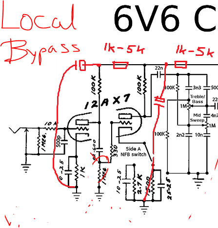

To prevent motor-boating it'd be enuff with a cap value of a few uF, but since you have 1kohm in series with the b+ you can create a LP-filter to kill some rectifier ripple as well. 22uF is a decent value. So 10uF - 47uF depending on what you have laying around.
Many purists don't like too high cap values since they feel it kills some responsiveness. I havent been able to detect that so I just use a reasonable value I have at hand.
Oh try to elevate the heater to a voltage between 10-80V. You can always settle with grounding the heater, but there will be some heater AC creeping into the cathodes and with high gain as in this case it may be objectionable. Tying one end of the heater wiring to the 6V6 cathode is a nice try. (When the heater is at a potential higher than the cathodes of the sensitive preamp tubes, no electrons will flow from the heater to the cathodes, eliminating hum from the heaters).
