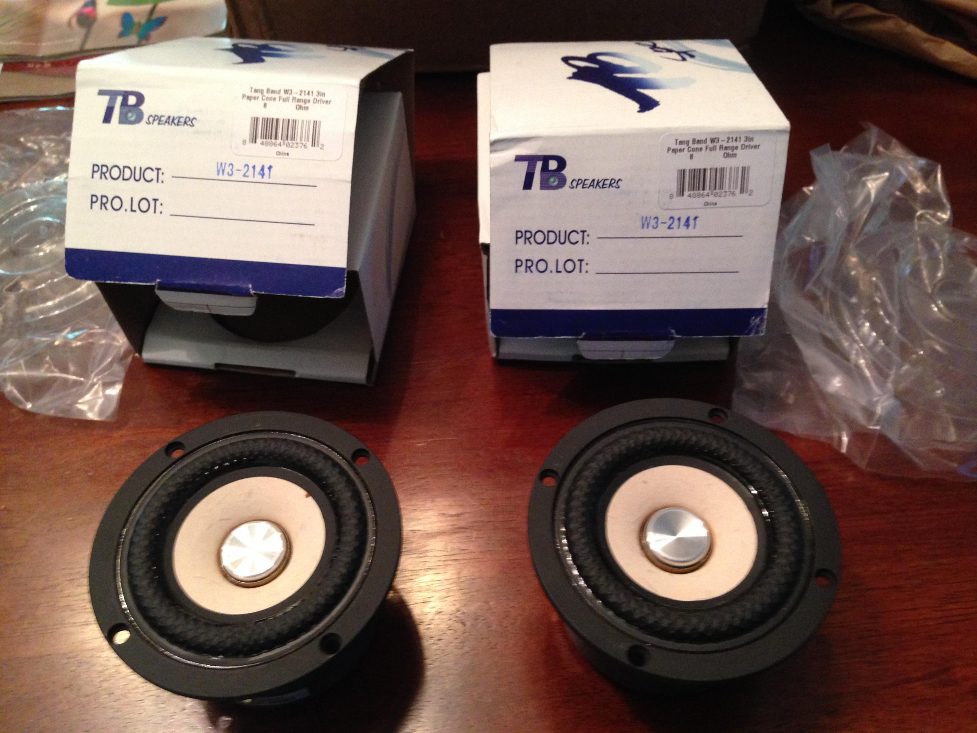

W3-2141's are here courtesy of Parts Express. My first impression is that they are very well made and heavy too! I will be getting started with the modified TABAQ build, as soon as, I get the finishing touchs put on the TABAQ's I built for my Grand Daughter. They just need the paint touched up and final assembly, so 95% done Ha Ha! More to come on the build with these new drivers.
Mac🙂
Mac🙂
Mac🙂
Look forward to following your build...Those drivers are aesthetically pleasing to.
