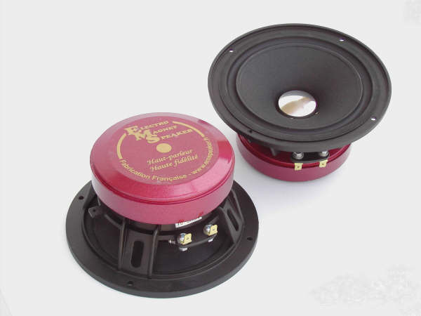

emspeaker LB7-
Free shipping to continental US -until oct. 31st.2008
Emspeaker has just introduced a new full range driver the: Emspeaker LB7 - a 7inch - full range driver (40hz-18khz)
-high efficient-low qts = fast driver.
Can be used in a TL cabinet:
Here are the specs:
-Z at 440Hz: 15ohms
-FR: 40Hz
-Qms: 3,770
-Qes: 0,228
-Qts: 0,215
-Mms: 7gr
-Vas: 56L
-BL: 9,66
-Eff: 94,1dB
-Xmax: 3mm
-Acc.factor: 1380
-frequency response: Fx to 18000Hz

I like the specs, but with a Qt of about 0.215 & a mass corner of ~350Hz, I'm not sure a TL would be such a good idea TBH if you want to get some bass out of them. Plenty of other options open though of course & you could always Eq them via whatever means you like to allow you to use them in other cab. types.
Ahhh, just saw this...no whizzer cone 🙂

Yes, I've noticed that also , no whizzer and 18khz.

No whizzer but the aluminum dust cap looks to be coupled to the coil so it acts like a pseudo tweeter.
