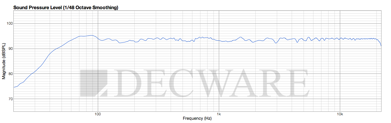

Here's the Decware published graph (still "controversial" until proven right or wrong).
I don't see any evidence of the big peaks, valleys and suck-outs alluded to in a previous post. Are we looking at the same graphs?
BTW, the system -3dB point is at about 45Hz....... it DOES reach 38Hz but at -6dB
This curve is quite similar to what an acoustic suspension (sealed cabinet) system would give if the Fb is at 45Hz with a Qb of about 0.7
On paper it would seem "bass-shy" but not so much if you look at how it interacts with an average room, where this type of curve can be quite favorable.
If the "average room" usual main bass mode is in the 40 to 45Hz range, this speaker may well play above the reference level at 40Hz and even have useful bass in the low 30's or even high 20's... so no, I don't think bass-shy would be a likely description.
Only drawback that I see to this system is that with an Xmax of 5mm this driver is likely to start modulating heavily at anything over about 2 watts... I doubt it'll still sound as clean when pushed hard. I don't think that resonator will do much to keep the driver from hitting peak excursions easily at its fundamental resonance. i.e. the driver is behaving as if in free air at 70Hz. My bet is under 100dB peaks before excursion limitations become audible.
Not enough volume for the "Loudiophile" contingent (myself included). I'd think a sub would be a good idea to help out in the low bass, for sure.

Jack Caldwell;2530222) said:I don't see any evidence of the big peaks, valleys and suck-outs alluded to in a previous post. Are we looking at the same graphs.
Guess I should have posted a link. I was referring to the 20-200hz graph posted on the main Zen OB page. Although its a graph of the fostex loaded OB, logic says the same anomolies will occur with the FRX driver.
Guess I should have posted a link. I was referring to the 20-200hz graph posted on the main Zen OB page.\

I love the look of that frequency response graph
Ruler flat from 45 Hz to 20 KHz at 98 dB? Throw a 16 to 60 Hz tapped horn with that puppy and my journey is over.
However, I also am quite aware that the "last speaker you'll ever buy" was never the last. I hope that the FRX does exactly what it says it does--wisdom indicates otherwise though.
I don't care if he got 45 to 20 KHz flat at 98dB with a toilet paper roll and a rubber band--I would buy it. Since audio is steeped in religion, I will have to get many reports of the Jesus full range actually performing the way the charts indicate before I throw in $1K+ into the FRX offering plate.

Something needs to be pointed out:
even though FRX on axis response looks very, very good, there are other factors that count: how wide and even is the off-axis response at 15, 30, 45, 60 and 75 degrees?
The averaged frontal hemispheric response is often a better indicator of perceived fidelity than just the on-axis. And yes, this applies even when you toe the speakers in to aim at your ears. Your ears will hear a blend of the on-axis and reverberant contributions, and BOTH have to be very good.
(Have a look at my website at HolisticAudio dot com to see how we've gone about dealing with the off-axis).
So even if it DOES measure really flat on axis, this does not in itself predict perfect performance. But I will say this: I would get one of these over a Lowther of comparable price.
And there is also a built-in limitation (which applies even more to Lowther, Fostex, et.al.):
5mm of Xmax and a fundamental resonance of 70Hz in an open baffle load is going to allow only a very limited dynamic range... my guess is a max of 95dB when used as a full-range as in the Zen OB... that's OK for many types of music... but not for full scale classical, or loud rock for example
Unless his Zen resonator is providing some magical form of load to the back of the cone, that cone is still going have its fundamental resonance at around 70Hz, which means it's going to rapidly hit full scale excursion in the 50 to 120Hz zone, right in the middle of the lower bass range. Oops.
Yes, the suspension mod may help a little...but not enough:
Deckert has probably modded the surround by adding an extra foam surround to the existing one. The modded surround calculates to be much stiffer, about 5X less compliance than the original, this is why the resonance goes up to 70Hz or so from the stock unit's 37Hz.
All the other parameter changes seem consistent with just stiffening the surround. This damps out cone resonances at the edges, and may reduce distortion.
Yet, even if it has radically less distortion in the linear range, Xmax is still Xmax. I predict about 95 to 98dB usable peaks in the bass, enough for many, but certainly not most situations.

More about the topic: how did Decware get it so flat?
As Dave pointed out, treatment of the whizzer cone can certainly affect its performance.
AND.... it may not be the whizzer! It could be the cone itself, exhibiting multiple bell-mode resonances. If you look at the Dayton sheet, the resonant peaks and valleys appear to be fairly closely linked:
1) big peak at 3.5KHz + small peak @ 7KHz
2) Dip @ 9KHz + Peak @ 18KHz Note: often a "dip" shows up in waterfall plots as energy storage with delayed release
3) Peak @11KHz + Peak @23KHz
I've seen VERY similar patterns from other wide-bandwidth drivers that do not have whizzer cones.
In my HolisticAudio H1 speakers I'm using matched pairs of 6.5" drivers, full range without whizzers, inverted in Quasi-Walsh mode. (See HolisticAudio.com for details) When measured untreated, on axis, these full-range drivers exhibit similar response peaks to what PartsExpress/Dayton show on their data sheet for the PS180 and PS220, with the PS220 being what the Decware FRX is based on.
When treated to make the cones stiffer, the peaks often get WORSE, not better.
Unless a pattern like Dave's Tri-Foil is used, or something like ScanSpeak's slit paper "cut n' glue" is applied, as a general trend, stiffening alone is not a cure for those resonances.
I think most of what we are seeing with the Dayton must be caused by bell-mode resonances where the cone interfaces with the surround. The abrupt change in mechanical impedance and damping creates reflections in the cone and bell-mode edge resonances.
So while it's probable Deckert is treating the whizzer as well, I think the MAIN reason for seeing those peaks diminish is the 2nd ROLL added to the suspension. Deckert has written about this in his papers about modding Fostex drivers, it's a technique that seems to have been pioneered by Lowther.
So... the Dayton driver:
The stock suspension on the Dayton is an inverted roll made of very soft and compliant rubber. When coupled with a stiff cone, it will ring like a bell at the edges, with multiple resonant modes all the way into the HF region. Often, the suspension itself is one of the major "ringing" culprits!
If you make the cone out of soft polymer, that interface is better mechanically, which is why poly cones often have very smooth response. (IMO they sound dull and dead, but they sure do measure nicely!)
Now if we insist on using a stiff paper cone.. (which to me usually sounds much better than any poly cone) if the suspension is soft... you've got a bell ringing! And Dayton's measurements look like...surprise!....a bell ringing.
BUT... when you add the 2nd outer roll suspension, things change:
A) The trapped air-pocket forces the suspension to stay more linear, and it will inherently damp its tendency to ring. (This is explained somewhere in the Lowther threads).
B) Adding the 2nd roll radically lowers the compliance of the suspension. (Makes it much stiffer). The mechanical impedance is better matched to that of the cone, and the energy doesn't get reflected nearly as much, instead it gets trapped and dissipated in the suspension. If my calculation is correct, to attain the changes in Thiele-Small parameters published for the FRX vs the Dayton, the new suspension is now 5X stiffer! That's a HUGE change in mechanical impedance and damping!
Would this change those peaks? YES! Radically!
C) Remember the B&W white paper about their soft kevlar weave for the midrange driver? They eliminated the suspension and made the cone very lossy to absorb these reflections.
Well, proper mechanical impedance matching eliminates reflections. Making the suspension stiffer to better match the mechanical impedance of the cone is in all likelihood the reason for the disappearance of those peaks.
So, if I were a bettin' man, I would put my money on the 2nd roll of that suspension as being the main reason those HF peaks have gone away. If those measurements are real, and I'm thinking they are (for that ONE sample!)... well, that's just good execution of a clever concept lifted from Lowther.

If Deckert has to contend with similar issues, it's going to be interesting to see if the production drivers can match up. If he manages to do this consistently, well, that'll be interesting indeed.
And now a BIG caveat: just how REPEATABLE are those measurements going to be?
How many of Decware's FRX production drivers are going to measure like the published curves? This is a non-trivial issue!
I take great pains to match the drivers in my speakers. It's a lot of work to find drivers that operate like twins when going full-range. Out of 30 pairs of drivers, I get only about 10 pairs that match up well. Then after modding, maybe 6 to 8 pairs.... whew.....
