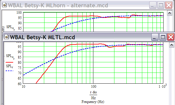

Scottmoose said:An MLTL would be easy enough.
Indeed........
MLTL
L = 46.5"
WxD = 232.85"^2
zdriver = 8"
zport = near/at the bottom
dport = 6"
Lport = 0.75"
stuffing density = 0.2 lbs/ft^3 shown
ML-horn
L = 60"
top WxD = 33.29"^2
bottom WxD = 332.85"^2
zdriver = 23.6"
dport = 5"
Lport = 0.75"
All dims approximate.

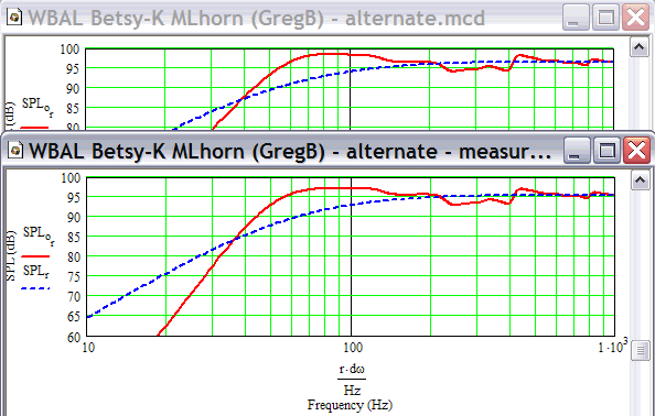

dunno John - I'm not a good builder plus am about dead energy-wise for all practical purposes - as a cop-out it might first go o an open baffle above my Gw-1858 H-frame woofer instead of the D216 I'm using - - here's an idea by GregB - - GM simulated it with two different circular vents - maybe he can put up the spl and Z-in plots

Top plot is based on the assumption that the K-slot's acoustic center (mean) can be calculated same as an exponential horn's, which places it almost at the closed end of the slot, hence the higher tuning. The 'alternate' assumes the port is near/at the bottom. Note that the port is simmed as a ~6" dia. (28"^2) x 0.75" hole, so in reality the roll off response is probably somewhere in between the two.
GM

Hi GM -thank you very much-for the simulations - looks good not sure how accurate my setup's measuring - how much & where should the stuffing be put in this pipe?
Greets!
You're welcome!
The sim is 0.2 lbs/ft^3 of polyfil spread evenly throughout the whole cab or ~ 9.25 oz total, but FWIW I prefer to just line one of each pair of parallel walls with 1" acoustic fiberglass insulation and any additional added only at the top. Probably a better choice considering the K-slot.
GM
