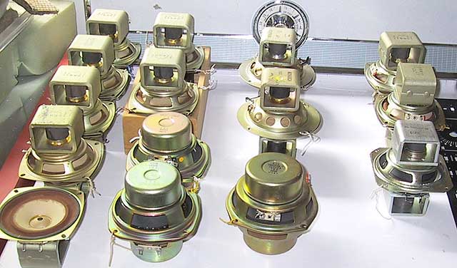

It was labelled Foster 10F3 and I thought that came before the Fostex F103? No?
The 10F3 predates those named FE103, and are the same generation as 78D261-1 & 10RD11.

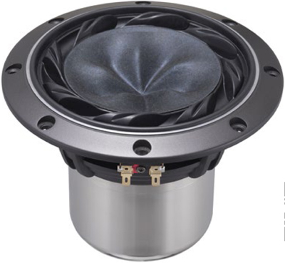

But this is not the first only or latest driver from Fostex to feature an Alnico magnet and I would think Fostex already has considerably large magnet chargers, no?
ex:
Fostex Premium Craft W160A
★ Newly developed HR diaphragm Fostex's original HR diaphragm has evolved with the latest speaker technology. For the diaphragm material, papermaking that forms a three-dimensional structure with a combination of materials mainly composed of fibers has been newly optimized for 16cm woofers. Utilizing the characteristics of the HR shape (* 1) that distributes divided vibrations while ensuring rigidity, it achieves rich, high-resolution premium bass playback that combines high rigidity with internal loss retention.
★ Alnico magnet type magnetic circuit Alnico magnet is adopted for the magnetic circuit. Furthermore, by placing a copper cap on the pole piece, current distortion is reduced and high-pitched bass reproduction is realized.
★ Adopting a proprietary foam driver on the edge We have adopted an original foam driver jointly developed with a material manufacturer as the edge material. Combines the texture of a solid rubber edge with the lightness of a cloth edge, and realizes resonance suppression along with the UDRT shape (* 2).
★ Newly designed push-pull double damper A newly-designed push-pull double damper with a wave shape design is installed. By installing two so that the wave direction is vertically symmetric, Cms linearity and amplitude can be secured.
[Premium 16cm woofer with alnico magnet]
Impedance: 8Ω
Minimum resonance frequency (F0): 42.9Hz
Playback frequency band: F0 to kHz
Output sound pressure level: 88dB
Fs: 42.9 Hz
Rated input: 35W
Maximum input: 100W
Baffle opening diameter: Φ151㎜
Mms (M0): 18.4 g
Vas: 13.5 L, Qms: 3.65,
Qes: 0.34, Qts (Q0): 0.31
Weight: 4kg
