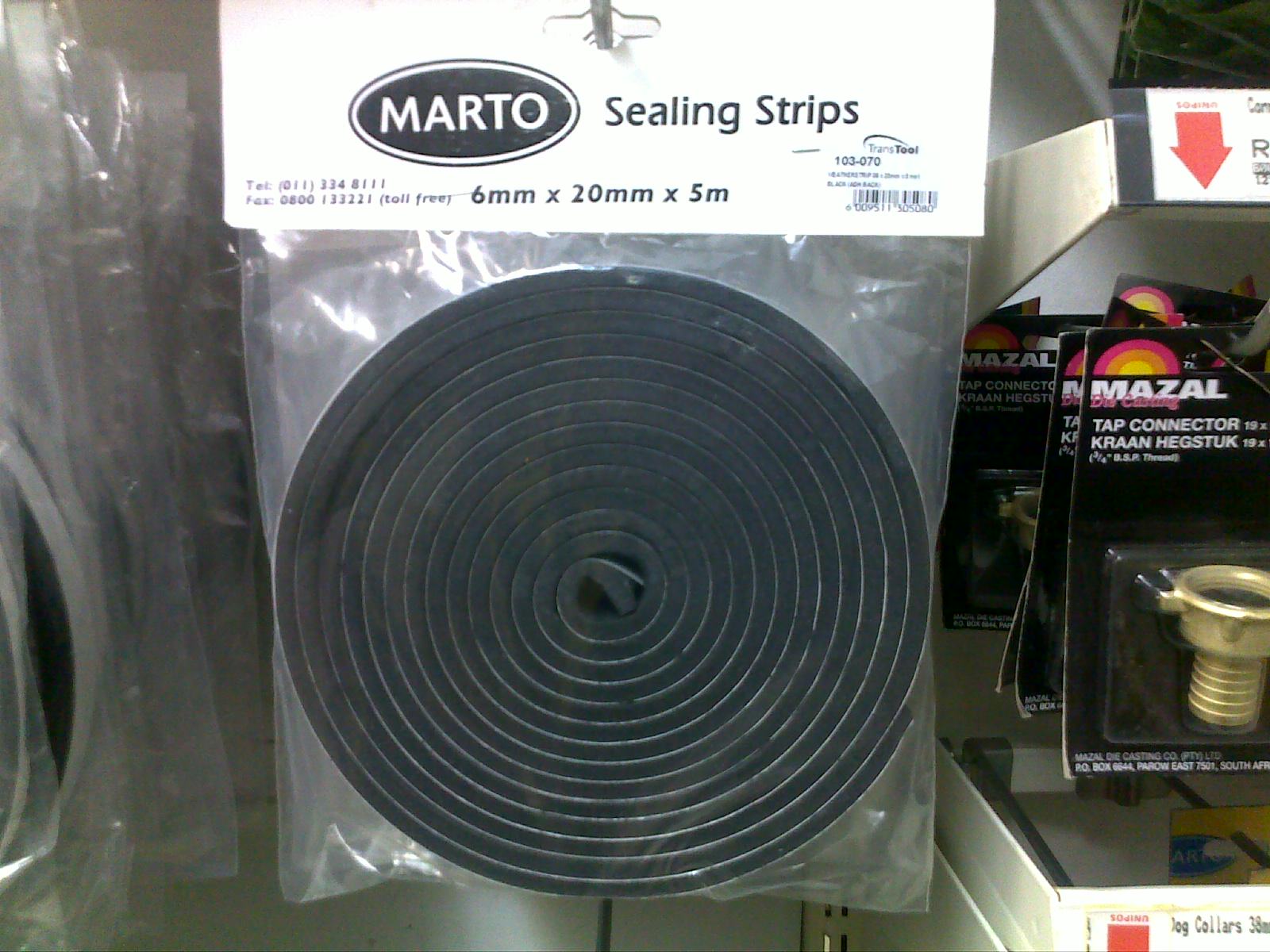

I've been brainstorming some, and I think I've come up with something that will keep the woofers energy from exciting the mid/tweet.
Do you have an example of such a compliant rubber gasket? I can't picture it at the moment.
I don't, but I saw something at a local hardware store that looks like it will work. It's some kind of foam-rubber sealing strip. It is similar in some ways to double-sided tape, but the core is a dark grey type of foam-rubber. It sold in long strips that are rolled up. I need to go there tomorrow, so I'll check what they call it over here (in South-Africa), and I'll let you know.

Sounds like something that's a bit larger than maybe a door seal. I'm assuming the driver would be more suspended by some bolts and "snugged" up slightly against the seal so that it may vibrate against the seal without exciting the baffle?
I gave this some more thought, and what I would suggest is that you suspend the woofers by their magnets, similar to what it looks like you already did. If they are fully suspended by their magnets, and the woofers' vibrations are sinked through that connection, then you can use the doorseal to mount them to the baffle. Then you could easily mount the mids and tweets on the same baffle with almost zero interference from the subs.

I had a look at my local hardware store, and I found that sealing strip again. Have a look at the attached pic. They had it in 3mm (0.12''), 6mm (0.24''), 10mm and 12mm thicknesses. I would suggest that the 6mm is the thickest strip I would suggest using with the woofers.
That's what I had in mind as well. Thanks a lot!
