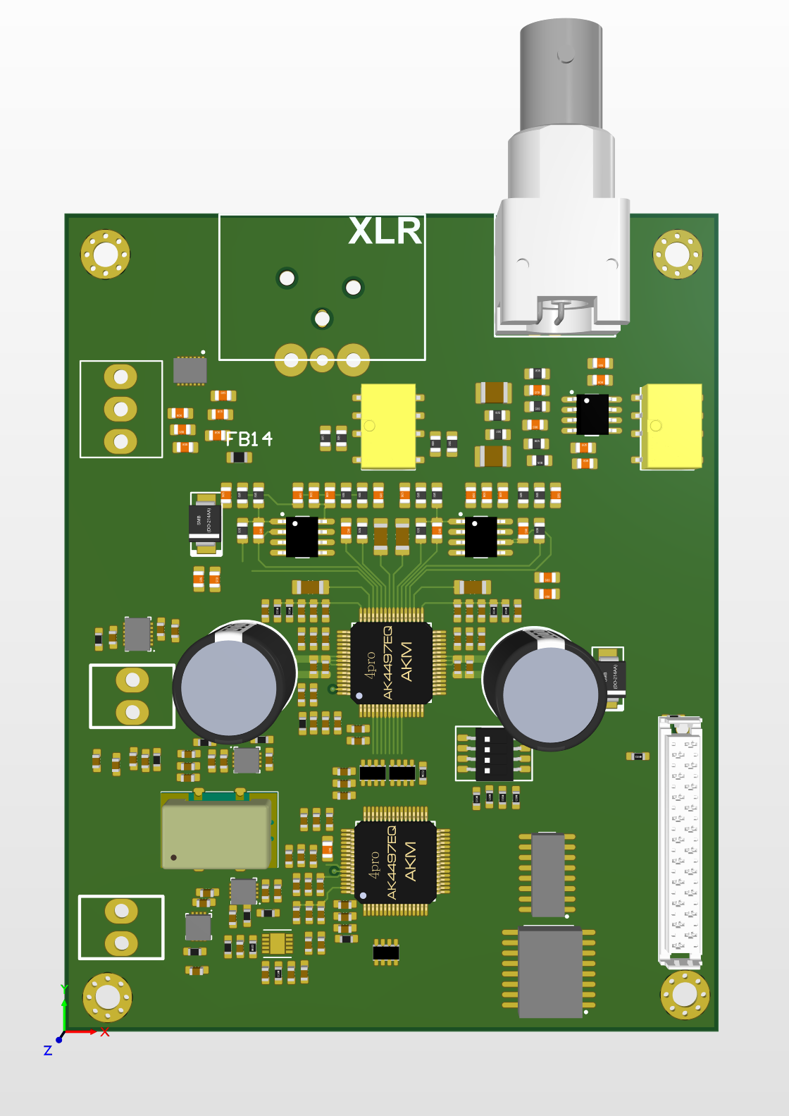

.. I just wonder how (exactly) the output circuitry works ... Might any of you have found a more detailed description of what the OPIN** pins do ... ? I.e. what "comes out of them"?

OPIN pins are supposed to be input pins from the external opamp based I/V converters.. in practice the opamp feedback loop is closed through this pin.
Then, in theory, AK4191 has the same direct DSD path like the previous AK chips, so external DSP could be used

@Joseph K: Looking at the datasheet for the AK4499, the OPIN pins appear to be an output pin and not an input pin ... ?? I think this would make sense as they connect to high impedance input pins on the opamps. And assuming that the OPIN//opamp impedance is 1 Mohm then the 180p capacitors would only give an appr. 880 Hz cut-off frequency for what is transferred through these capacitors. I think the OPIN pins need be outputs ...
My consideration really is if the AK4499EX could somehow be made with a passive I/V setup?
Hmmm ... I am not quite clear on the terminology of DSD "native" & "direct" but the AK4191 has filters for DSD - and as far as I can see the AK4499EX does not have a direct DSD path .. Or might I have missed something ... ?

No, I have overlooked it in a wave of optimism.. though that "dsd filter 2" sounds quite a 'formality', given that it then goes directly to the output interface, there is no modulator included..

Just guessing: it could be a FIR low-pass filter of which the coefficients are chosen such that the output signal always fits in seven bits. There is no need for a sigma-delta modulator then. The filter will filter off sharp edges/far ultrasonic quantization noise and make the DAC much less sensitive to far-off phase noise/jitter than if the DSD were just passed on unfiltered.that "dsd filter 2" sounds quite a 'formality', given that it then goes directly to the output interface, there is no modulator included..
