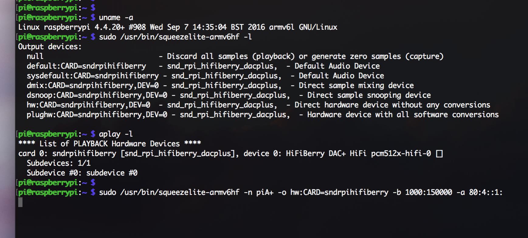

You can force HB DAC+ Pro into slave with "dtoverlay=hifiberry-dacplus,slave", so it uses Pi clock and no on-board HAT OSC's. Try that, maybe?
Awesome! Forgot all about that... will try it.
And if it works.... You can thank the fool that made it possible to run the Pro board "slave", not using the Foxconn OSC's. 😉
Add dt param to use HiFiBerry DAC+ Pro in slave mode
Wow, that lit it up! Listening thru some sennheiser hd650's & amp, really enjoyable! (Tron soundtrack)
Thanks! Haha! The slave option does in fact... work. 😀
