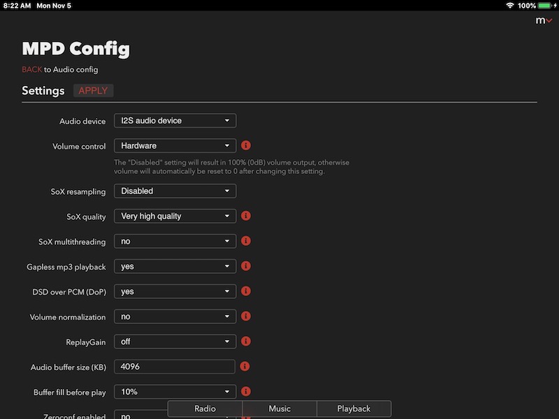

Nice work Tim! Love Tele Touch! Is the ess hardware volume on the Katana controllable by default from the software?
Yes, just set the Volume control option in MPD config to Hardware 🙂
-Tim

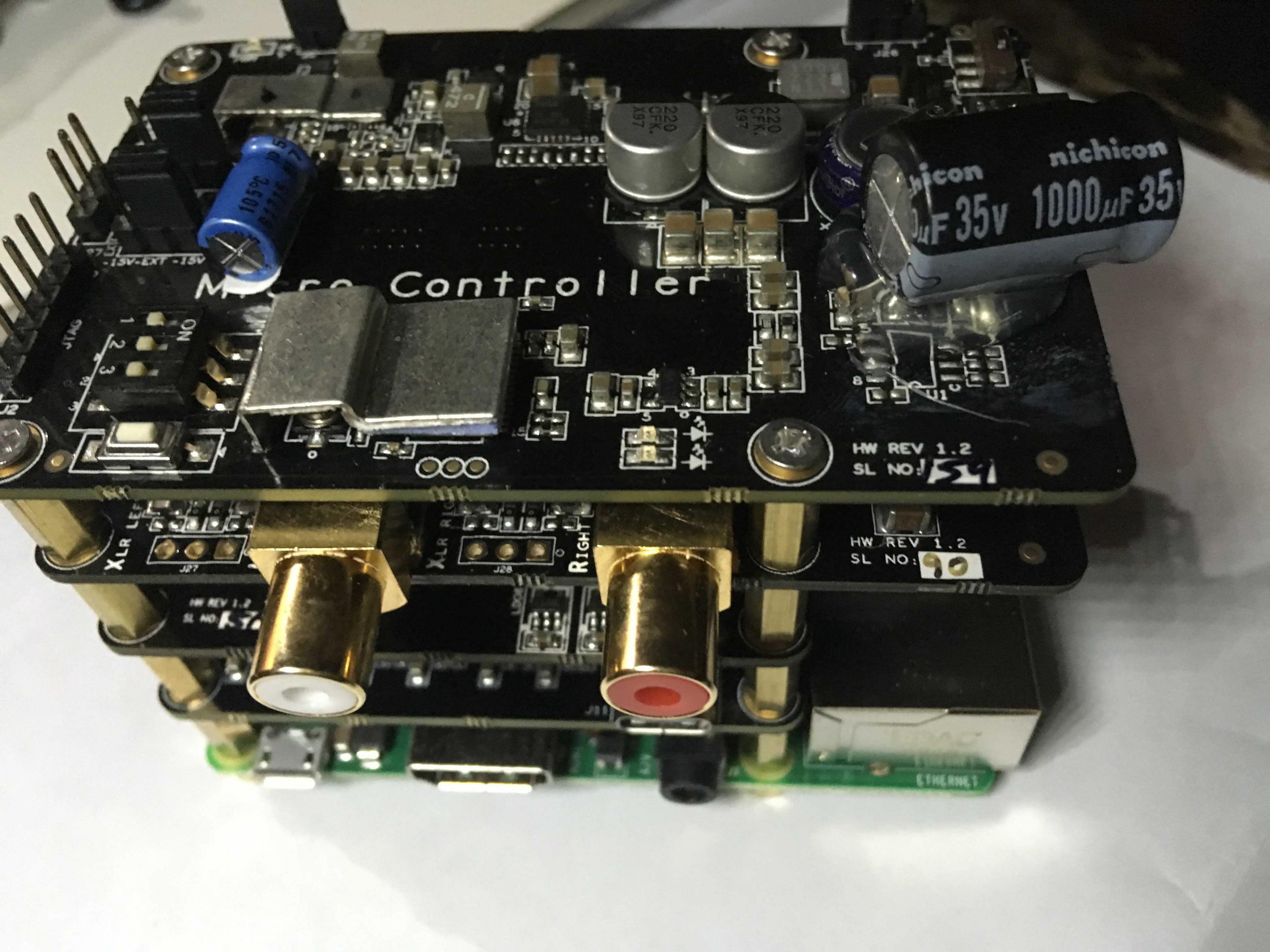

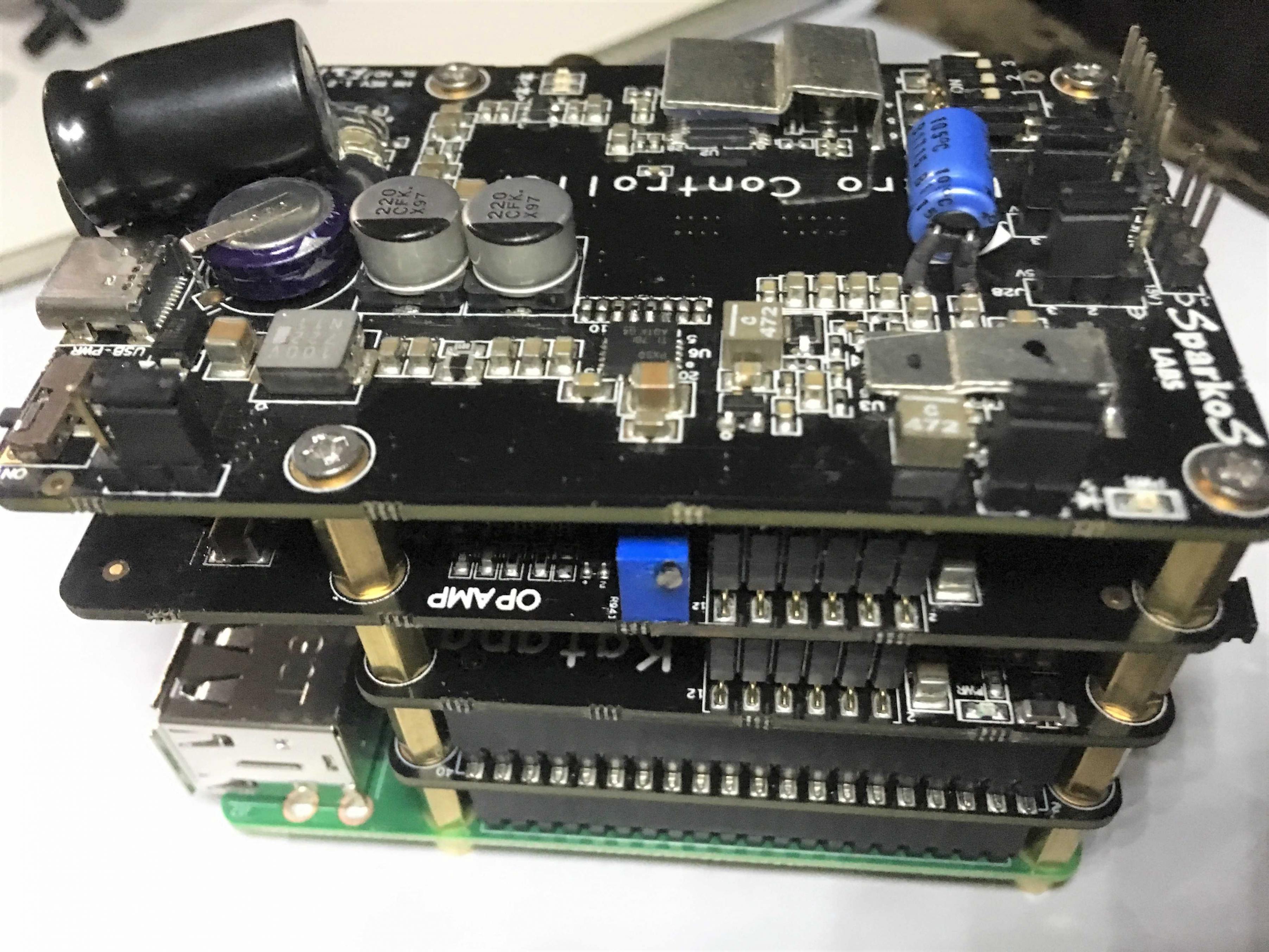

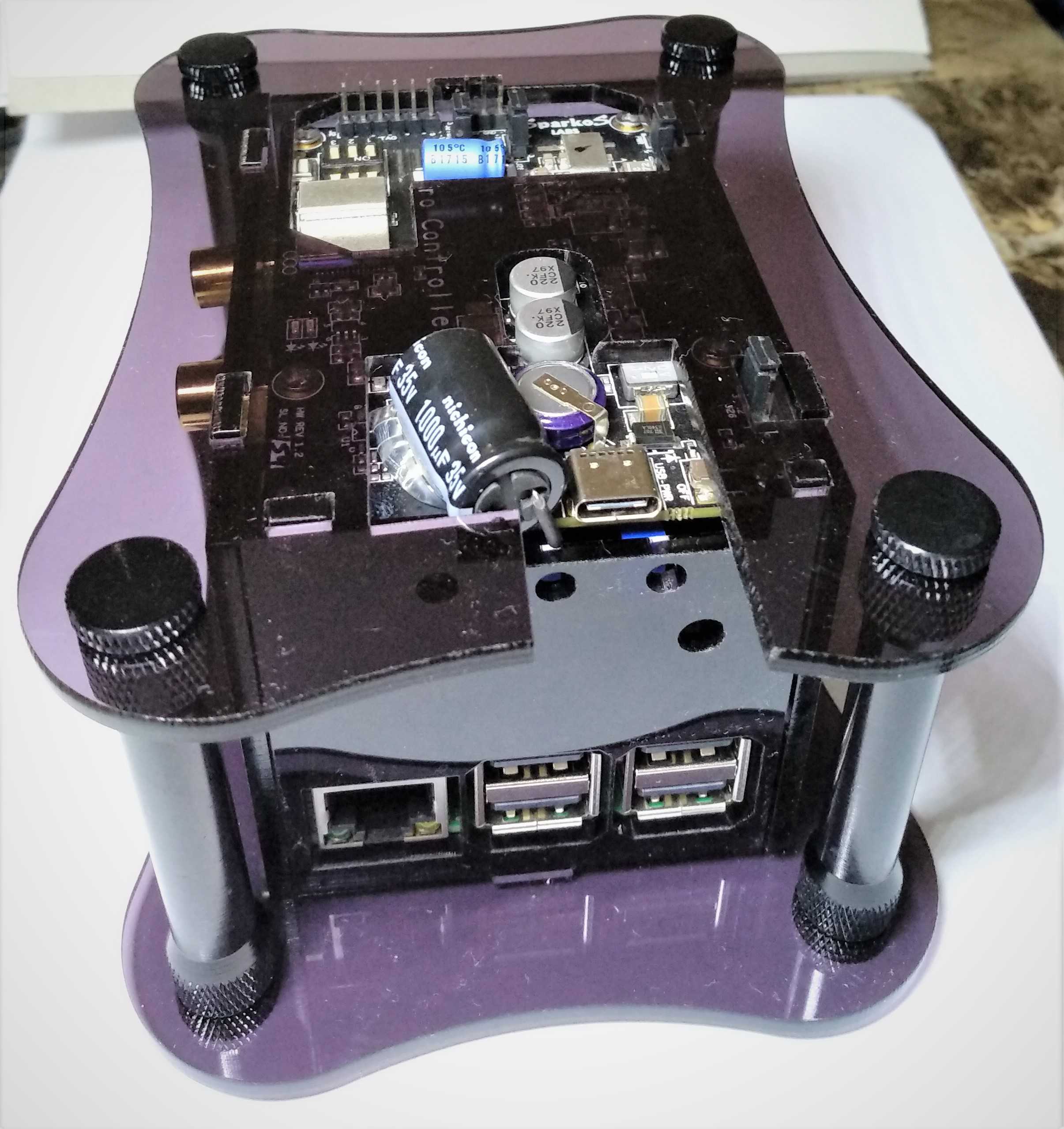

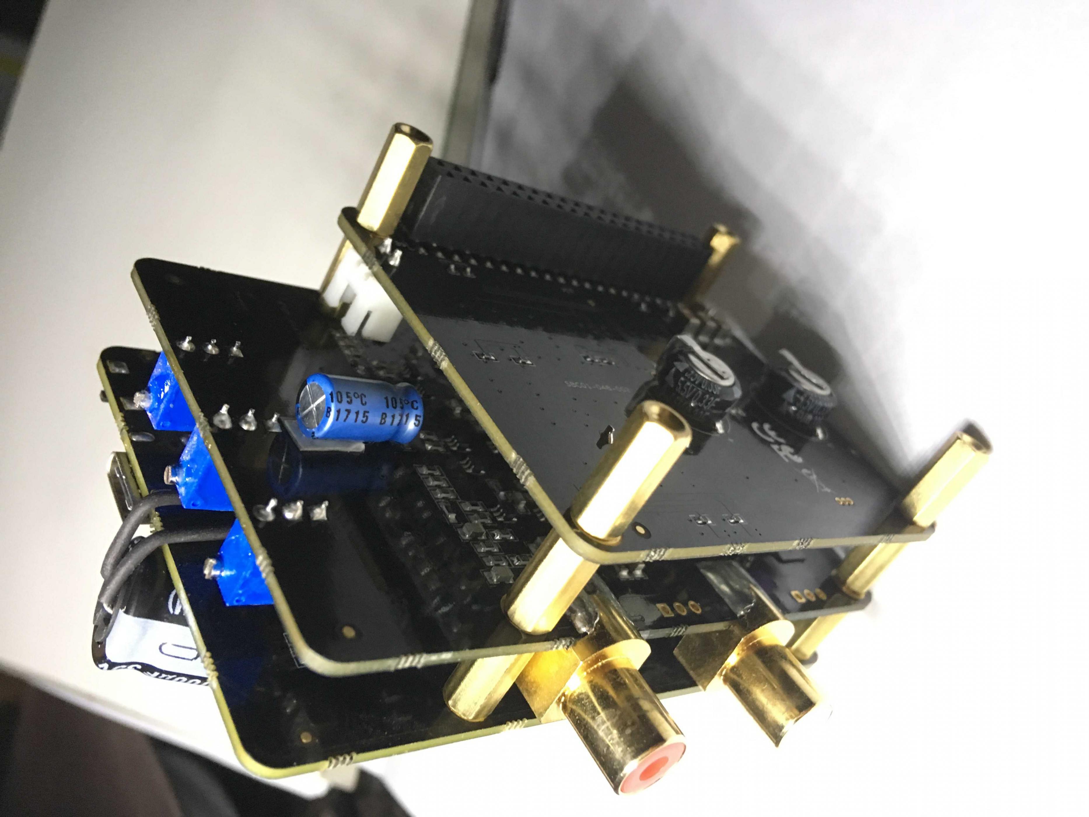

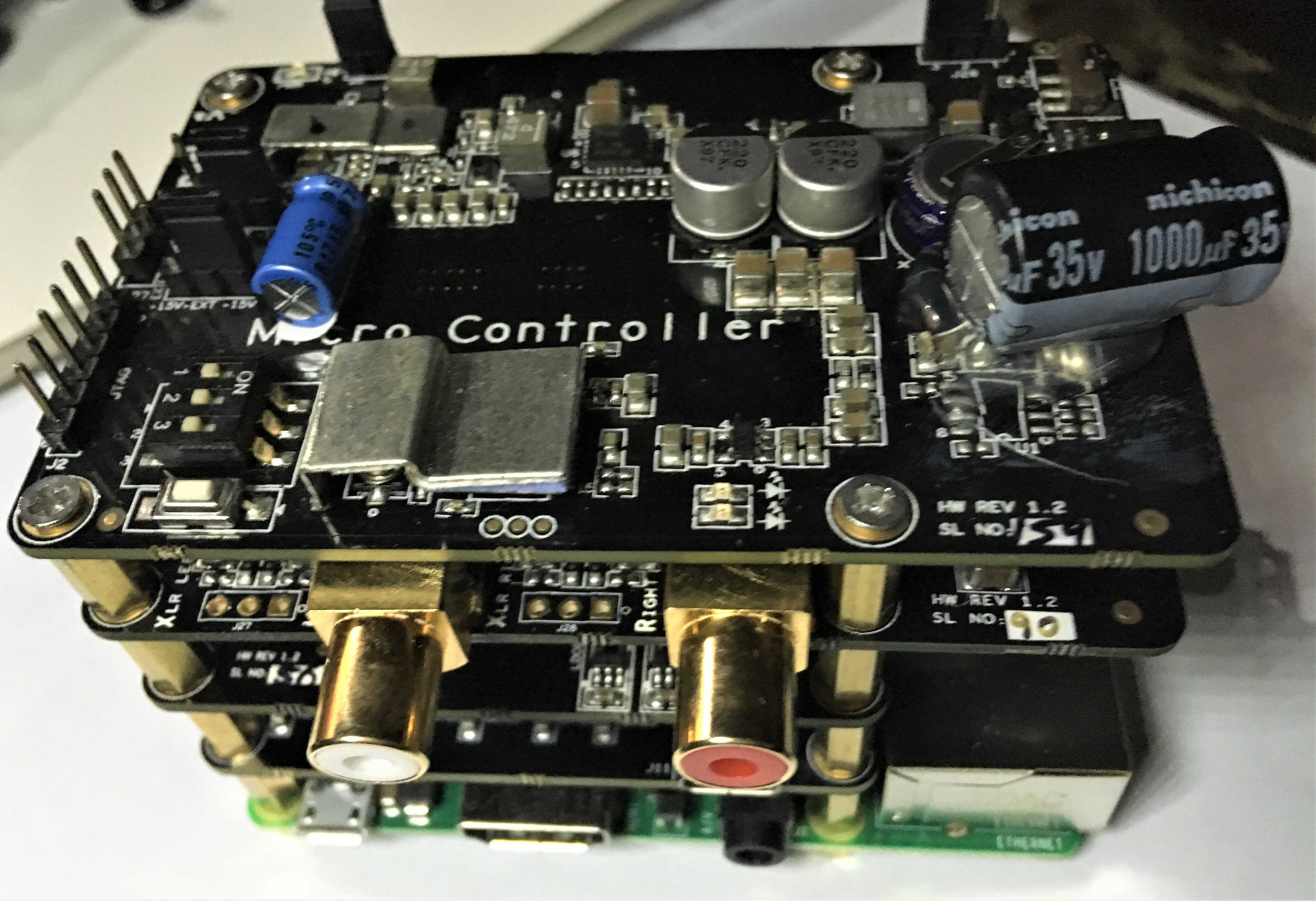

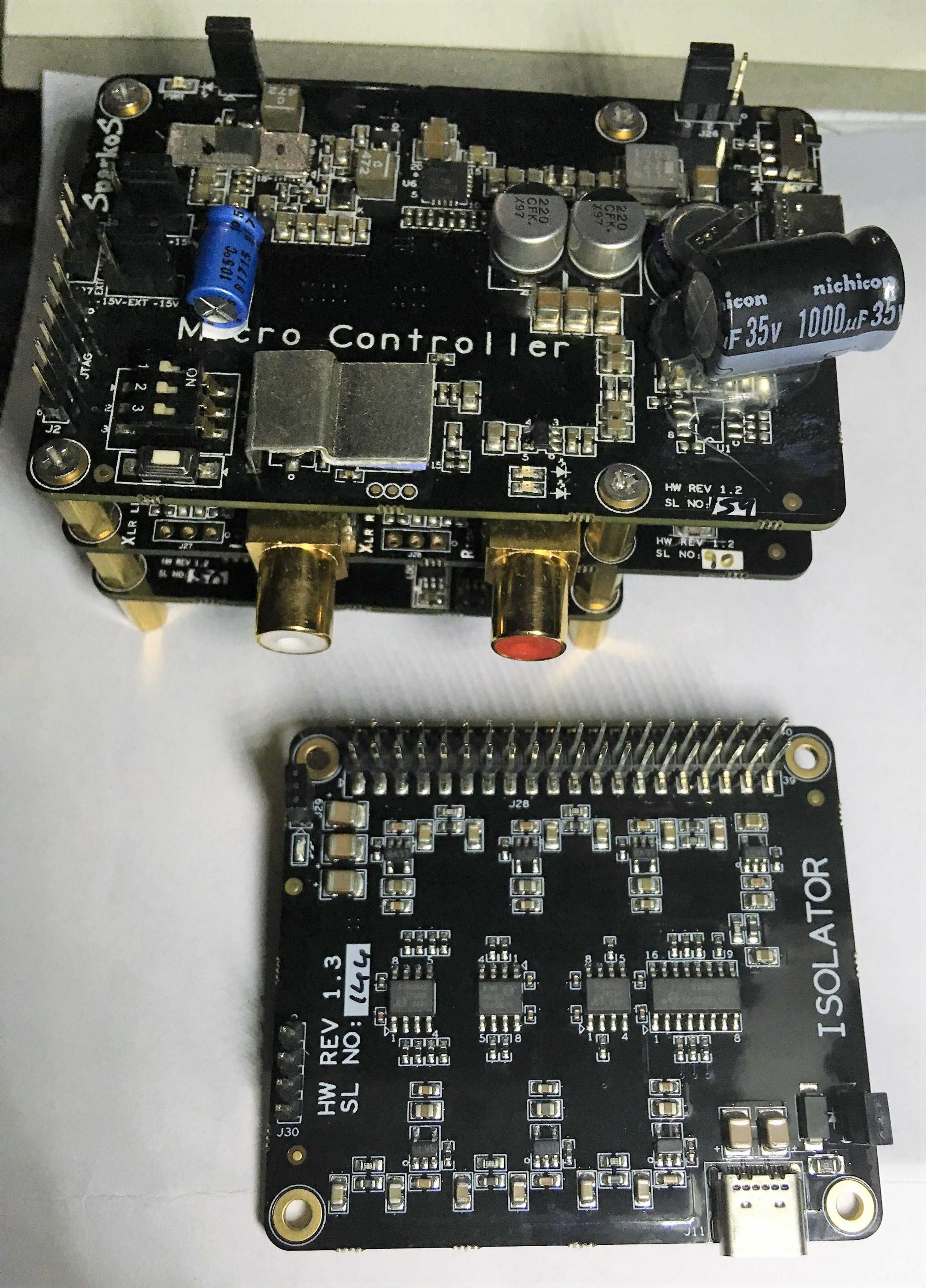

The beefy Katana 1.2
Received it last night... had to travel 200 miles to pick it up and encountered slight altercation with Saudi Postal personnel.. but worth it.
Im still breaking it in to allow optimal SQ as recommended. Contrary to the earlier remarks, i found the unbroken-in sound to be leaner than the Katana v1. I am yet to verify this in terms of clarity with my Marantz HD DAC - USBRIDGE with ifi purifier & jitter bug in the chain which slightly overtook the tripowered Katana v1.
First impression on the katana v1.2 (fresh from the box) using the SQ optimized OPAMP.. Hugh Masekala's Stimela attained the same chocho train realism when I first heard it in Chord Hugo 2 DAC ($2500). The hasp of Masekala's voice was awesome. I am yet to listen on more tracks. 24 hrs of break in may not be sufficient.
I also notice the blinking red LED in the Pi side after Isolator v1.2. I really need to understand why this is the case on my RPi 3b+. 😱
All in all. Great job allo.😀😀😀😀😀😀
The overall presentation of Katana is a value for money with killer quality electronic parts.
Have a quick glimpse at the new Katana here...
Nichicon caps.. (Nice Allo)
The complete stack (SQ Opamp)
