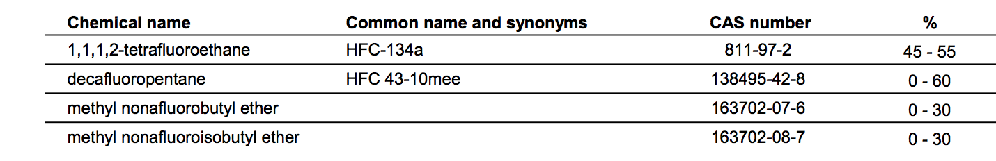

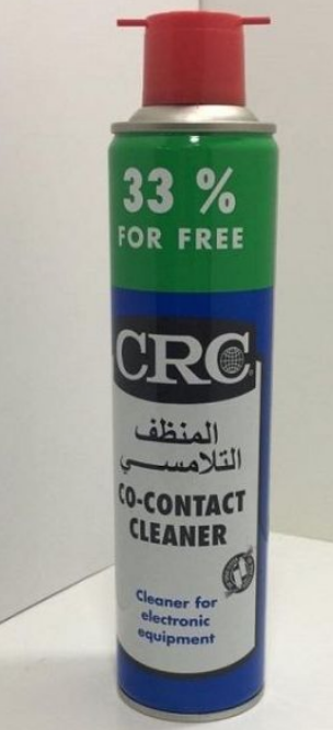

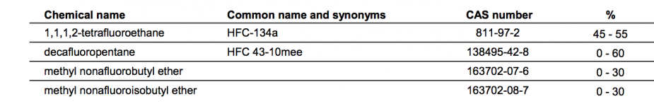

Will this CRC from Belgium good enough to be used in the terminals of pi 3 b+?
