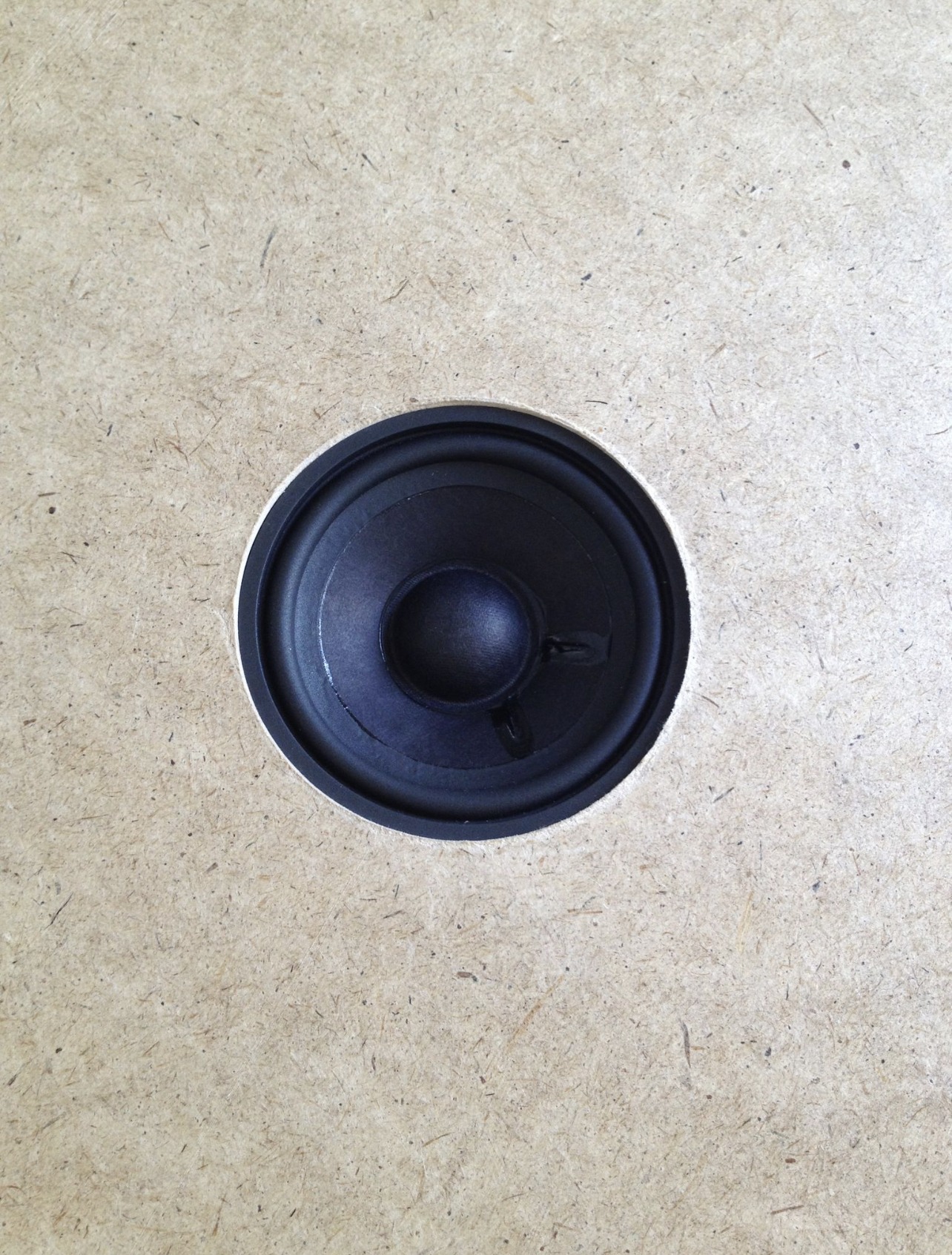

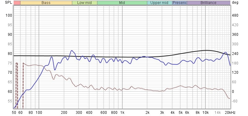

Not on the same baffel but no it doesn’t have the dip.
Edit: not as big of a dip, but there is something there.
The issue is not baffle related even though I purposely did nothing to mitigate diffraction issues. Except the felt.

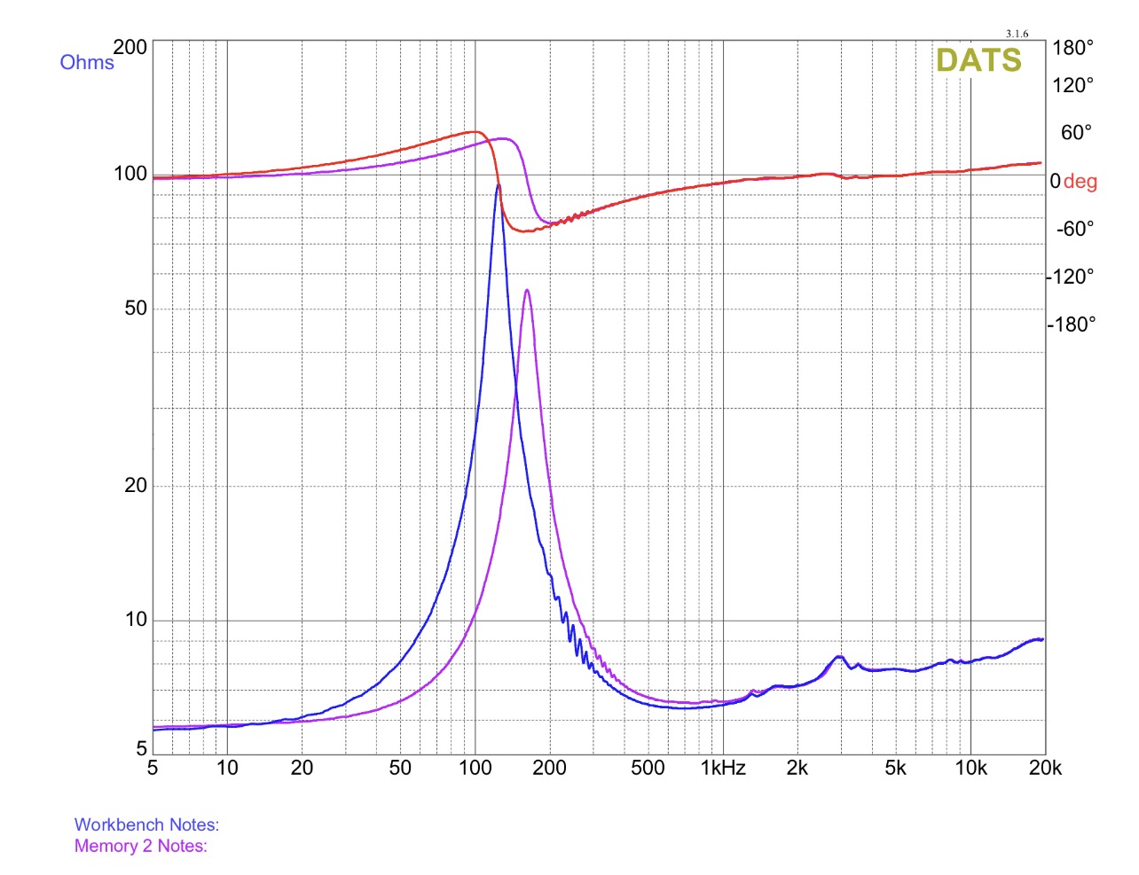

The impedance measurement shows in box and free air. The notch is present in both.
I did try to find the issue by placing weights on different places on the cone and measure. I found nothing that affects it.
The cone treatment did nothing to it. So maybe rear suspension or something else is the cause.

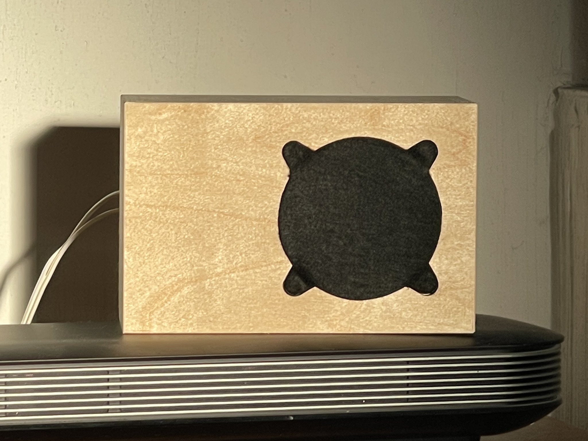

To pult felt in front of a driver, a HF producing one even, seem to be a very good way to muffle the sound. Which show in the measurements. I think I never heard of this being done before. Why? Looks? Use something much more transparent?
With the rising response I can use it as a passive way of attenuating little above ~1000hz. But mostly for the looks, and I had them laying around from a previous project with 4fe35 that was mounted from the front. I simply layered felt around the driver until it was hidden.

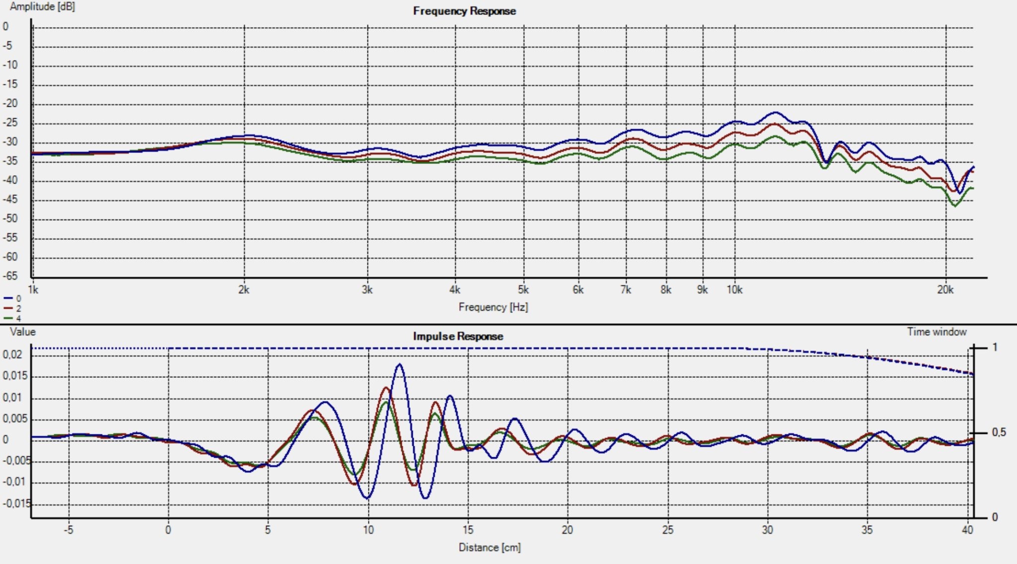

I tried this passive attenuation before with fleece fabric. 0, 2, 4 layers of fabric in front of a 3fe25. Quite linear attenuation.

Sorry. Yes, I see now Nissep used it to attenuate the highs. Interesting. I used a BSC with the 4FE32 drivers. Makes a big difference to my ears, but have not measured the effects with or without the BSC or felt around the drivers.
It's unorthodox... 🙂 but on axis it might work. But if you think what happens off axis, the felt thickness will be thicker and thicker as the angle increases and thus, the signal need to travel through an extra millimetre or 2... This will make an already beamy speaker act like a laser up top.

A extreme near field measurement of the surround/front suspension does not show this dip. So my suspicion is that we are dealing with a ring resonance where the furthest part of the cone is moving out of phase compared to the center.
And a measurement extremely close to the top of the phase plug shows a narrow and deep dip, that indicates that it’s the sum of a ring that reaches the center at the same time out of phase.
Time to bring out the laser and some sine wave stimuli at the problem frequency.

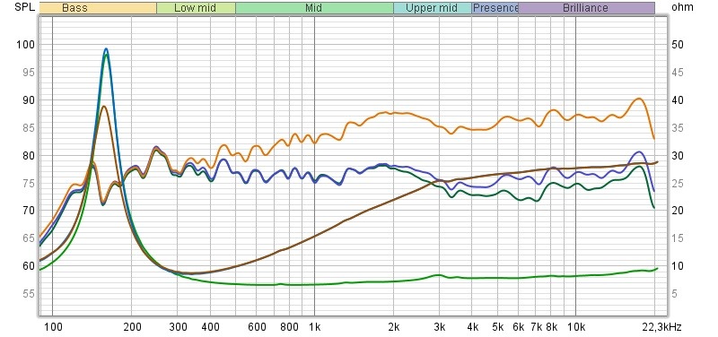

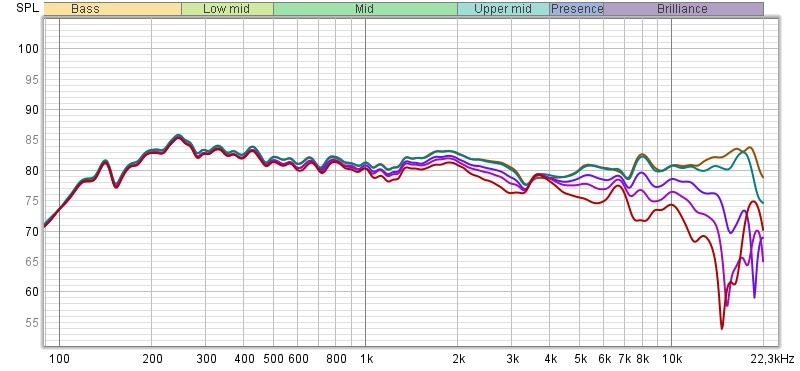

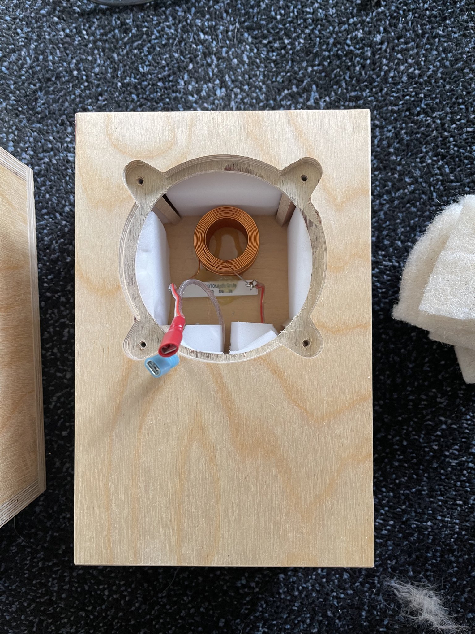

Well my filter parts came and today I measured the effect.
And I`m done, don`t see any point going further until I chose to ad a DSP in to the equation.
Its not perfect but fun to listen to, they are good enough for the intended purpose.
And I sadly came to the conclusion that I like them better without felt cover.
First image is 30cm on axis with filter but no felt cover.
Second image is no filter or felt in yellow only treated with LTS 50, Purple is with filter no felt, and green is filter and felt.
Last image is around 15cm distance to the baffle, 0,10,20,30,40 degrees of axis.
Level matched at 100Hz.
And each and every measurement result is frequency dependent gating.
Filter component was a 2mh Jentzen audio inductor, and a 20ohm resistor I showed in previous post.
