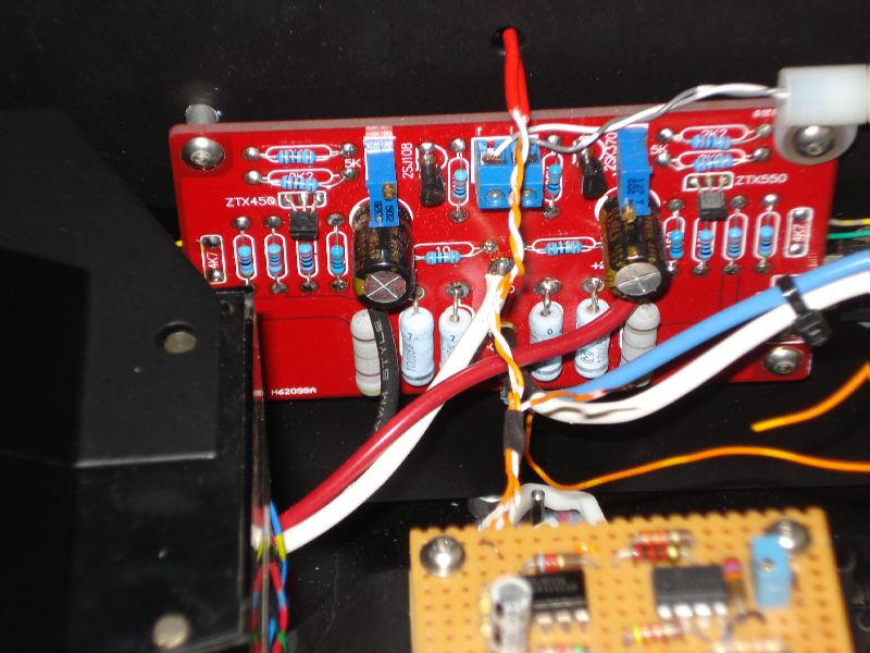

I've looked at your pics, and compared them to my Jim's boards, and you seem to have the caps, semiconductors and trimpots installed OK (as long as they were set to minimal resistance at the start). Difficult for me to confirm your resistor values, from your pics.
I'll get into the schematic, and see if I can get some ideas.

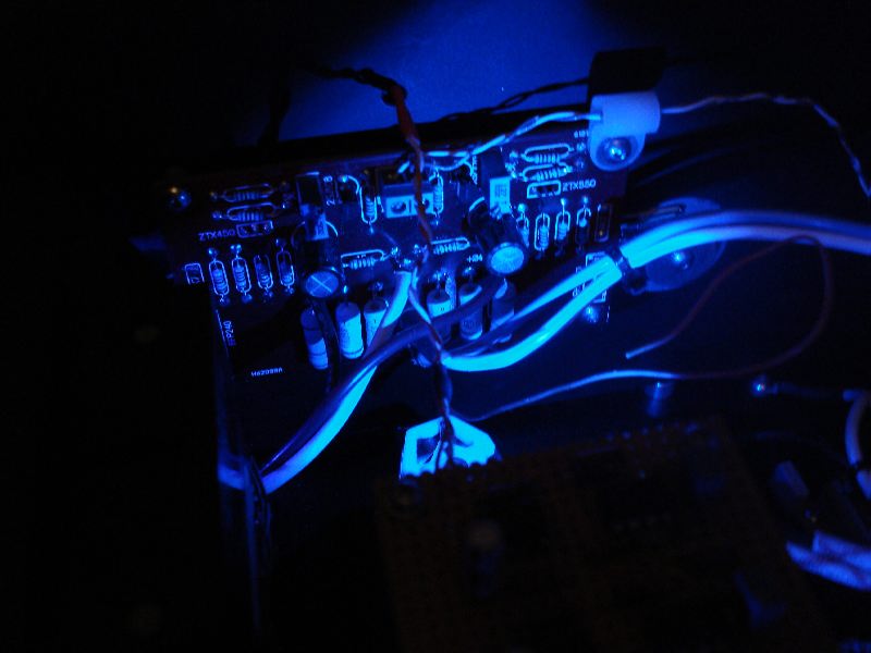

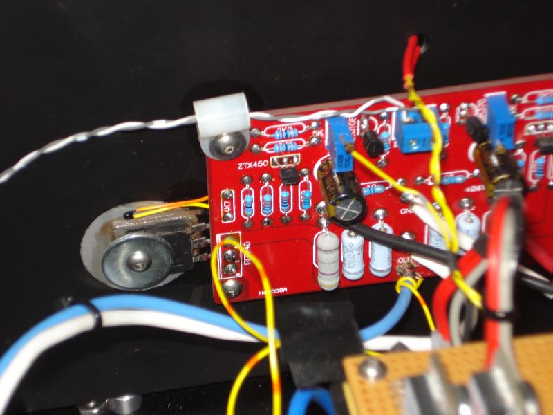

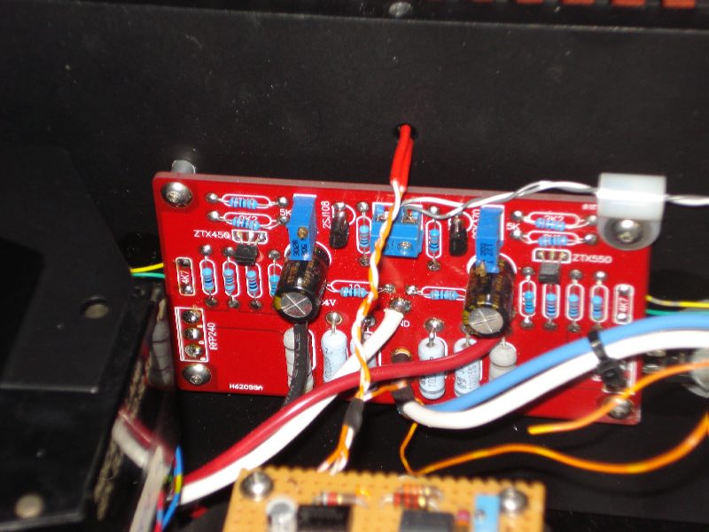

In the meanwhile, here are some pics of my Jim's boards. I had no problems on start-up and in continued use. The first two pics are the left channel PCB, while the third pic is the right channel PCB. I've included the fourth pic, just because when the PCBs are illuminated by the blue LEDs inside the case and viewed through the bronze plexiglass top panel, they just look so darned sexy(!).
