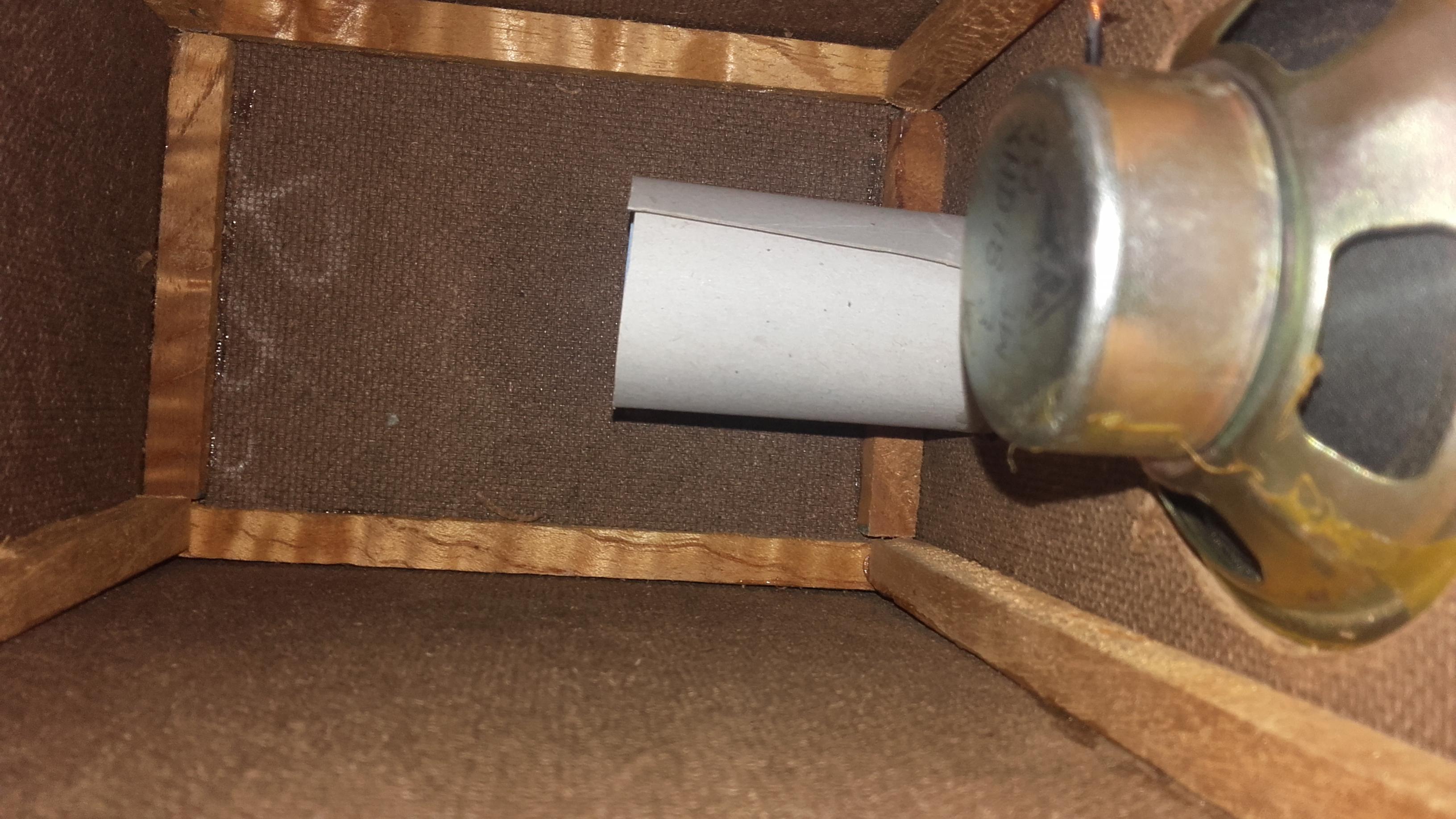

Initial testing of speaker enclosure with only sides and bottom completed (placed a book on the top) are very encouraging. The speaker plays quite loud, pleasing sound quality, and audible bass, although sealing the box and adding the port tube should improve things.
Was worried all that work would go to waste and it would sound terrible!

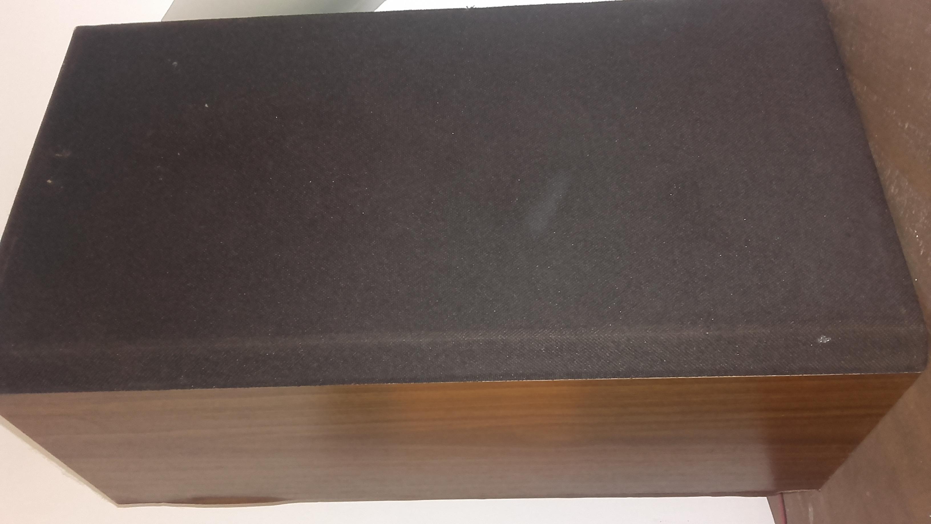

Speaker enclosure completed
Completed the speaker enclosure with hardboard, Sounds boxy with the 500 hz or so peak that shows in the spectrum analysis.
As a reference speaker I used the Sony SS-333 series.
The bigger speaker shows better bass output, however many peaks and valleys in the spectrum for both, the bigger speakers bass is audible, the difference is audible and matches measurements.

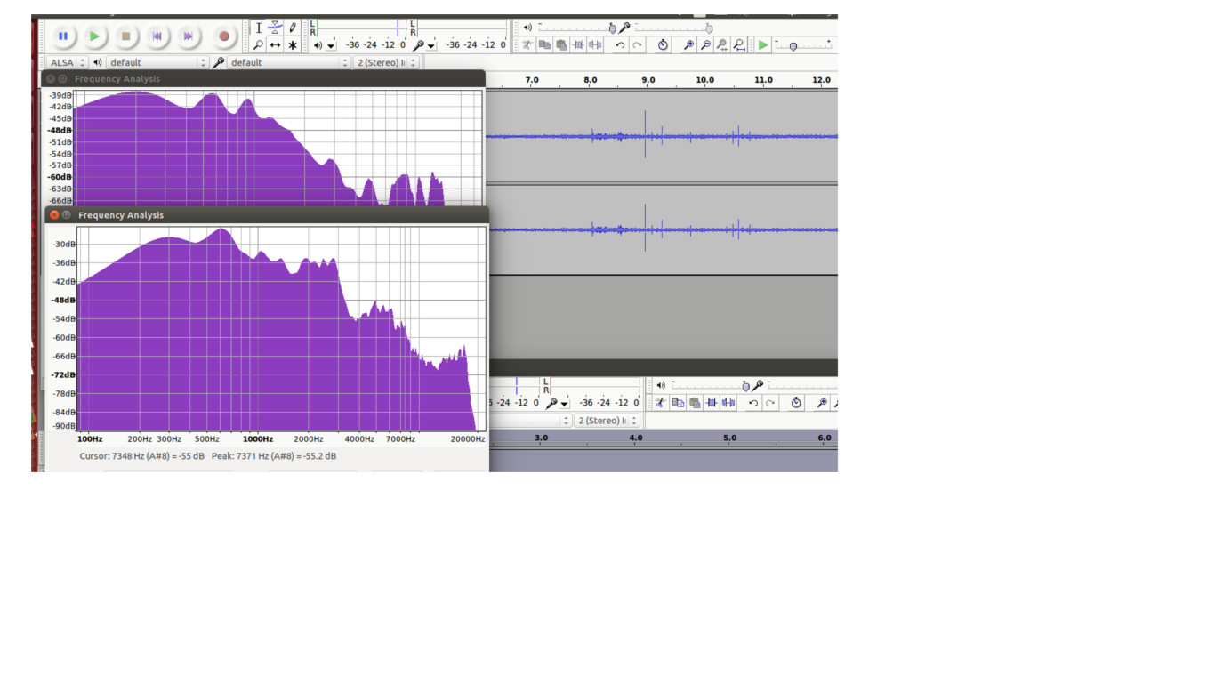

Spectrum using Audacity
Pink noise spectrum analysis. Need to achieve more bass.
Top one is the large Sony S-333 speaker. The lower one is my bookshelf using the 3 inch driver.

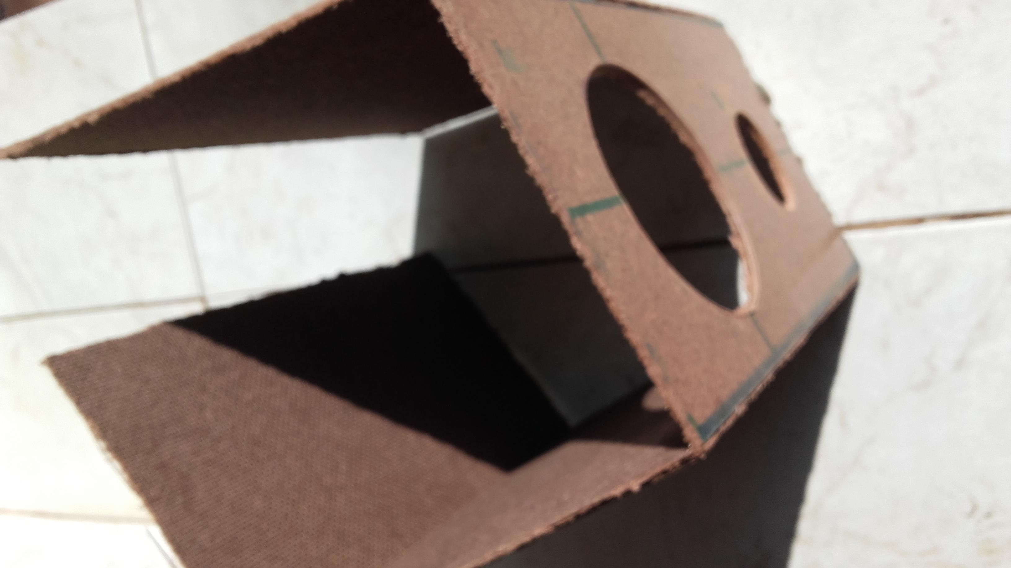

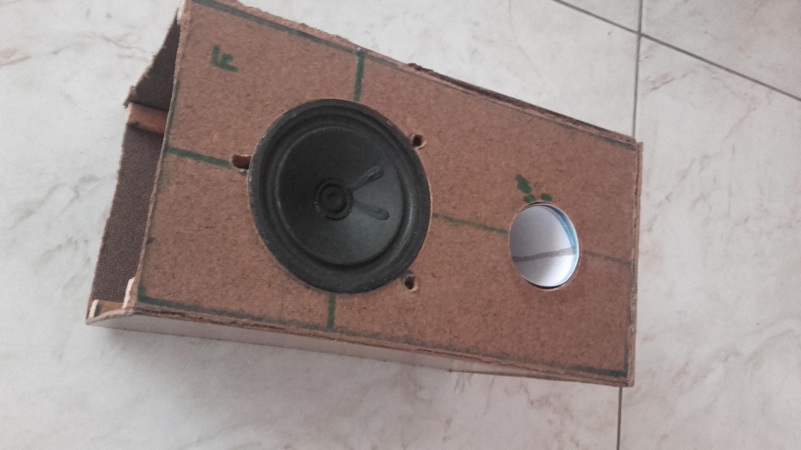

I decided to use corrugated cardboard enclosures to speed up prototyping. Cardboard has been used to build furniture, a bicycle and even a church.
I built one enclosure and painted it, but that was messy, and not good for the environment, so the next one I will cover with vinyl covering or with water based paint and a thin white glue varnish.
I will use several layers of cardboard to build the enclosure, since the single thickness is not strong enough, and there are several types of cardboard to contend with.

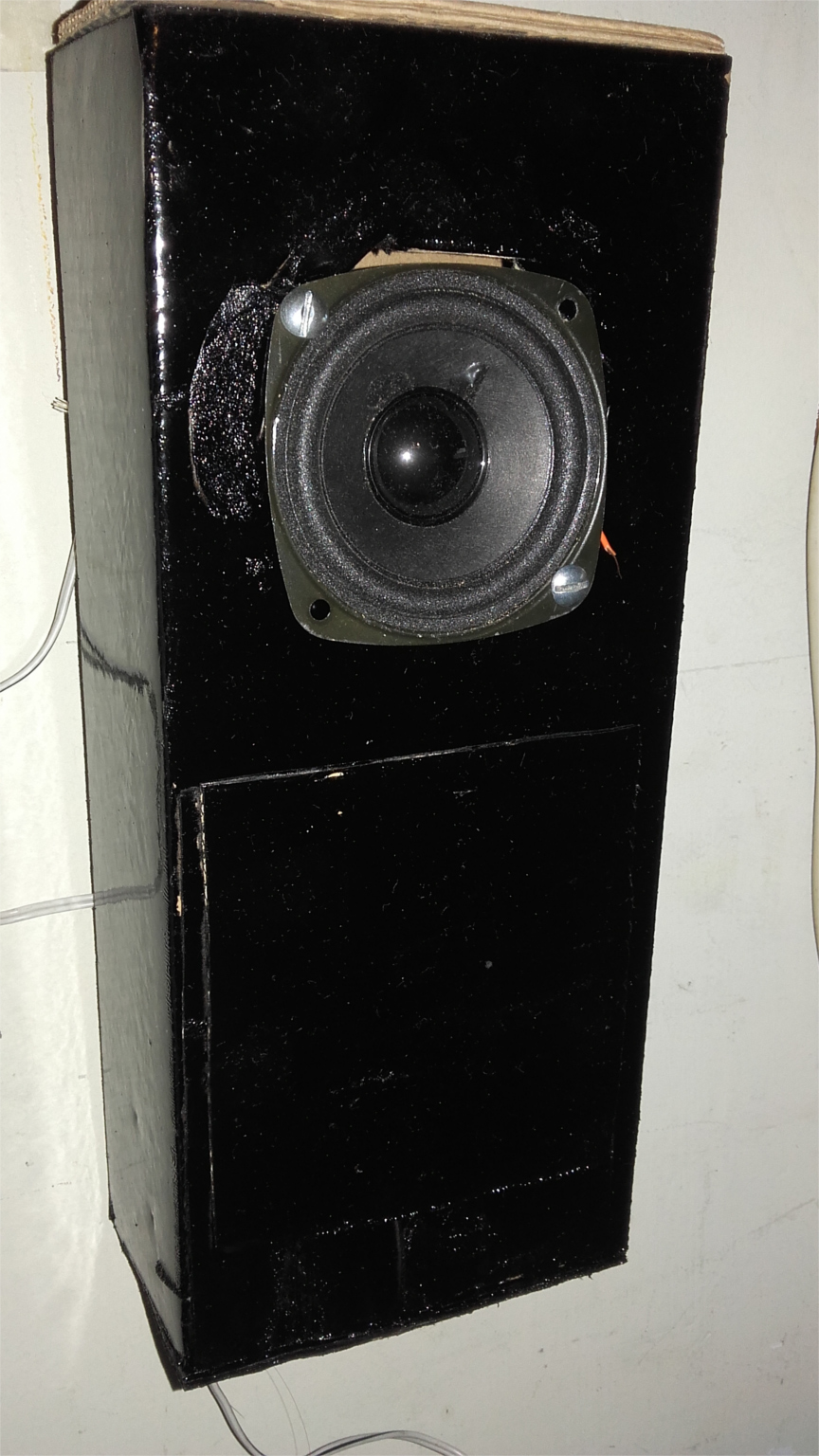

Completed enclosure
They sound fine, a big improvement over the plastic enclosures. Clarity is good, bass is acceptable.
One strange thing is that the sound seems to drop out from time to time, maybe the polarity is not correct on the speakers and the sound from one speaker is cancelling out the other. Otherwise really a very good final result. All this is cardboard, and I need to improve on the fit if not the finish on this thing.

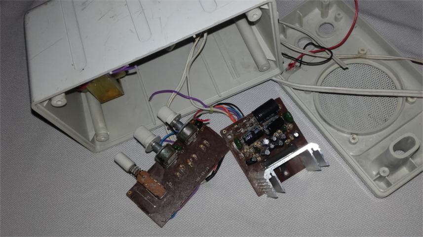

Picture of old PC speaker that the drivers are taken from.
i really like that old pc speaker look, they do not look that anymore and i think it is a bit sad, everything should look so cool today
The problem with that original plastic enclosure is that the grille caused some distortion due to interference, at least that is my take. Replacing the grille and painting them black would have worked I suppose.
