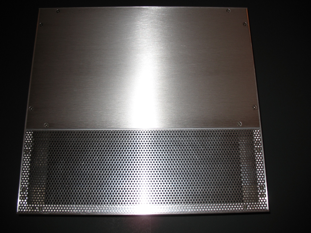

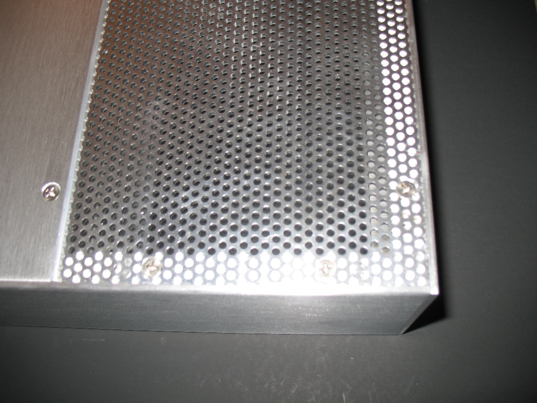

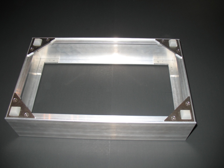

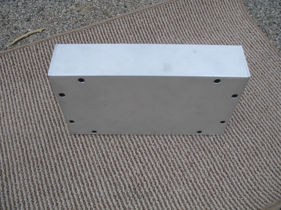

I have now completed my Ausio Note clone and used a LandFallSystems chassis for this. Rather than having the actual top plate drilled for the PCB I opted for a seperate cover plate (see pictures).
This offers two major advantages: 1) easy to make changes and/or do maintenance, no removing of the PCB is required and 2) if wanted then a new "cover plate" can be made with a toatal different layout (e.g. not using a PCB) and recycle the rest of the chassis.
I used waterbased laserjet decals that I printed in reverse. The sequence of steps is: coat the front panel with a couple of thin layers of Krylon high gloss crystal clear, let the front dry, coat the decal with a few coats of Krylon and wait until tacky and then place it on the front and push it down hard and let it settle for a while. When settled use water to disolve the paper backing and glue layer of the decal. Afterwards a few more coats of Krylon before baking the front panel in the kitchen oven. (melting point is approx 165C, wait until the front goes all glossy then remove and let cool down). Waterslide Decals Cured in Your Home Oven - The Artful Crafter
I have no affiliation with LandFallSystems except that I am a very happy customer, am extreemly impressed with the service I got and find their pricing for the work provided very reasonable (it is not mass production).
