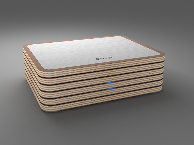

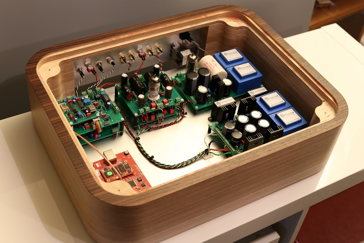

A view of my DAC Officina with my specific modules!
Specificities and Modular Plug and Play and resolutely musical!
Note: officina concept prototype case

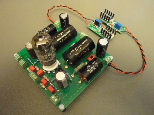

Analog tube output for DAC and Power supply with valve EZ80
Hello everyone,
For reasons rather subjective and probably also to meet future technical choice, my desire to start to achieve this was to use analog stage and foremost get very good performance with a single tube. Therefore, the choice of the tube takes a prominent place for reproduction and sound texture. So I used a tube of Our ecc88/6DJ8 kind that I like, and it is good because it makes us well.
That said, the technical reason which I refer above and the ability to easily implement the following line transformer, Type Single End. In this context, we can according to the characteristics of the transformer and / or tube used also have the opportunity to put the two triodes in the same tube in parallel to double the current and thus divide the internal resistance of the tube.
Of course, other configurations have also given very good results, especially with regard to rendering and output impedance, but that would automatically require the use of a tube per channel on one hand and have decreased somewhat our room for the simple implementation and optimized configuration with a line transformer or single-ended.
Looking at the diagram (Appendix) we can say that the scheme itself is called nothing special, except the ability to select via an inverter load anode or by Resistance by CCS. Then if you look closer, you will notice that the design and the general routing offer some features that everyone can enjoy and / or optimized according to these tastes.

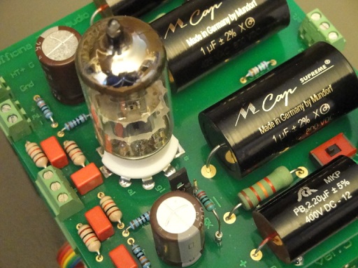

Features: Module Analog Stage for DAC and Préamp or SE configuration
- Ultra compact 90 x 100mm.
- Routing dual-mono power supplies.
- Mundorf Supreme capacitors links
- Decoupling cathode by ELNA SILMIC II
- Screw terminals for connections. No son to weld!
- Bridge or inverter for the decoupling option cathode.
- Or bridge inverter for use in a TMS anode load.
- Local decoupling each triode with condos PolyPropylene (2.2 uF).
- Opportunities to implement various configurations in the Low Pass filter input.
For your information, there is also a professional version with the famous reference Our e188cc. The latter is very popular among music lovers, it offers subjectively superior quality but at a much higher price. However, a Russian equivalent exists with excellent tube 6N23P-EV.
Moreover, with regard to the CCS, I tested and measured different types of CCS anode load, and the latest one I finally selected and Cascode CCS. Thereafter, I finally used small adjustable modules (kits) almost ready and really cheap ($ 14) KandKaudio. I strongly advise all those who wish to quickly and easily implement their tube stages with Cascode CCS, the use of these small modules really convenient. Of course, if you wish, you can implement your own CCS or other circuits.

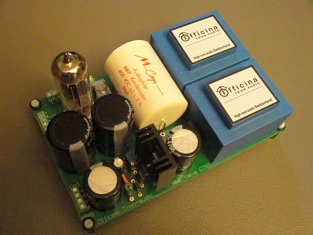

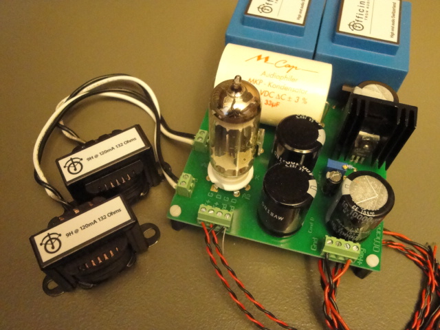

I also join in this same thread a description and some views of the power module base valve EZ_80
The diet of these features and EZ_80 Power supply module.
As you can see from this view both real images, this power adapter is very compact. This course supports all components as shown in the diagram. On the other hand, it should also be the distinction of being independent, modular and can be adapted easily to a given configuration. Here it feeds the output stage of my tube DAC, but it could also power a preamplifier and / or a small SE, if two or more was considered a mono-amplifier configuration.
Features Module Power Supply with valve EZ_80 :
HT Fuse (80mA)
Compact 100 x 160mm
Optimized routing masses.
Molded transformers integrated.
Routing power dual-mono tracks.
Connectors for all connections. No son to weld!
Smoothing capacitor (CL) 33uF/400Vdc Mundorf polypropylene.
Capacitors Ballast choice: 2 x 2 x 100uF/400Vdc or 220uF/400Vdc.
A choice according to location 1 or 2 decoupled available with terminal connections for chokes and / or Resistors channels.
One section complete and adjustable control for power filaments. (According Secondary Used: LM317T or LDO LT)
Current capacity: Characteristics of env.90mA EZ80 valve. Note: I have also little specific chokes (9H @ 120mA/132E)
