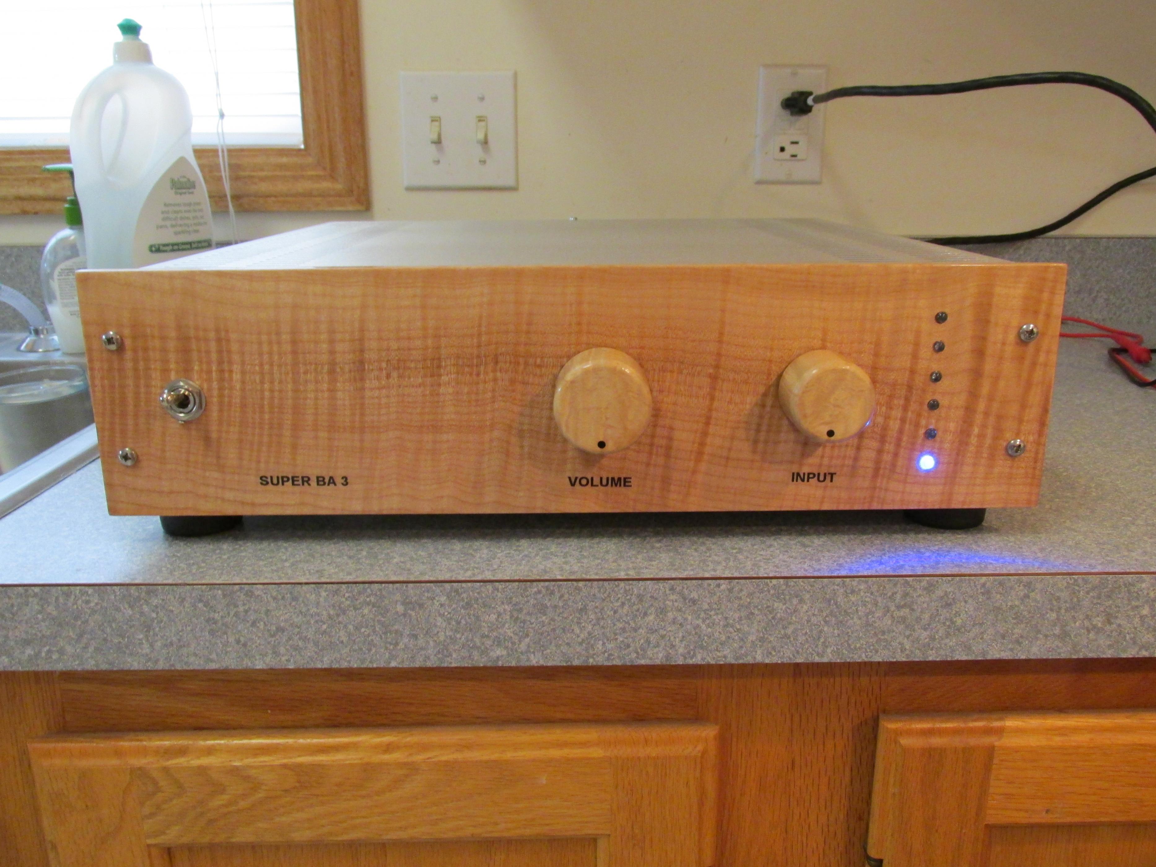

Hi Ryan, I got them from dknob out of Oregon. He did a beautiful job. Found out today that my wood working friend in the audio club also does knobs... He is more a winter woodworker. Here is a link to the guy in Oregon. Custom Knob Order Form 🙂

Hi Sprags, Thank you for the kind words. Yes, the power supply might be a bit over the top. I found the Antek power transformers so cheap and good that I made the decision to build it as "purist" as I could. It is the best preamplifier I have ever owned or had in my system. There is also a certain satisfaction of doing it yourself. I highly recommend building your own. 😀

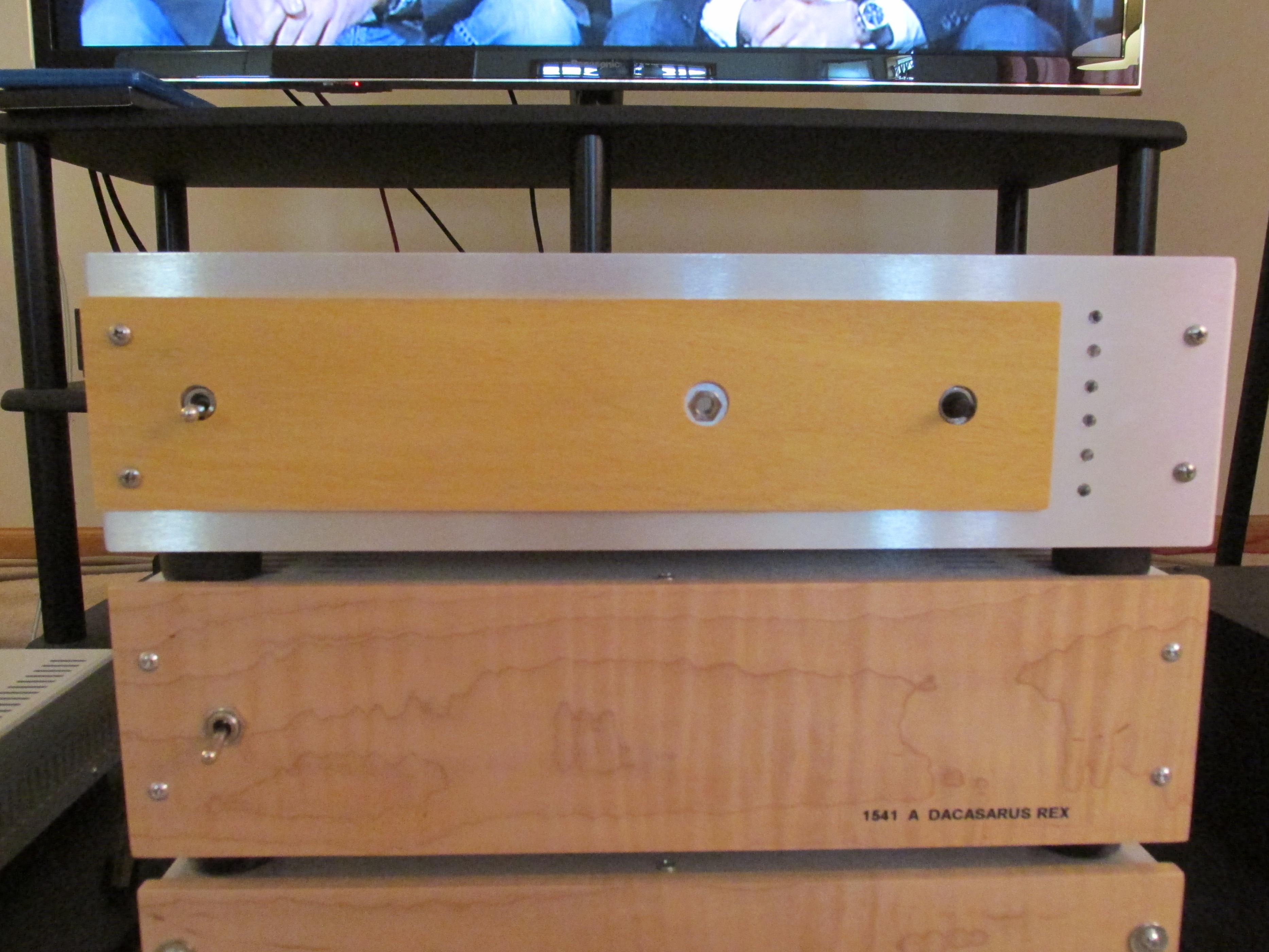

It was suggested that the pre looks a bit naked. My Cousin said that.... So I worked a piece of Brazilian Yellow Heart to make a wood accent. Also gives me a place to label "Volume" and "Input". So I will attach a picture. This is just a test fit. 🙂
Wood accent in place
Applied a clear lacquer finish yesterday. Open to opinions. Could ask my wood working friend to do one like this in flame Maple. A note on the Brazilian Yellow Heart.... The stuff has a tight grain and finishes well with a clear sealing finish. To avoid tear out at the holes drill a small hole first and go up one bit size at a time. Big holes work best with a stepped bit at low to medium speed. Beware of the dust when sanding or drilling it is a mild irritant. Did cough a bit working it. Once sealed it is no issue. 😉
Face Plate update....
My wood working friend made me a nice flame Maple face plate. Just an update of it's current appearance. Still works wonderfully. 😀Applied a clear lacquer finish yesterday. Open to opinions. Could ask my wood working friend to do one like this in flame Maple. A note on the Brazilian Yellow Heart.... The stuff has a tight grain and finishes well with a clear sealing finish. To avoid tear out at the holes drill a small hole first and go up one bit size at a time. Big holes work best with a stepped bit at low to medium speed. Beware of the dust when sanding or drilling it is a mild irritant. Did cough a bit working it. Once sealed it is no issue. 😉
