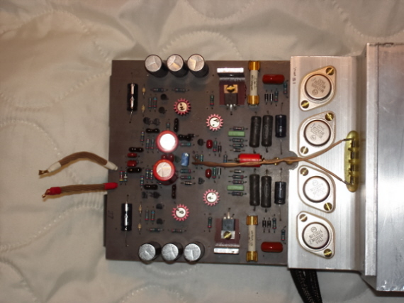

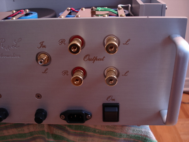

Hi all,
I know it was years ago but should you guies be interested in how my dual-mono power amp looks, here are a few pictures. It weights 140 lbs !!!
This is the MKII version as I modified a few things along the way.
Should you have any questions, please don't hesitate.

Briefly, EACH CHANNEL is built as follow:
--1 KVa customized Plitron LONO transfo with NO thermistor/thermal switch, NO extra winding for 230V...but with a bigger AWG for wires and therefore NO junctions whatesoever (better current capability and transparency). A real improvement in transparency from the MK I version wich used stock Plitron LONO transfos.
--Power supply using 4 Mallory 40 000 uF CGS caps for a total of 160 000 uF per channel .
-- Bipolar boards with 4 outputs per channel mounted directly on boards, working in class AB, running at +- 64V, boards made of Teflon OFC 4 onces (like in big Levinson) with a dielectric of +- 2, traces sfully balanced, impedance fully balanced, heatsink and output transistors mounted directly on boards so they are fully operationnal even without a chassis, each electrolytic can is bypassed by a prolypolen cap (Mundorf Silver/Oil or Dynamicaps) directly on boards.
-- Ixys soft recovery bridges for B+ and B- per channel (so 2 bridges per channel)
-- Black Gate NX, Mixture of Mundorf Silver/Oil and Dynamicap, capacitors on specific locations on boards and Zobels (after listenning sessions)
-- Mixture of Allen-Bradley, Vishays and NOS dale resistors on specific locations ( after listenning sessions)
-- Mixture of solders (each and evry one of them chosen for sonic characteristics after listenning sessions) ranging from VDH 3% silver, Cardas tri-Eutectic (lead free) and Johnson IA 423.
-- Hi-Fi Tuning fuses (too much hype here), Acme cryo Copper/ silver fuseholders, WBT topline connectors, Furutech copper/gold inlets, copper lugs and stainless and/or brass screws etc...were little toys to experiment with as part of fine tuning that I finally left in place (there not bad though).
--7 to 16 6N-multistranded twisted-copper-braids (with Teflon insulation) per wire throughout..
-- One power cord per channel.
-- Black Diamond Racing cones (3) underneath (had to fine tune were they would end up by ears)
-- Metal work is made of 5/16 '' 6061 aluminium all around
The amp delivers 240W at 8 ohms, 480 at 4 ohms and 946 at 2 ohms...don't have the measurements at the punishing 1 ohm though...But sincerely, I don't have other measurements as I don't really care about how things measure but only about how they sound and if I get emotionnally involved in the realism of music....

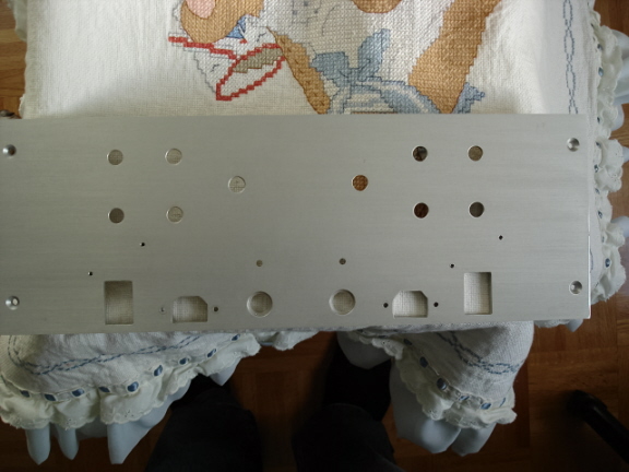

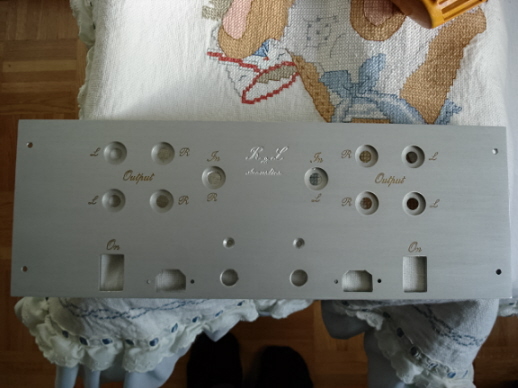

TO MAXPOU: Craftmanship was made by myself (I used to work in Aerospace for years...now as a nurse in a ICU...go figure !!!). Odd angles and too complicated stuff was done at EMAM (Ecole Métiers Aerospatiale Montreal) as I new a teacher down ther (a friend) that did the complicated stuff for me., Writing was done at Gravures Desmarais in Montreal (excellent place) while anodizing was made at Verdun Anodizing in Verdun.
