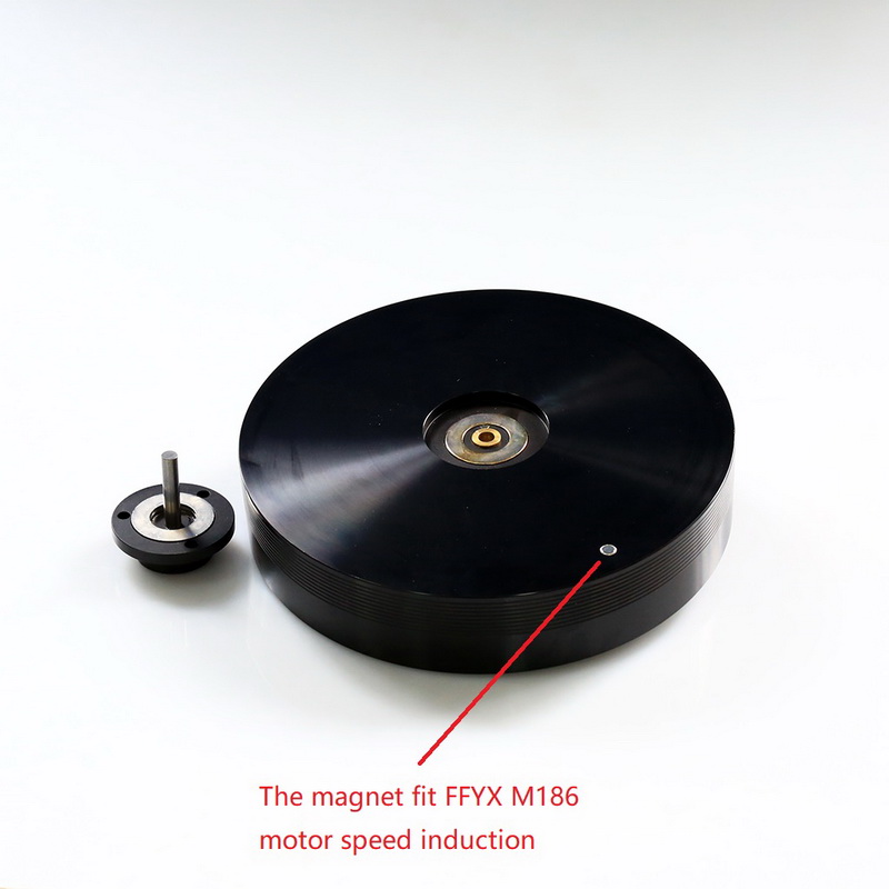

So, i've decided to build my secound diy turntable. The first one was good and taught me alot. This one will have a 12kg, 2" thick aluminum platter with a maglev bearing. To spin the platter i'll use a Jasmin motor, both available from china. I have settled on a Dynavector xx2MkII cartridge. The plinch will be made from four layers of 3/4" baltic birch plywood. For the tone arm i was considering the SME 309 or the Jelco TK 850. I know the SME is twice the price of the Jelco. Is the SME really that much better? Am i crazy to put a $2K cartridge on a $1k tonearm like the Jelco. Any thoughts on this would be greatly appreciated

That bearing looks pretty suspect. The arrow refers to a tiny button magnet and the model number for a free-standing motor. Doesn't make any sense. The bearing surface does not look like a precision set up.
Do you know anybody that has used this bearing? I see no reviews for it anywhere.

bbftx,
The button magnet is used with a hall effect sensor for motor speed feedback control. It is for there propiatary motor that i am not intending to use. And yes i do know someone that has used this motor/platter bearing setup. His name is Troles Gravison of Denmark. He is a very prominent speaker designer employed by Jantzen Audio. Ckeck out his DIY site. I have built one of the speaker kits he designed. The Jensen 1071.

Thanks, Gary, Troels' Mag-Lev build is intriguing --- I really enjoyed reading and seeing what he's done. I love dual arm setups.
