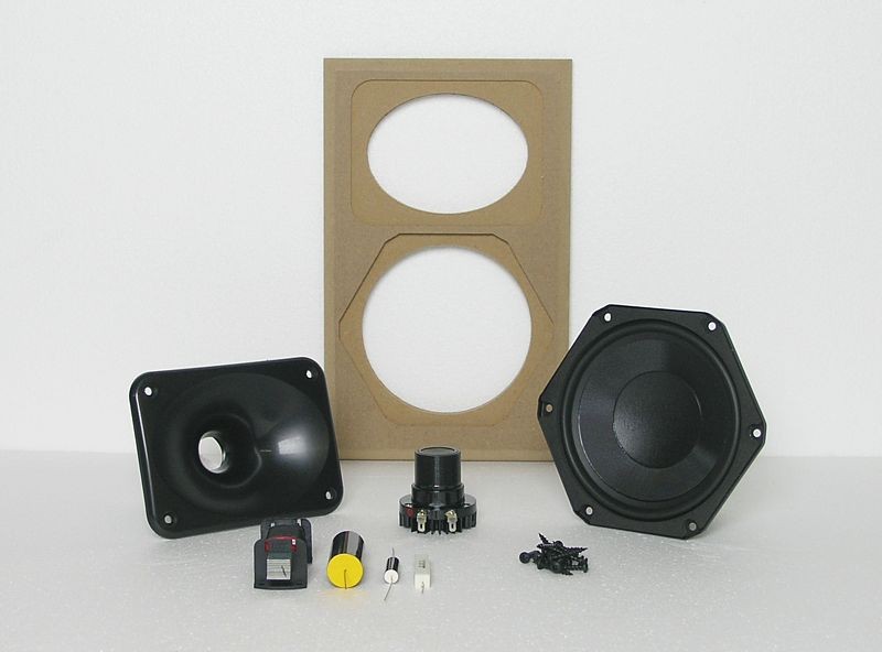

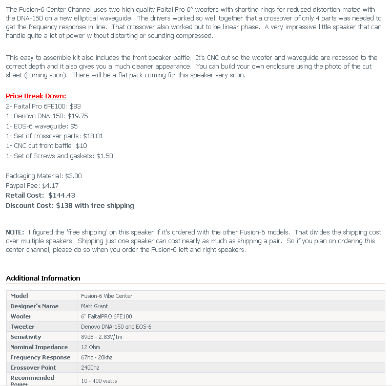

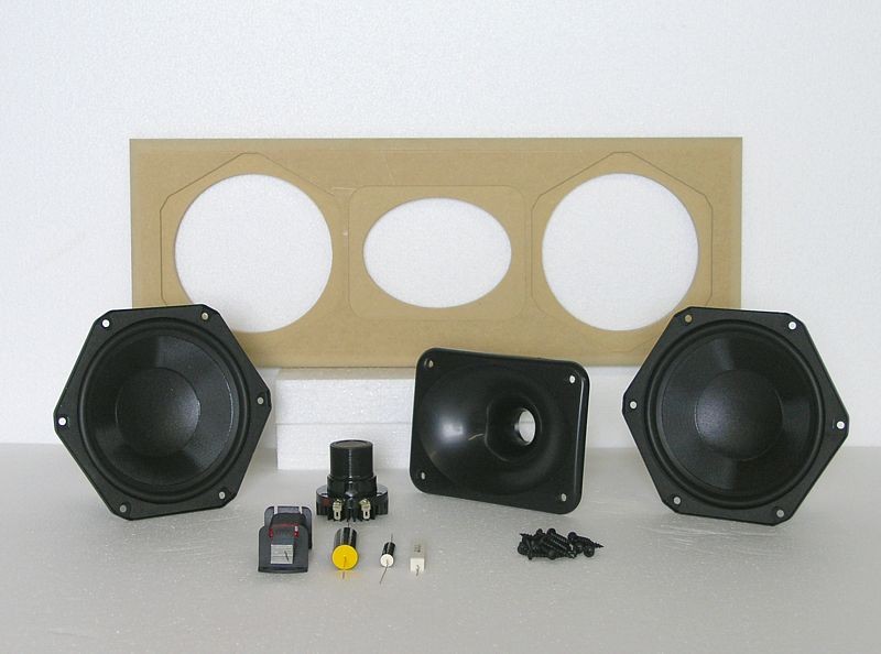

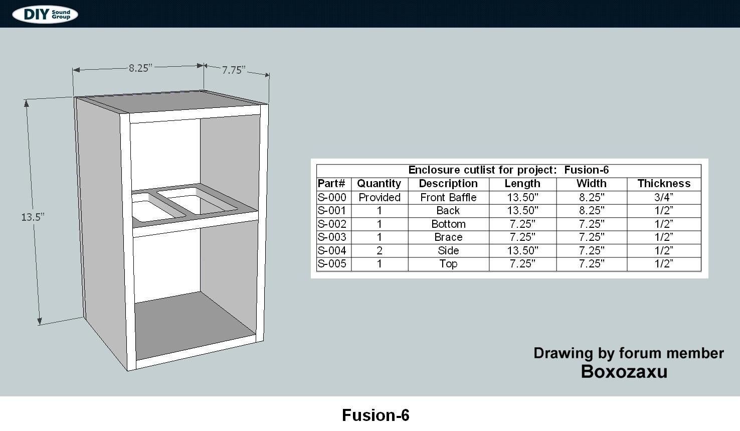

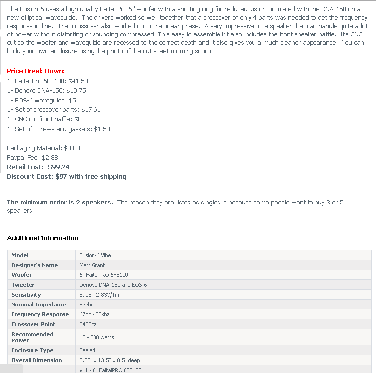

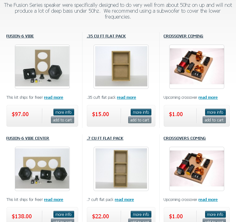

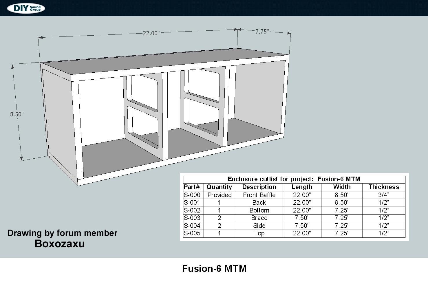

Have you forgotten ( or ruled-out ) DIYSG's long retired Fusion-6 "VIBE" ??
I really thought that Matt Grant did a bang-up job on that little guy.
From what I see the "VIBE" is able to fulfill all your criteria ( ultimately bass extension would be governed by box size and tuning ) .
For review ( and archiving purposes ) here are a bunch of 6 year-old screen grabs.
While the EOS-6 horn and that little dna-150 driver are NLA, there are just as capable small drivers and small waveguides available.
You might want to contact Erich to see if he still has any of these parts that he'd like to sell.

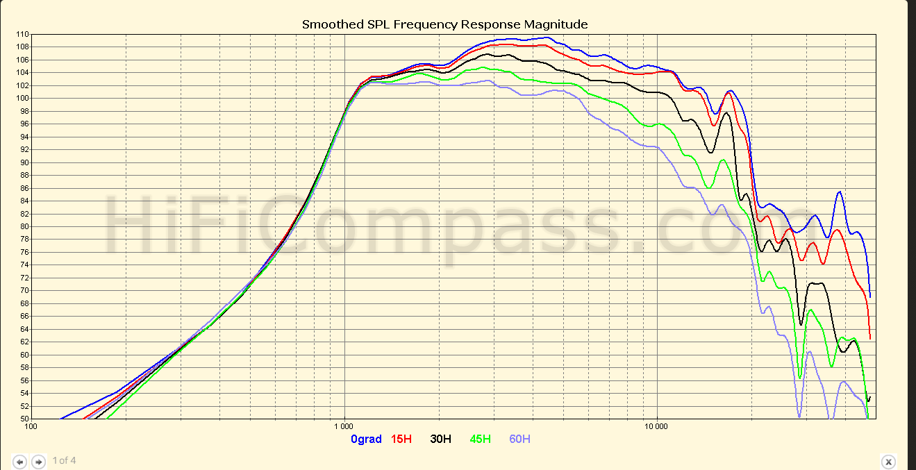

If not, the B&C ME10 horn driven by a Peerless dfm2535 compression driver would be my first choice to use in a redesign ( it's a more than capable substitute and has a nice well damped 35mm titanium diaphragm ).
FaitalPro 6Fe100-8
FWIW, I see your budget as being doable.
I might even suggest doubling the woofer count ( for the L,C,R's ) into a TMM arrangement and finding a slightly larger waveguide for use ( such as the EOS-8 or similar ).
HiFiCompass de10 on ME10 measurements has done a nice workup of measurements on this driver/horn combo.
This horn shows surprising good directivity ( down to 2.5K ).
