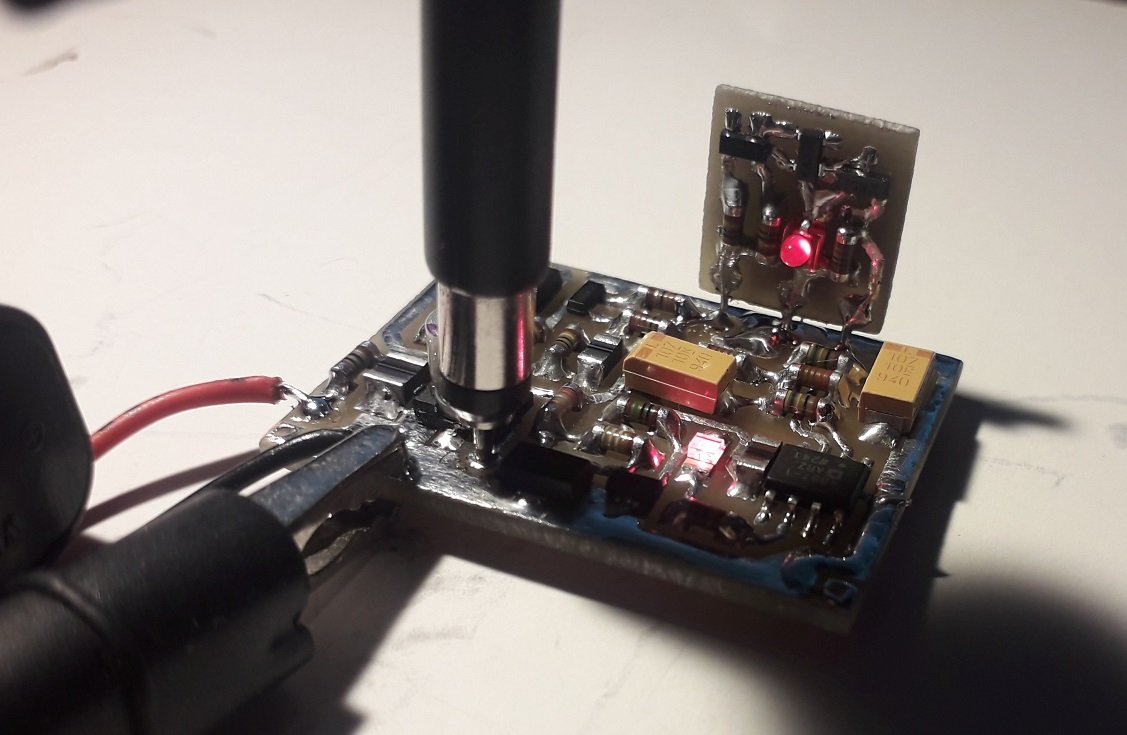

Well, I did some tests with very small loads, say DIR9001 whose current does not exceed 10mA. For that battle I used ADP7118, ADM7150 and Walt's shunt set to about 60mA. The shunt is completely SMD with a total dissipation of about 300mW which is not much at all.Then it happened to me for the first time that in the power supply with a digital scope I saw a straight line, a clean DC signal, completely clean, I could not believe it, I checked the scope, the probe but I could not see any high frequency artifacts specific to digital circuits.
That is another story ofcourse - because in that case regulator supplies more current device + shunt.
And should be compare what working better in sonic terms and measurements.
(Essential for the shunt reg is to find very low esr C at the output. to keep shunt very low impedance power source.)
But the Circuit for reference voltage (with AD797) does very good job. Also super clean I tried with another ESS ES9008 dac long time ago.
