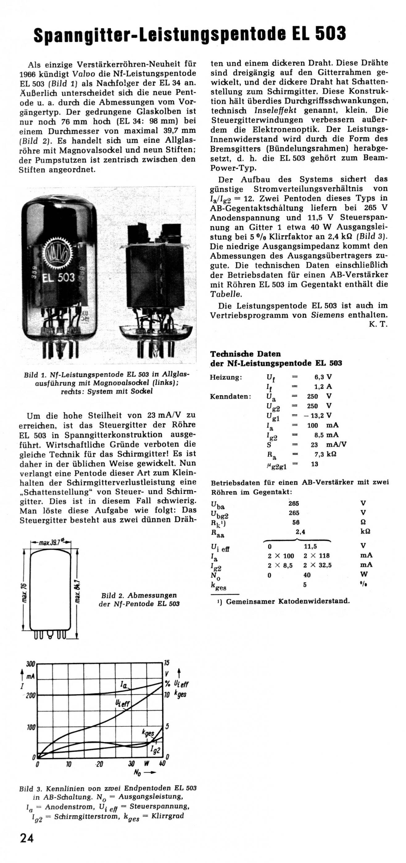

I attach the original 1966 press release of the EL503 tube, from Funkschau (I believe). It is in german, I never found a english translation. It goes on lengt about the unique grid arrangement. This tube has always been expensive, I remember that price for a spare tube was about the same as a BW CRT. Many amplifiers were discarded early, still in good conditions, because a new solid state amplifier was cheaper than worn tubes replacement. Tubes were outdated things at the time, no one was thinking to modify the amplifier to use EL36 or EL34. I guess that a viable approach for a new build today would be to keep the tube way below the maximum ratings, and to basically plan to never replace it. I guess that triode curves would be very linear. This tube is a interesting glimpse of what could have been the evolution of the technology, if semiconductors would not have been developed. Hard to explain why Valvo invested what must have been a significant amount of resources to perfect a product that clearly had no future.

Here is some write up about the EL503/EL520 tube. (English Google translate option )
Die EL503 - Story
One thing I see is a frame grid for grid 1 and an ordinary grid for grid 2. This means no aligned grids to lower screen current (and screen current distortion).
You can see the resulting curvature in the individual plate curves on the EL503 datasheet. Obviously it is not a kinkless audio tube design either. The Mazda Belvu datasheet curves (below) have max diss. hyperbolas on them. Most any loadline will be near high distortion kinks. A mystery as to why someone would want to bring this tube back into production for audio. I would recommend getting some triode curves for the EL503 before going SE. Frame grid 1 is no guarantee of good triode curves.

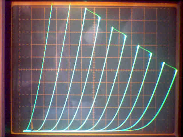

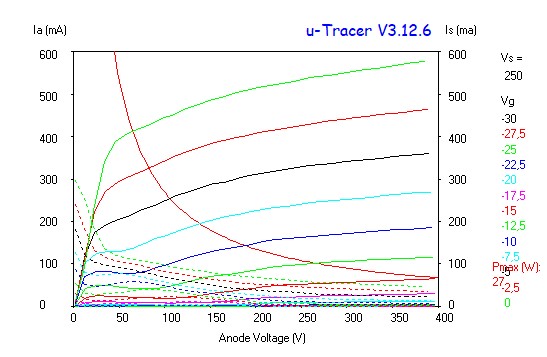

Single ended triode mode seems to be nice according to my preliminary tests, but I lack a curve tracer so I only made a few quick distortion measurements on random working points.
Due to the very high transconductance, EL503 can also work as low power triode SPUD. 200V on the plate+grid (Recom R12-150B dc/dc converter); 390 ohms bypassed cathode resistor (anode current will be 30-33mA); 1K grid stopper resistor on g1 and/or VK200 in series to the anode to avoid oscillations; 1200 ohms load such as 230/16V or 230V/12V 20VA toroidal power transformer (RS components part number 671-9053 or bigger). Lots of fun with a handful of parts. For better and more thought out outcomes, triode curves would be needed.
Hmm, triode curves look about like a 6L6GC except higher Mu. Not bad, but not great either. About typical for most later beam pentodes, optimised for gm. My first guess for a linear load line was 4000 Ohm, but that is more than the typical 5X Ri, and would only produce a few Watts. (Ri 565 Ohm at 100 mA, so 5X Ri = 2826 Ohm)

Thanks for the EL503 triode curves, I believe that they haven't been published anywhere until now. To get a rough extimate for a design, my reference was the 8417 triode curve because the two tubes have some similarities, but the EL503 real curves shows a higher mu and have a slightly different shape.
The smoking-amp considerations are true, this oddball tube does not fit well the Hi-Fi parameters, when driven at the rated power. This may also explain why it mostly powered guitar and PA amplifiers. On the wast majority of said amplifiers, it was actually driven way harder than the maximum datasheet values, usually at 400V or more. The massive anode structure and thick glass envelope does suggest that the design target was higher, but probably the distortion level was so horrible that Valvo did not dared to publish it at a time when 2N3055 designs were starting to come on the market.
A tube that can develop a significant power into a easy low impedence load with only a few volts on the grid is still not a common sight. Maybe a way to use it on SE Hi-Fi applications is to just run at low level. I see a few regions on the triode curves that seems to be fairly linear. It would maybe possible to get about 4W at low distortion, just like many small triode wired pentodes, but with a lower gain voltage amplification stage (maybe only a step-up transformer) and 1200 ohms load. I will probably give a try. Filament current draw is reasonable, so nothing seems to be critical or out of proportion.

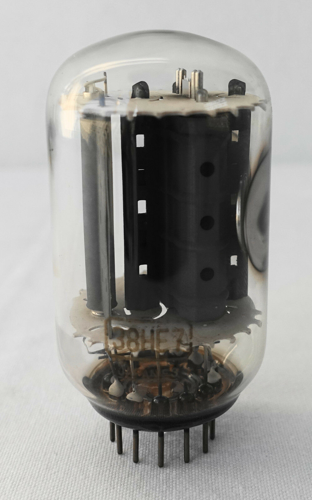

Oh, another tube that makes a pretty good 15 Watt triode is the 38HE7 Beam pentode/damper diode. On many (but not all) 38HE7 tubes, one can run just the pentode alone by putting 21V Htr (0.45 Amp) on pins 10 and 12. That drops out about 10 Watts of heat from the bottle, so the pentode can be uprated to 15 Watt readily (a big plate). Were on the famous $1 list once. ( have seen them in quantity for $0.35 ) Use UnSET with it and you can equal the 45.
pics: 38HE7 (triode mode)

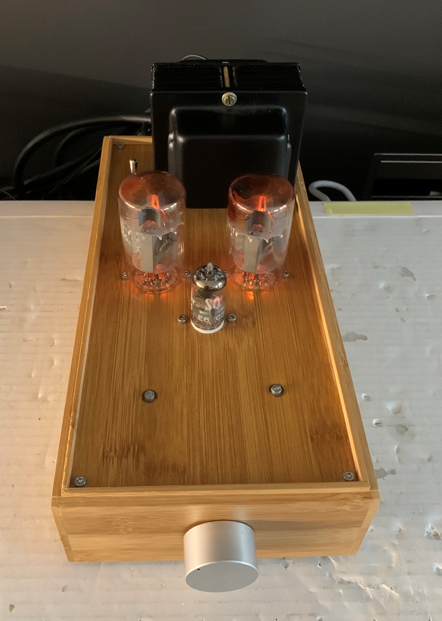

Testing the triode wired EL503 on a single ended setup has been surprisingly quick and easy. This amplifier is obviously not meant to be "done right" on a tecnical standpoint. As smoking-amp noticed on post #8, a conventional build with this tube does have no sense today. My goal was to build a fun amplifier with the parts I already had, exploiting the EL503 peculiarities: high mu, high cathode emission with only 1A filament draw, and 27W anode dissipation on a glass envelope about the same size of a 6V6GT. Triode curve shape suggests that 3K or maybe 5K anode load would give less distortion and better sound quality than the datasheet value of 1200 ohms, but it was not the case on my tests with a 6 ohms speaker. A 230v to 16V 20VA toroidal power transformer outperformed a much bigger 40W 250mA Toroidy Hi-Fi single ended transformer with 3K primary. This is my subjective evaluation, I have not done a measurement. I also tried several toroidal power transformers before settling for this one; most of them had a severely limited bandwith. To avoid saturation of the ungapped output transformer and to keep the tube cold to extend life, I selected a quite unconventional 150V 50mA working point. Mu is so high that if sub-watt performance is enough (headphone amplifier, desktop computer speakers), or if a high-output preamplifier is available, the EL503 can run as SPUD amplifier without preamplifier tube. I have 86dB speakers so I added a E88CC gain stage. This also enables the addition of global feedback, if desired. Power supply is very simple: the cheapest 20VA 6.3V filament transformer from the RS components catalog, and a standard small 55+55V control transformer to get 150V DC at 100mA. A insulation transformer would work just fine. I fitted on this amplifier two matched but worn EL503s that have 80% emission and almost no getter left. It sounds surprisingly well. The 100 ohm dropping resistor on the CRC power supply filter could be increased in value and dissipation if a 100dB+/1m speaker is connected. With my speakers, I barely hear a extremely faint hum at 1cm from the woofer.
