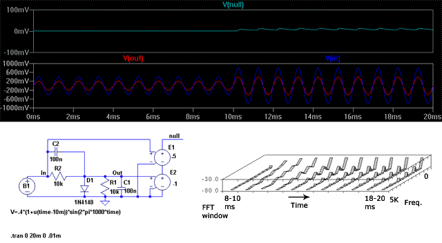

Null test results.
I snatched some time last weekend to explore the idea of a frequency / time domain null test in an actual situation.
To that end, the simple circuit shown below was analyzed, results are also included and the full simulation and worksheet files are zipped in a subsequent post.
The circuit consists of a compensated attenuator where a mild nonlinearity has been added by the way of a diode. The capacitance was included to stimulate a reasonable transient condition.
The stimulus consists of 10 mS of 1KHz tone with an amplitude below the diode threshold, continued coherently with the same signal but twice the amplitude so as to put the diode slightly into conduction. I included the controlled voltage sources to ease the repetitive plotting of the null signal 0.5*V(in)-V(out).
The lower plot panel displays the input and output waveforms, while the upper one depicts the null signal. Note the null signal plot scale is 10 times more sensitive than the input and output signal scale.
The waterfall diagram at lower right was constructed by export of FFT plots of the null signal, using a sliding window of 2 mS aperture from 8-10 mS to 18-20 mS.

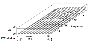

In the next post, the same null waveform is treated in the same manner, but in this case the sliding FFT window aperture is set to 10 mS bringing frequency resolution from 500 Hz to 100 Hz. Selecting the FFT aperture involves a tradeoff between frequency domain resolution and time domain resolution. A larger one will provide better frequency resolution at the expense of averaging for longer times, thus smearing short term variations while the converse is true for a shorter one.
Interestingly this very constraint adds a further control parameter for analysis, for since we are after all looking for objective measurements that could correlate with the listening experience, and the ear in turn is in essence a spectrally sensitive instrument, the possibility to balance time and frequency resolution may well be an added bonus.
Null test files
Schematic file for null test, stimulus, and Excel worksheet. The procedure was to export each FFT result and import data in the worksheet, plotting the results.
This approach obviously is only a rough and fast method suitable for processing a very small dataset. I did not want to plunge directly to programming in MathCad to automate the whole process with arbitrarily large datasets before testing a sample case.
Comments, critique, suggestions welcome.

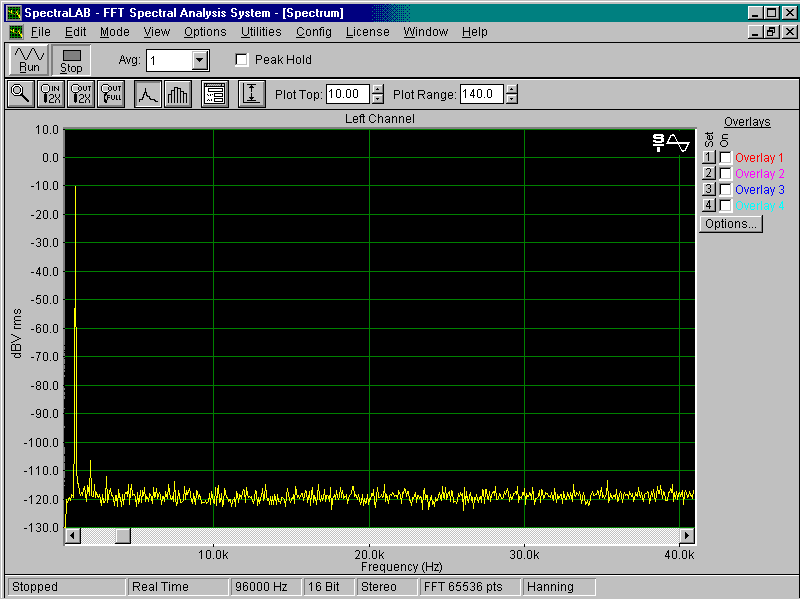

I have promised to show the THD spectrum result of the error correction power amp. So here it is, measured at 1kHz, 1dB below limitation, 8 Ohm load. With AD797 chip. Signal from CD generator and it is the CD that contributes greatly to final distortion. Not too bad 😉 . Now compare with FM method results. What is more severe? 😉 😉
