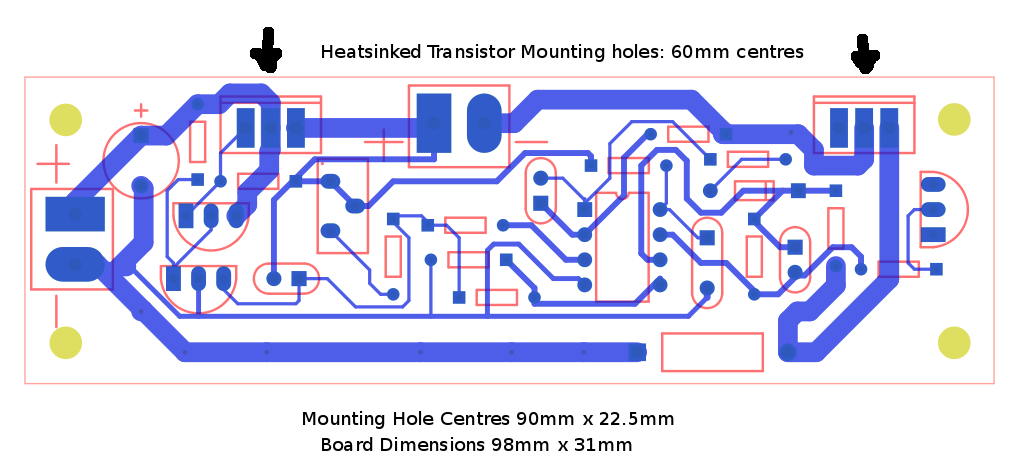

Board is ready to go out...
The picture shows the hole positions, layout and dimensions.
There's two TO220 transistors (isolated type) to mount to an external heatsink, with hole centres on 60mm.
Board is 98 x 31mm (about 4" x 1.25").
How does this layout fit with chassis layouts out there?

Size looks good to me, Rod.
But it seems to me like you forgot some tracks? The rightmost TO220 have a loose pad, and the rightmost TO92 has two loose pads. An error or is it intentional?

Hi Rod,
I see there is place for either input or output connectors between the two TO220s. If they are going to be on one heatsink, this will be very much in the way, won't it?

Yes, the filament output connector is there in the middle.
The holes can accommodate the screw-terminal type connectors, or can just solder to the holes directly.
The plan was to face the connector away from the heatsink, and since there's only some 0.25W resistors in that neighbourhood, the wires should dress over them OK, I think.

Regal, the measurements show 1mV or less across the filament, and even less between filament and Ground - provided you have a filament power transformer with low capacitance to ground.
A split-bobbin trafo really helps, or you can use an isolation transformer (power tool yellow trafo) if you have extremist attitude.
Either way, this should be the quietest way to heat, outside of wet-cell lead-acid battery power. (Gel cells are very noisy). Batteries present a low ac-impedance across the filament, which kills the sound.
Need to get other sources of hum out of it too, but this heater should be a big step up from ac- or voltage-regulated dc.
