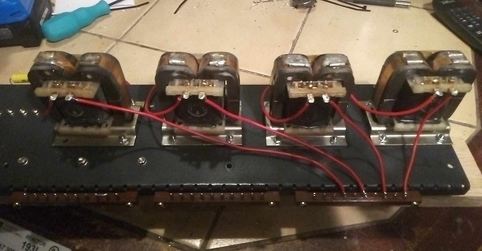

I grew tired of banging my head against the wall with the Hammond chokes and decided to have a look at some alternatives. Luckily I'm a bit of a hoarder so I had six double C core chokes taken from scrapped wire electric discharge machines. Smaller than the Hammonds but with almost twice the inductance and twice the Dcr. Quite surprisingly, four of them handled 18VAC in my test rig without making any audible noise, the last two buzzed very quietly.

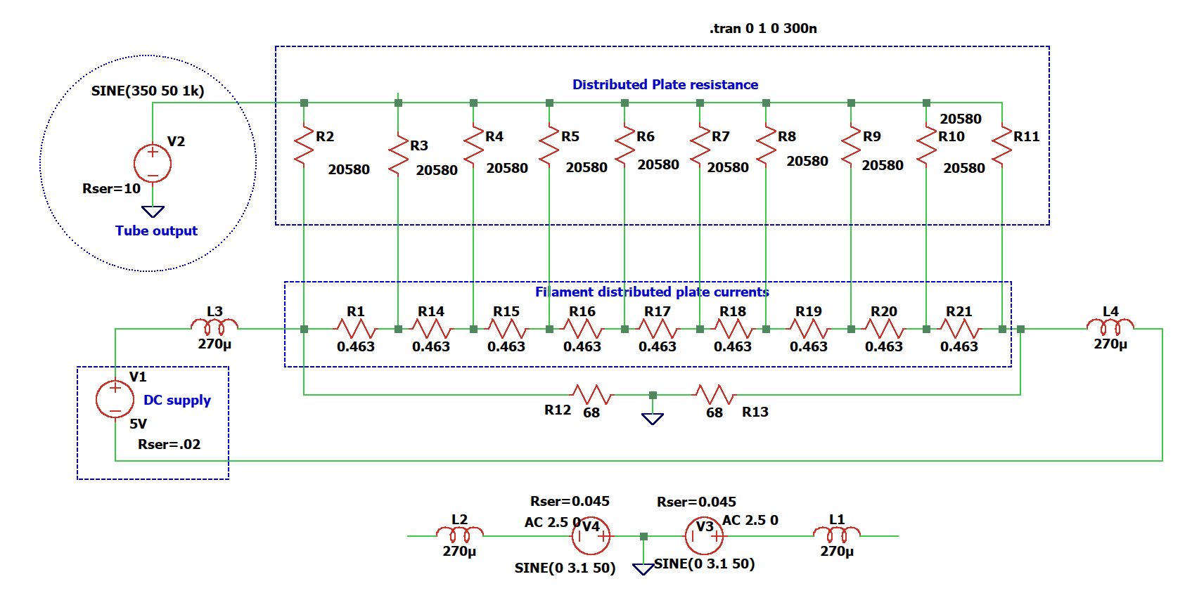

A basic look at feeding DHT heater with an AC transformer, with a center tap to ground, would present both terminals of the DHT with equal inductance and AC voltage. (This is normally done with DHT for grounded grid RF amplifiers, where the grid provides isolation between in and out and reduces chances for unwanted feedback.)
The issue with AC on audio filament is the audible frequency of the heater voltage, and hum-bucking may not be perfect.
The Signal Voltage of the filament end should be proportional to the frequency dependent reactive impedance of the heater windings, plus others, and any Signal Voltage which would be in phase with the plate current would provide some negative feedback. Mixing mains heater frequency with audio signals would incur a high probability of intermodulation products, F1+F2, F1-F2 etc. Not an issue with DC. Adding said "bonus" inductance to the DC feed would allow similar (frequency dependent) negative feedback. How much inductance?
I grabbed a 60Hz transformer from my junk pile with a 5V 2A winding measures 580uH / 0.25 Ohm at 100Hz, 0.69 Ohm at 1KHz, 24.3 Ohm at 10KHz. If it had a center-tap, those values would be half.
This would suggest more negative feedback at the higher frequencies.
Is this where the magic happens?
Rather than struggling with an AC supply, or a Fancy DC supply, why not add those inductance values, or similar, to the output of a DC supply? Using a resistor splitter would additionally even the Plate current distribution over the filament, and provide a flat frequency negative feedback to whatever value is desired, using two resistors.
Then the DC filament supply output should not be connected to ground.
Inductors are added to the the DC output, both + and -. Something like the M1439-ND could work.
This would additionally also reduce some noise from the output of the DC supply. .
Even a power line filter of the AC-inlet type could work for the DC filament supply.
I'm sure this has been tried before...

Yes, I 've seen some hardcore DIY:ers using big inductors to isolate the filaments from the DC supplies. I used LCLCL filters in my old 6B4G SET, something like 20mH-22000uF-20mH-44000uF-112mH if I remember correctly. Might try something like that again when I build the prototype for my upcoming 300B SET, it would be interesting to compare it against Rods regulators.
Lundahl makes chokes with dual windings that can be arranged to filter both differential and common mode signals, they should be ideal for something like this.
The inductors in my simulation are small, ~ 0.3mH. The effect of inductance in a DHT AC filament power transformer is minimal, but maybe important. Using resistors across the heater gives more, or less, of feedback, compared to above. Two inductors, two resistors. Simple.
Not to say a constant current-like supply would not offer more feedback, if that would be a desirable, from its higher impedance. May be worth investigating.

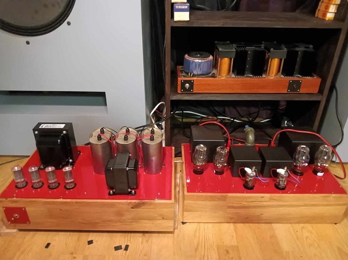

Good to know, I just ran a test on my PSU after replacing the chokes and guess what...? It's buzzing. Something is wrong here, I tested each of these chokes less than 24 hours up to 18VAC and they were all fine, no buzzing or noises. The tests were made with a transformer with a single secondary winding and a bridge rectifier while the real filament transformers have 14-0-14V secondaries FWCT-rectified by dual schottky diodes.
I guess it's either a problem with the proximity between the filament transformers and the chokes or that my FWCT rectifiers somehow behaves different than the bridge recifier and causes ringings.
Perhaps the next logical step is to disconnect three out of four filament supplies and experiment with different rectifier arrangements on the fourth one to see if that makes any difference. Luckily it should be easy now after rearranging the wiring quite a bit and the transformers have dual secondaries that can be wired in series or parallel. Wish me luck, stopped being funny a while ago...
Nope, wasn't that... Disconnected three out of four supplies and temporarily replaced the Schottkys with generic silicon diodes: No change. Connected transformer 1 to choke 4 to see if creating some distance between the core would help. It didn't, but I learned that both the transformer and the choke contributes a bit to the noise. Easier to locate sounds when the sources are 20+ centimeters apart. At last I used only one secondary winding to feed a bridge rectifier instead of the FWCT arrangement. You guessed it: No change.
I'm running out of realistic ideas here again. Filling the whole chassis with epoxy or resorting to black magic are not realistic ideas, at least not yet...

Yes, I've thought about that too. Would be worth a try. Adding resistors in series with the secondaries seems to help at least to some degree, I will experiment further with that. I've thought about putting the rubber dampers back under the transformers too but they didn't help much the first time and they were a bit too soft, allowing the transformers to move around too much inside the chassis and thus potentially causing safety issues.
I guess I have to draw a line somewhere too about how picky I can allow myself to be in this matter. The new chokes are at least less noisy than the Hammonds and if it can be improved further with resistors in series with the secondaries then perhaps I can live with it. A DC trap on the input could perhaps helt a bit more with the noise from the transformers.
The only realistic way I can think of to get things completely silent with the existing chokes and transformers would probably be to decrease the voltage drastically with a bucking transformer and add big electrolytics directly after the rectifiers. Quite an ugly hack though...
Last test for tonight: I wired up a bucking autoformer to lower the input voltage to 160VAC. Even at this voltage both the filament transformers and the input chokes are still buzzing very slightly. Bypassing the input chokes with clip leads to get CLC filters instead of LCLC produces 11Vdc into 10 ohm dummy loads.
Don't ask me how the chokes could handle 18VAC without complaining yesterday but for one reason or another everything goes south as soon as the parts gets inside the chassis. I guess removing the chokes and installing the bucking transformer would make a decent semi-permament solution until I can build something with better parts in a separate chassis.
I finally got everything back together and working, but I'm far from happy with the changes I had to do to make it work and the PSU is a mess on the inside.
There will be a complete remake with better iron and a better internal layout in the future.
Still a bit noisy noisy but not too bad. The amp itself sounds marvellous so it deserves better filament supplies, but I need to save up some money first.

What I did was to remove the input chokes, move the filament transformer from the metal sub chassis and screwed them to the oak frame for better mechanical damping, replaced the dual Schottkys with bridge rectifiers...and lowered the input voltate from 230V to 100V with an isolation transformer. Not exactly an elegant solution and the filament transformers run much hotter now as they are misused as 100/12V transformers with high Dcr but it works.

Ok, I'll stop badmouthing the Hammonds but I have some experience of noisy transformers and the noise from these sounded more like rattling windings or loose laminations rather than the "duller" sound from core vibrations caused by magnetostriction. The latter can usually be cured easily by installing the transformer on rubber dampers but that didn't help much here.
I have a pair of monoblocks that uses 60+ years old transformers from Philips PA amps, they vibrate quite a bit on their own but thanks to the rubber dampers there is no noise to be heard from the chassis. Same thing with the large Hammond 370LX HV transformer I'm using in this amp, the dampers do their job perfectly well there.
I noticed one curious thing with the filament transformers: There are traces of some kind of varnish on the cores and the clamps but the bobbins and the visible parts of the windings looked "dry".
