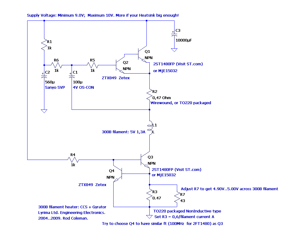

On the positive side (T1 - Q1) Is only a ripple smoother - it drops about 2V or so and rejects noise. It's more like a voltage source (at dc) than a current source.
On the negative side T2 - T3 is the current source which is adjusted to make the right voltage appear across the filament.
The interesting thing about the Sovtek is the big difference between ac and current source heating. It's so noisy and bad sounding on ac - but sounds wonderful using the circuit in post #35.
The construction of the old Sovtek 300B uses a very thin filament, which at least partly accounts for the bad sound and microphony
If you're using Sovtek or another cheap DHT with ac heating, you owe it to yourself to try current-driven heat! Get Guido's heater supply, or, if you're transistor-competent, build your own design! It's much cheaper than upgrading to fancy 300Bs and probably just as good.

How about another circuit idea for Push-Pull DHT amps like the Lynn Olson AMITY etc. (Idea ONLY so far - I don't have an AMITY yet, sadly):
Most of the circuit shown in post #35 of this thread can be kept as-is, but with the two push pull valves each having their own return circuit (current sink). That way the two valves can have different voltages (to cover production tolerances):
2 x 2A filaments, like the KR300BXLS can be accommodated easily with this circuit. If the transistors are MJL1302A (PNP) and MJL3281 (NPN) - AND mounted on heatsinks of 2~4 deg C/W you can even have shorted filament protection! What's more you can have one filament shorted and the other will carry on working normally, avoiding the risk of cathode stripping in the good valve. Just be aware this means ONLY that the filament is shorted; I don't mean you can short the positive side to the raw supply return. Bypassing the current sink part of the circuit will vanish the safety feature. But if you properly insulate the return node you should be protected against all reasonably likely faults.
Be sure you can cope with the stability test and thermal ratings design/test as noted in post #35 if you attempt to build this circuit; you could burn up your DHTs if you don't check & burn in thoroughly.

Konnichiwa,
This one has been among the dead for a while, time to voodoo it back among the living.
Over the recent times I have been thinking to and fro how one might achieve similar effects to Guido's circuit, preferably short circuit protected, simple and with as few parts and 3-legged fuses as possible. The following Circuit is what I came up with, it SHOULD work (P-Spice says it does) but I have not specifically build it (yet), so beware....
The idea is to make a Circuit that is a high impedance at AC. We already know the "simple" LM1085 Curret Source seems to work fine sonically, but when supplying normal DHT's you need to re-adjust it as valves age and when you change Valves, far from ideal.
In my circuit the 1mH Choke (around 0.5R DCR) together with the 1,000uF Capacitor in effect establishes an AC Current Source where the transconductance of the 3-Pin Regulator in effect amplifies the impedance of the 1mH Choke. The 1,000uF Capacitor together with the 1K resistor between adj and out froms a highpass at 0.16Hz so at DC the whole thing will slowly turn bacvk to a low DCR resistance source.
In order to set the Output voltage accuratly a LM/TL431 is used, here the output voltage would be 5V. In order to stop the LM431 from "regulating away" our nice high output impedance the lower part of the voltage divider which stes the output voltage is bypassed (1st Order LPF at 0.03Hz), thus making sure that audio frequencies the impedance remains high. In the audio range the impedance is limited by the 10K unbypassed resistor in the voltage sensecircuit.
Added to this is a simple common mode filter and Schottky Rectifier Bridge, basically "best practice" for DHT Heater DC Supplies, lest you like to use Thyratron or high current mercury vapour rectifiers like this dude here:
300B SE Amp with 101D Driver, 300B Rectifier and 314A rectified heater supplies....
As usual comments etc welcome.

Wang san, sumimasen!
Sure its worth raising this one again, its a dinner-money upgrade with far more impact than a mortgage-busting pile of boutique glassware, dielectricware or even old fashioned ironware!
I accept that you're going to have some adjusting to do when you only have a current loop controlling heater power. I did think about adding a voltage loop - with multiple-pole cutoff <1Hz - but decided I don't need it. The heater voltage with the gyrator/transistor current source shown above is plenty stable enough (over the few hundred hours I've run it), and can easily be made adjustable with a low power 20 ohm fixed in series with a 100 ohm/10T trimmer (all across the sense resistor).
I found it worthwhile to spend time finetuning the circuits in both heater terminals - I would certainly recommend testing your circuit with an effective ac break between the rectifier -ve and -F. In that position I like a PNP darlington gyrator formed with FZT1151A (Zetex, superbeta) and a PNP power transistor (smallest you can get which satisfies your safety margin). The specified Cob of the PNPs is what counts (35pF = good; >130pF = bad). The reason for the obsession is (as you know) the -ve current pulses that form the rectifier noise - with plenty of energy >100MHz.
General observation: With 3-terminal regs the multiple internal circuit paths from IN (& ADJ) to OUT risk degrading the insertion loss as frequency gets really high. So, in your circuit, watch out for the ac path from +F through the 1000uF into ADJ!
clic the pic - Easy to build circuit on plain copperclad board (hacksawed pattern) with SMD parts - (2512 cathode resistors, FZT1051A/2SD2061 gyrator, FZT1051A/2SC5511 current source with R47 R56 shunted sense resistors, SANYO 560/10 SVP (20mOhm ESR) caps.....

Konnichiwa,
Absolutely.
Yes, I had exactly that issue with my simple LM1085 CCS, which I had enhanced with the addition of a little choke (a few mH, small size) and a common mode choke.
In fact, this very simple supply:
Schottky Bridge
10,000uF
2.2mH/2A
LM1085 CCS
CMC Filter
actually sounded as good as ANY other heater supply I have been using so far, including serious choke filtered stuff, but it was too hasslesome when conducting for example comparison tests with 6 or 7 different 300B's.....
I have noticed your circuits previously (nice work actually), but they have no protection against overload. As I tend tend to tinker a lot I consider such mandatory. Any circuit that cannot survive the slip of a screwdriver or a 'scope probe is not to my liking.... I get to angry with myself if I have to swap out all the blown threelegged fuses each time....
Thanks, good one. I did wonder what it was (I showed up in the P-Spice simualtion) but I figured it would still "do". The solution is of course simple, add another resistor (1K) between the adj pin and the junction where the 1,000uF Cap, LM431 cathode and 1K resistor join.
My main idea was at any extend to come up with something that offered reasonable performance and mainly "aparent" simplicity (eg. simplicity in implementation, all the complexity is hidden inside the LM1085 & LM431).
I could have used a discrete pass transistor instead of the LM1085, but the 1085 makes a nice enough pass transistor with build in SOAR protection....
I might consider adding a second "electronic choke" in the negative Line as well, may be worth it....
One might also build a more or less functional equivalent using LM1085's as current sinks and as Filters, with short circuit and overheat protection.... Performance at HF would be worse of course, all a matter of design goals, still, very nice job on this.

Konban-wa Wang san
Don't let shortcircuit worries hold you back, if you're considering a discrete heater circuit. Provided the sense resistor is protected (use two series parts so the end-to-end gap exceeds a "pliers-span") you are OK. If you short across F+/F- the current stays at 1,3A - so the currentsource transistor's dissipation rises to ~10W (for ~9V raw input) - fine for TO220 types mounted on <10 deg. C/W. In the gyrator side nothing happens!
If that's still not tough enough, you could try some Raychem Polyswitches next time you're at Rapid - e.g. type RGE300
http://www.rapidelectronics.co.uk/r...CAT_CODE=30279&STK_PROD_CODE=M31870&XPAGENO=1
As for whether the gyrator contributes greatly to the improved sound, I suspect that varies with the leakage capacitance (through the filament transformer) back to the "B-" terminal of the rig in question. Big leakage = current path for diode recovery pulses.
Thanks for your kind words on my heater posts; they boost my enthusiasm for "converting" some of the ac-heated DHT designs out there. It's the only change I can remember getting unreserved plaudits from my "expert witness" listener - sings in the wonderful Armonico Consort http://www.armonico.org.uk/
Especially for those that have the lower cost/quality DHTs, if you're on ac-heat now, find out what you're missing!

5-yearly update!
I have had requests for more information on the filament circuit across the five years it has been up here.
Mostly, component questions - It seems that all of the transistors listed are no longer obtainable.
And the circuit published changed a little, in order to use a regular darlington configuration for the gyrator section.
So here's a suggested circuit and parts data for anyone wanting to build today. The ST 2FT1480 is a new part, but has the desirable high ft of 100MHz. I would like to specify a nice TO-220 isolated package NPN with 100M+ for ft, and when I find one I'll try it. Meantime the MJE15032 should work OK, but in the current sink section Q3/Q4, be sure the pair don't oscillate. Hold an AM radio close to it if you don't have a scope. Using the MJ for both Q3 and Q4 may fix the problem if it occurs. In any case, keep the wiring for the current sink as SHORT as possible, especially keeping the base resistors close to the transistors.
The bootstrap circuit C1/R5/R2 is optional. It raises the impedance seen at the gyrator's base, and aims to reduce ripple. Easy to try, but build without it at first!
Be sure to use a heatsink for the power transistors!
