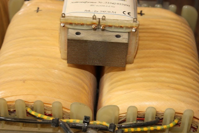

split bobbin means that primary and secondary aren't on top of each other ;
oh, I thought they were 'just' double secondaries, and double primaries 😕
hmm, R-core are airgapped like a double C-core, or 'laminated' ?
another variation could be UI core

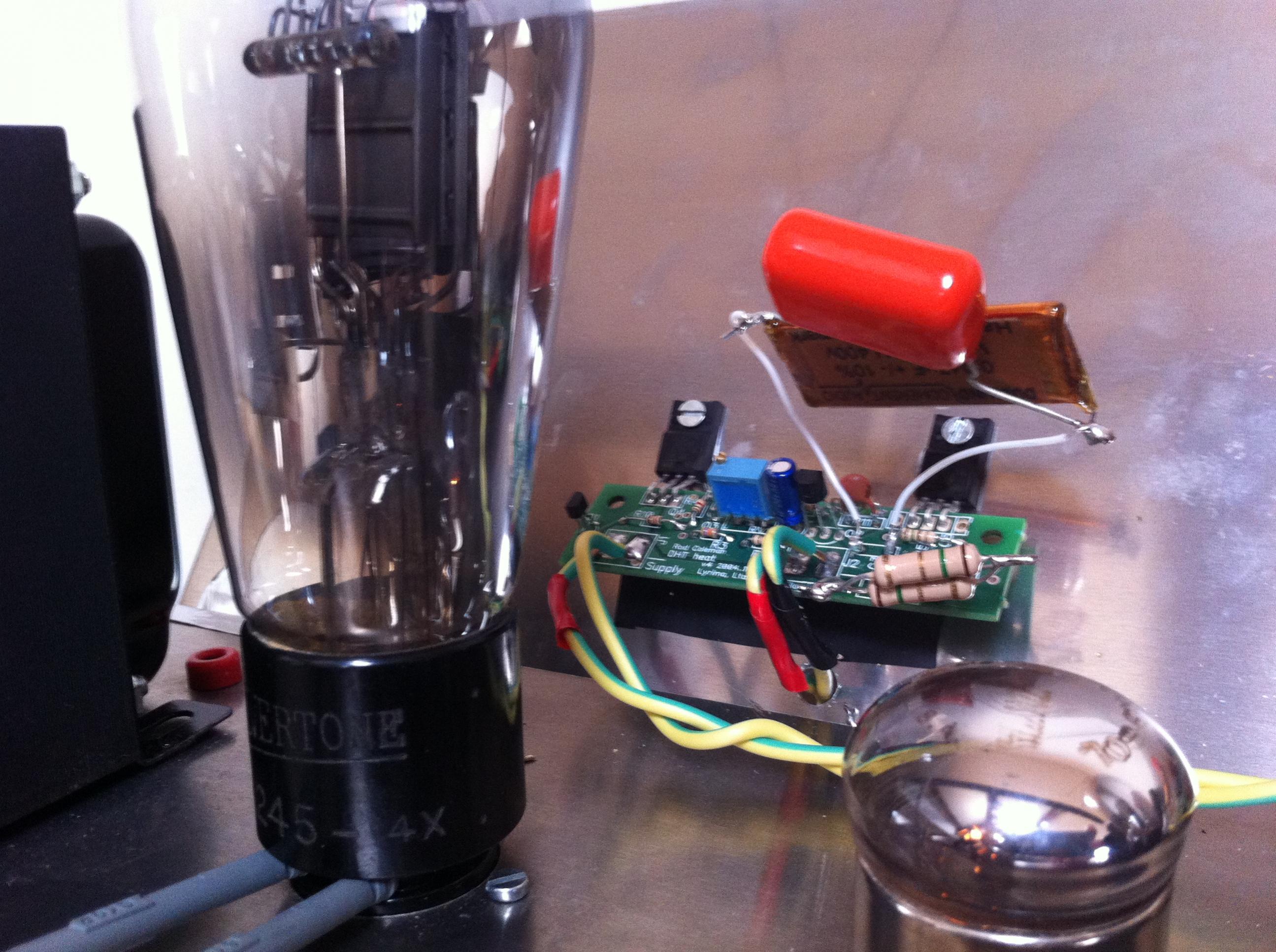

Hi Rod... I am using your filament supply now with my 45 DHT: that's clearly an improvement over AC supply...

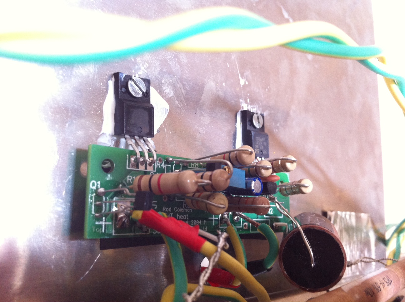

I agree also with Petavgeris : the plastic 220 nF capacitor is a dead end, a good capacitor (I use MKP sprague orange drop) is clearly an improvement . Replacement of R1 by two cheap carbon: again, one step higher. Well , in this tweak session, I give 66% to the capacitor, 33% for the resistor... Next step: Duelund for the resistor, a Jupiter for the capacitor...
Thanks for letting me know! I have a board ready with 2x 1W carbon film resistors. It has succeeded with the testing for stability - and now I must try some listening. Looks like I should get some caps to try, too.
It is always amazing to find how sensitive the filament is to small changes in the power supply & regulation!

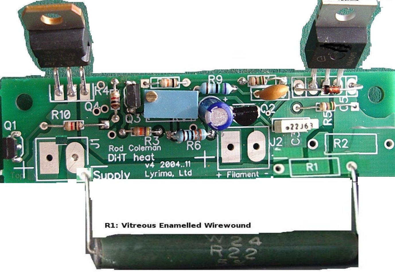

When you like to try big resistors in the R1 position, you can use the alternative mounting used for the 6A transmitters. Here's a pic with the Welwyn W24 in that slot -

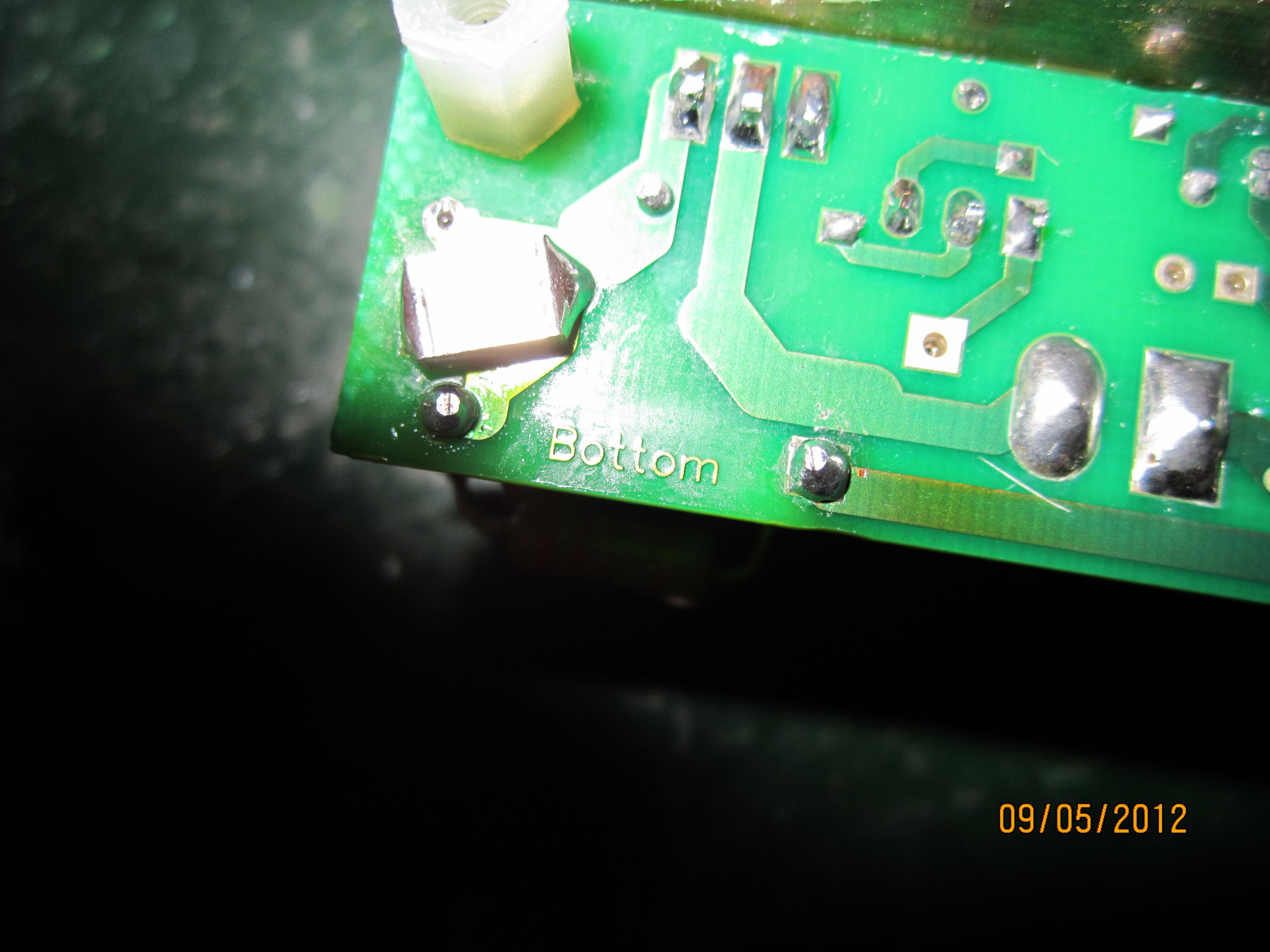

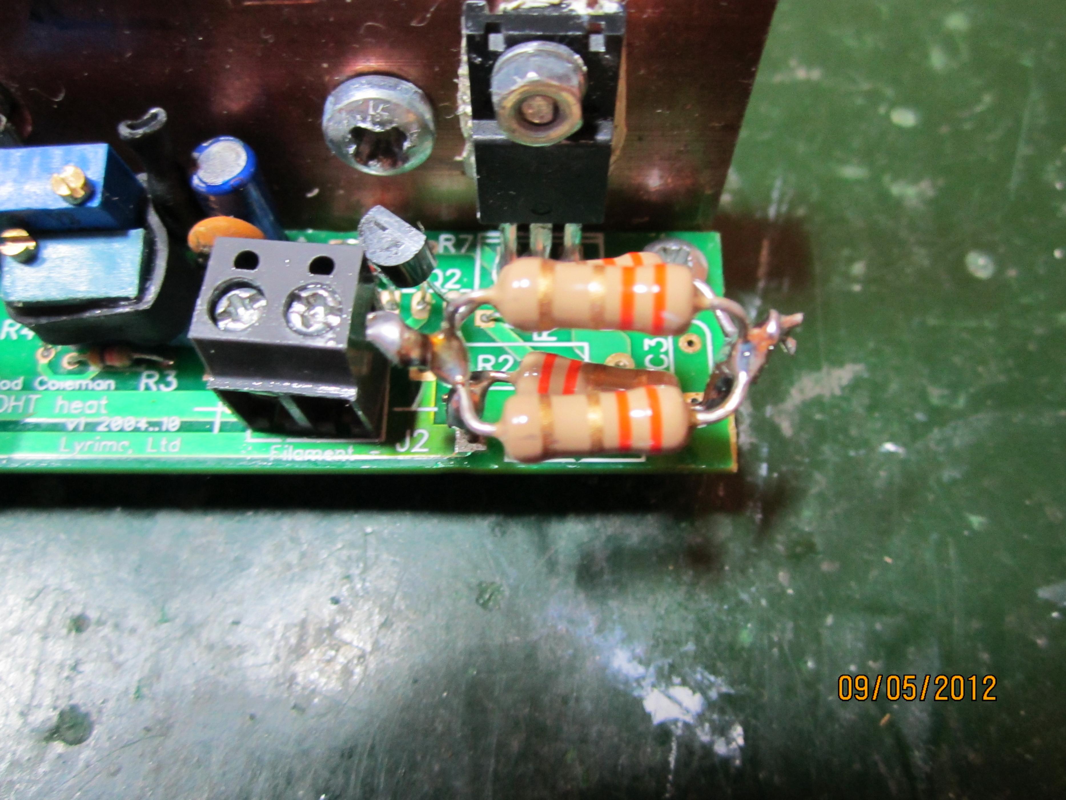

I fitted my 300B supplies with 150n Panasonic ECHU caps, and 4 x 3R3 1W carbon films in parallel, in place of the original 150n polyester caps (I presume) and the 0R83 W/W resistors. I then readjusted the output voltages.
I've had a good listen over the last few days. At first, I wasn't sure I liked the results, but I think this was a case of a need for run in, plus the mod being too revealing for the recordings I chose to play at first. Now I'd highly recommend the changes. You just get more of all the good things SE amps do, already so enhanced by Rod's regulators! Breathtaking (literally in my case) delineation of fine detail in the harmonics of strings- both solo and massed- voices, and wind instruments. Greater depth and solidity of stereo imagery. Just more real!
The caps were a bit tricky to fit, and I ended up putting them on the underside of the board, with the body of the cap running over one the (laquered) tracks connecting to it. One end connects to the underside of one of the unused R2 pads, rather than its original connection point

Thanks for the report, Paul.
For the 300B range, I have been experimenting with R1 = R2 = 1,5R 1W Carbon film. These fit perfectly in the PCB positions.
The stability has been very good, and their operating temperature is low. I'll be trying them out shortly, for sound, and I am expecting good things!

I was a little concerned about long term stability, so I used 4 x 3R3 1W carbon films to spread the load still further. (I didn’t use the R2 mounting points as I’d already soldered the new cap to the rear of one of the pads!) As a rule of thumb, I always like to run resistors at no more than 1/3 their maximum rating. On the other hand, I use a lot modern generic carbon films, and they do seem very stable- and better sounding than their metal film equivalents- despite the theoretical advantages metal films have.
Though, to be honest, I meant to try just the cap change alone to begin with, as I suspect this is the more important factor. But, when it came to it, I couldn’t face the extra hassle of a two step trial!

Yes, big margins should be used, especially with wirewounds, as these are designed to operate at high temperatures - 350 deg C for some Vitreous types.
The Regulator's PCB pads & large copper areas are designed to suck heat out of the resistors. Using both R1 & R2 positions aids the effect. The CF 1W run much cooler than WW, with the help of the oversized cooling of the copper-lands. With 1,3A 300Bs they burn ~630mW each. They're rated for 1W at 70 deg C ambient, and with no special care on the PCB layout.

I use now cheap carbon resistor for the filament supply : Yes ! There is clearly an improvement over metal film, by a wide margin !
Let me resume : for R1, carbon, or if no cost object, Duelund.
For C3 (220 nF), anything but the little piece of plastic provided ! (sorry Rod!)
For the other resistors, carbon even the cheapest one !
With those little "tweak" I have the same level of improvement than between let say, a good film capacitor, and , one arm and a leg later, a silver foil Duelund ! 😀
