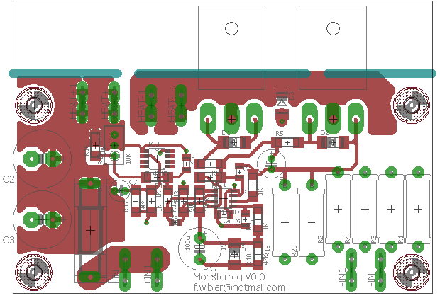

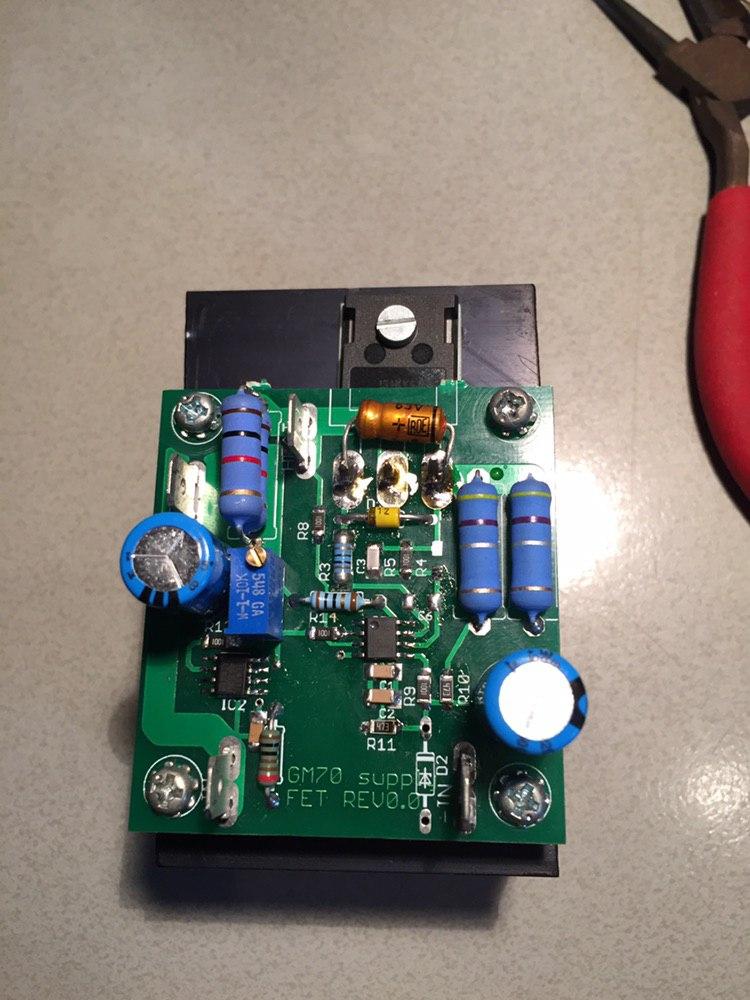

A picture of a prototype board is attached. You are to use the board to mark out the holes on the heatsink, and then break of the part above the FETS.

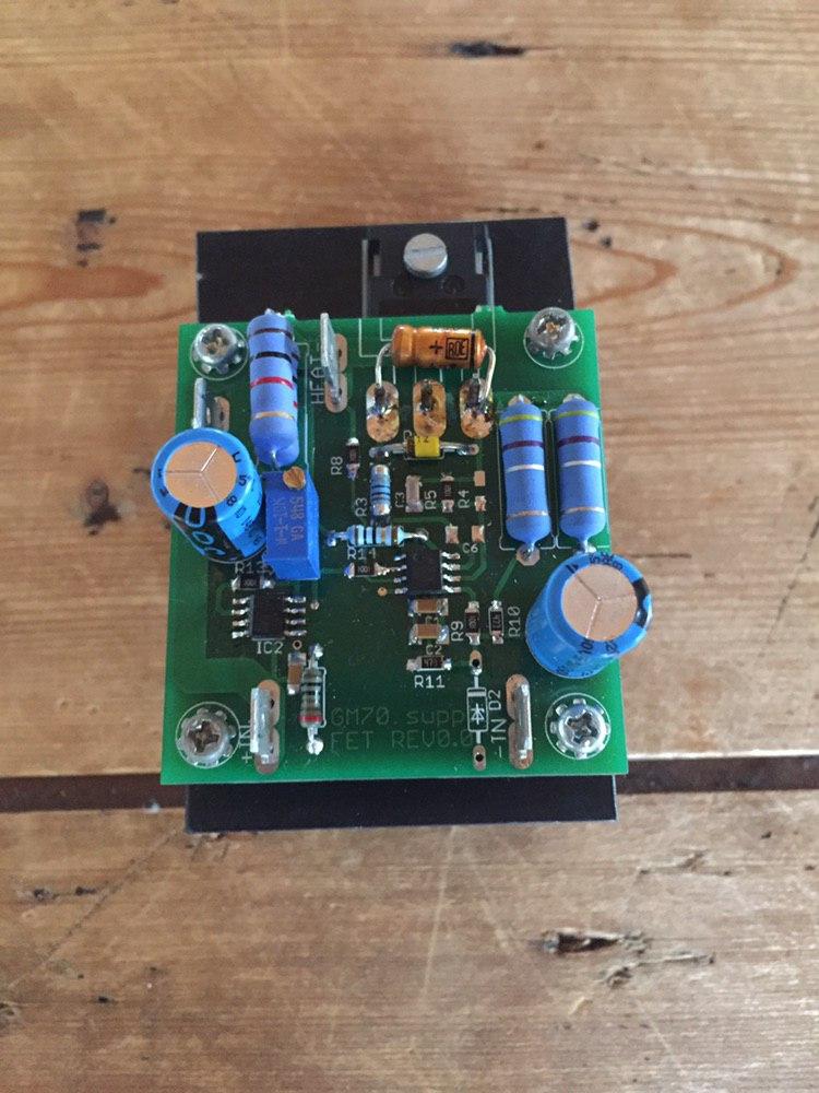

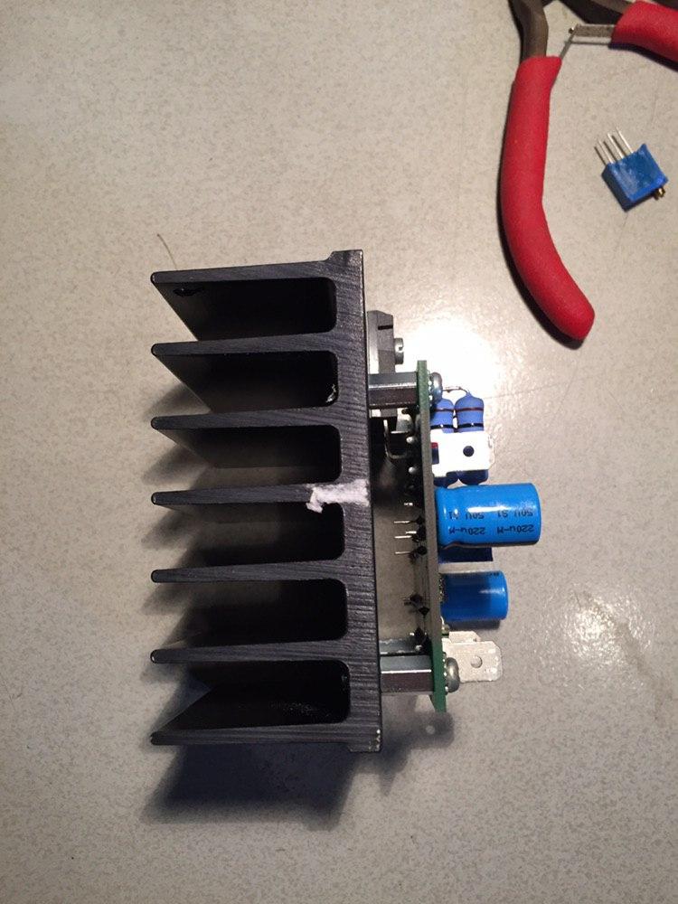

Here are some more pictures of the smaller version, intended for GM70 ect. Current capability is in the ballpark of 5A continuous.
The heatsink is 2.3K/W and is capable of feeding a GM70 from a 20VAC rectified winding.

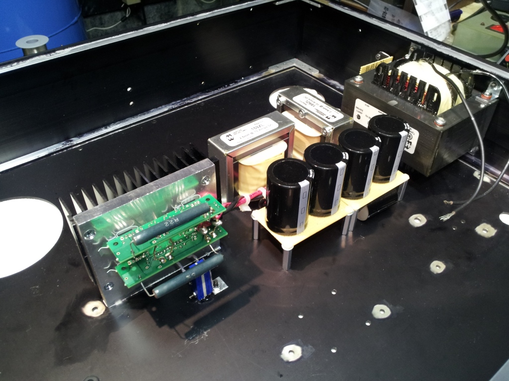

Cool project! To heat 833s, I found that the Meanwell LRS-200-12 turned all the way down was a really simple solution.
What you have here looks to be way smaller (although you'd still need a PT, rectifier, and filter caps), and the noise specs are far better.
I just use two Rod Coleman regulators in parallel to supply low noise regulated DC to my 833C amps (10V, 10A). Been working perfectly for 6 years now.

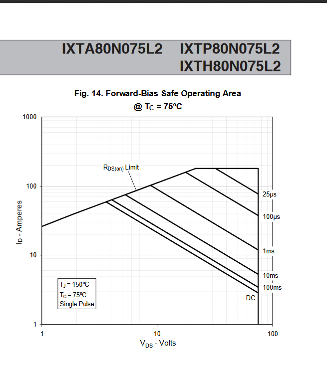

One very nice aspect about my build, is that the used L2 series mosfets have VERY wide DC SOA characteristics. unless you manage to get the heatsink up to 80C those Fets are unlikely to fail.
PN on my build is IXTH80N075L2 see the attached SOA curves on that device.

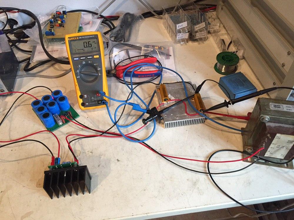

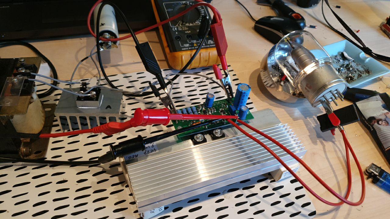

Also attached: A photo by a friend of mine, he is testing the modules for me, the tube in question is a 7.5A 5V tube.

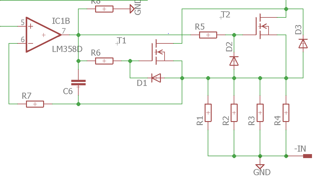

I could build a version using a single FET built for 10A continuous, from my friend i understood that the double FET version is higher noise then the single Fet versions he tested. Why that is i will try to understand later when i have the time.
Perhaps i could decrease dropout to about 1-1.5V in that case the transistor would dissipate about 25W 13V in 10V out. and 38W in high mains conditions,
Decreasing the dropout would entail poorer CCS performance because the mosfet is working at the unlinear part of the curves, so the opamp needs to work harder to keep the CCS working as expected.
Coincidentially 13V is about the expected load voltage from a 12V toroid using normal rectification and 33000uF+
Perhaps i could build a version with three Mosfets and a 100mOhm TO220 sense resistor. that would allow dropout voltages of 10V at 10A safely. And i could rework the driver to be able to use a more stable opamp like the LM358 This would entail using LH0002 driver for the FET''s. cause the 358's will scream if you load them with this much miller capacitance. 🙁

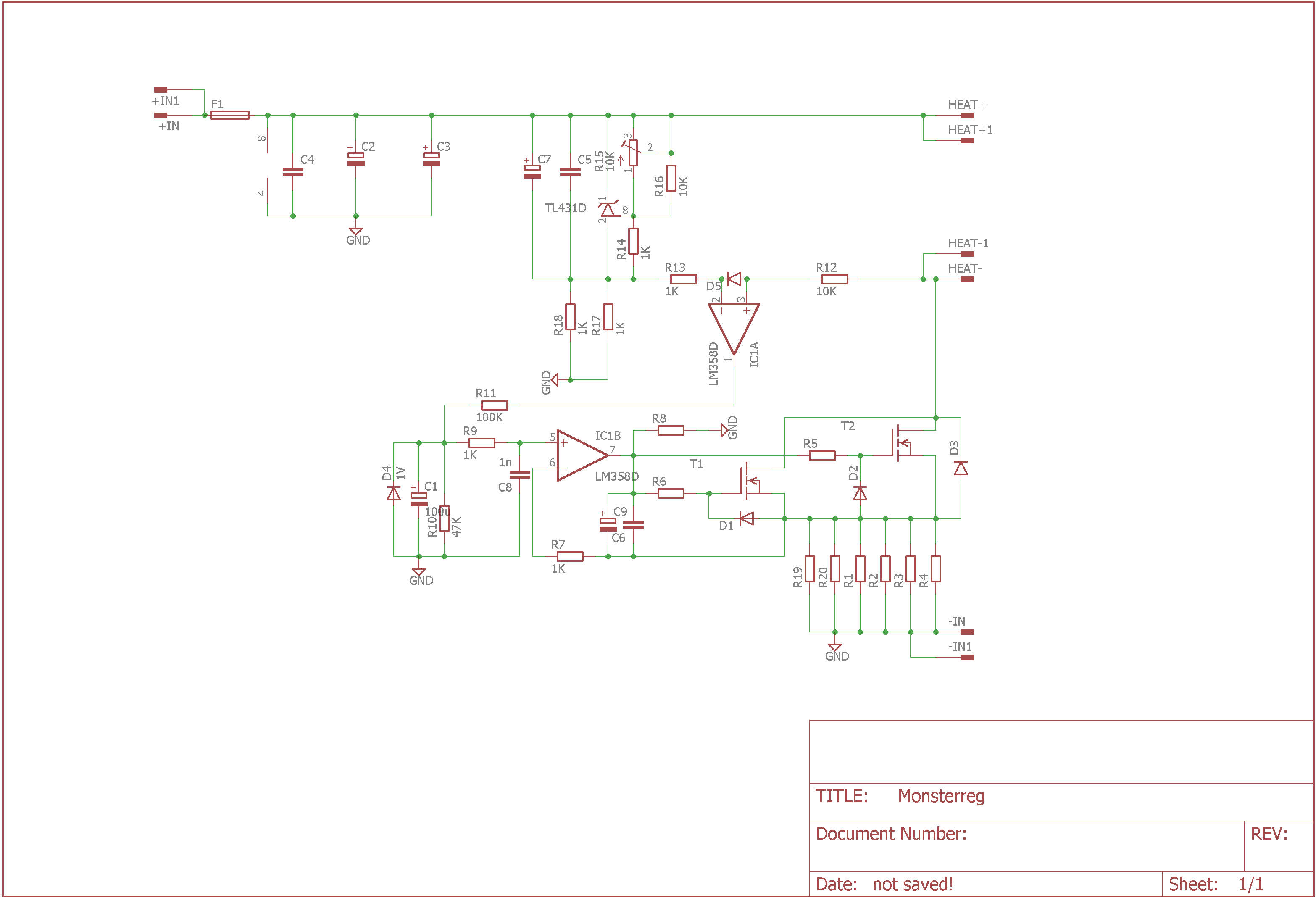

I've just slightly reworked the first prototype boards, it should be a lot lower noise now, but i wont know untill i build some.
It has to do with the opamp, ive placed a cap at the output to decrease the slew rate of the opamp, so it cannot respond to HF on the input or from ambient, to keep the thing stable, this cap needs to be chosen so that the opamp still has a slew rate of at least 1V/1mS
Attached the schematics for the CCS, the opamp is claimed to be stable with unlimited capacitive loads, im thinking 10uF for C6 .
Anyone wants to chime in for boards ? Two boards are €10 total.

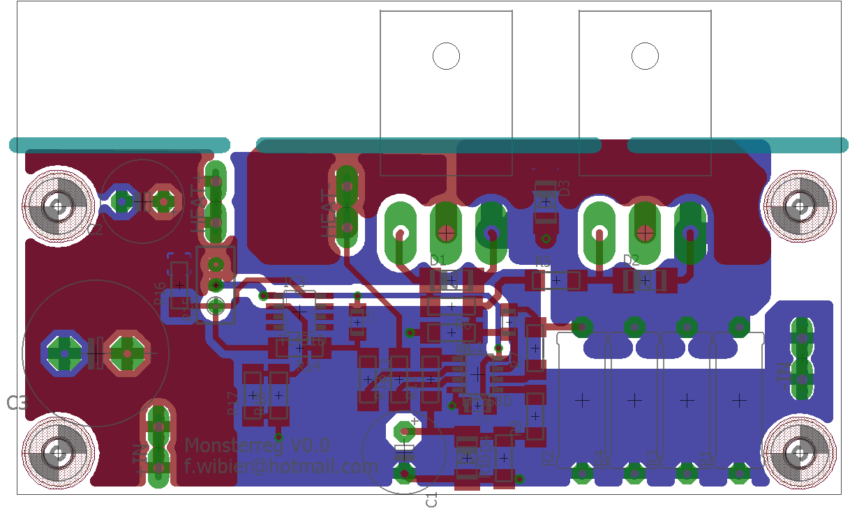

If anyone else is interested, dont hesitate to contact me. The suggested price of €5 per board is the group buy price, and includes the schematic once the boards become available. I got all the parts for the module stocked except the FET's. I am quite hesitant to provide the correct schematic right now, fruits of my labor and all.
Here is the board with some changes implemented, the board grew in size by 10mm but i added a fuse holder, and two extra current measurement resistors. With 6X 470mOhm current measurement resistors the cold current is 12.8A +-10% so i might have to stock up on 390mOhm or 330mOhm.
See attached the plot of the board. 52x100mm is the complete area.

I'm not really helpful by not posting the schematic in a public place anyway. I was afraid someone might run with it. But a friend of mine explained the peculiarities of the patent system with prior art and all.
See the attached schematic and judge for yourself. It seems to be stable now ive done some modifications, first i had problems with the opamp producing harmonics that caused instabilites, that caused the system to oscillate at about 300Khz. But a small capacitor from gate to source fixed that. I think it is because i swamped the miller capacitance and decreased the possible dV/dT on the gate of the fet.
The opamp ofcourse is no 358 its in fact a LM7322
I havent run any phase response simulations on the system, i welcome anyone to do so, if you want to I will PM a complete list of the used critical parts.

The circuit is is no means mature, but it shows potential, if the RC time is chosen right the startup is good with little overshoot. The mosfet is rugged, and i think i fixed the instability in the constant current part (presumably the hardest part of the circuit)
The circuit shown above, has some extra parts that can be done away with, and it will work, as a matter of fact i have a module here on my desk that works. with no oscillation.
