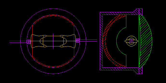

Also had another idea. Breaking off the outer casing, and using one of the small reflectors for the hqi bulbs sold here. I know that it will emit large amounts of uv but im going to insulate it with uv glass. You also have to solder over the little air protection circut that turns off the bulb when exposed to the atmosphere. regular projectors use exposed elements so i dont see why this wont work to make a cheaper bulb. Please post your thoughts, so i can save 20$ on a bigger bulb to use as a test subject.

Actually, this idea haunts me for quite some time, but I never got the time to put it into practice. This was successfully tried here with an Osram hqi-t 150W, but I never seen it done with a 400W MH.
This is what it should look like; magenta is the machined aluminum casing, red is the reflector and green is the condenser lens.
I really wont to know if this is doable.

Breaking off the outer casing...
I've also wondered about removing the outer envelope, but I'd be careful.
Apart from the UV issue, the envelope acts as protection if the capsule explodes, which it can do violently, so be sure never to operate the lamp without some sort of guard in place.
It also protects the capsule from overcooling, which can reduce efficiency and also lead to stress and consequent explosion.
You'd have exposed lead-in wires carrying high voltages (up to 5kV or so during ignition) so you'd have to take care with access and airgaps (don't forget that that UV can cause ionisation, making the surrounding air conductive - your own little lightning storm😀 ).
I'm not saying don't do it - just that, as so often, there's more to it than meets the eye.

The lamp will explode towards the end of its life. But, compare to the 1mm glass envelope, I’m prepared for that with 5mm aluminum and 20mm thick tempered glass (Borosilicate to be precise). I’m not over-engineering things here, the casing I think it should be that to give it some thermal stability and the lens is that thick because of its focal length and diameter. Actually, if it would be made from Pyrex it would be thicker.
Obviously the lens should be UV treated.
Now the part what I don’ know; the chamber should be pressurized or not? In any case there should be little to no airflow inside it. Thermal exchange is done through radiation also, but is that such a big issue here?
Clearly at least of one wire will be insulated with a ceramic tube. This is not clearly mark in my drawing, but if it weren’t, the ionization would be the least of my problems.

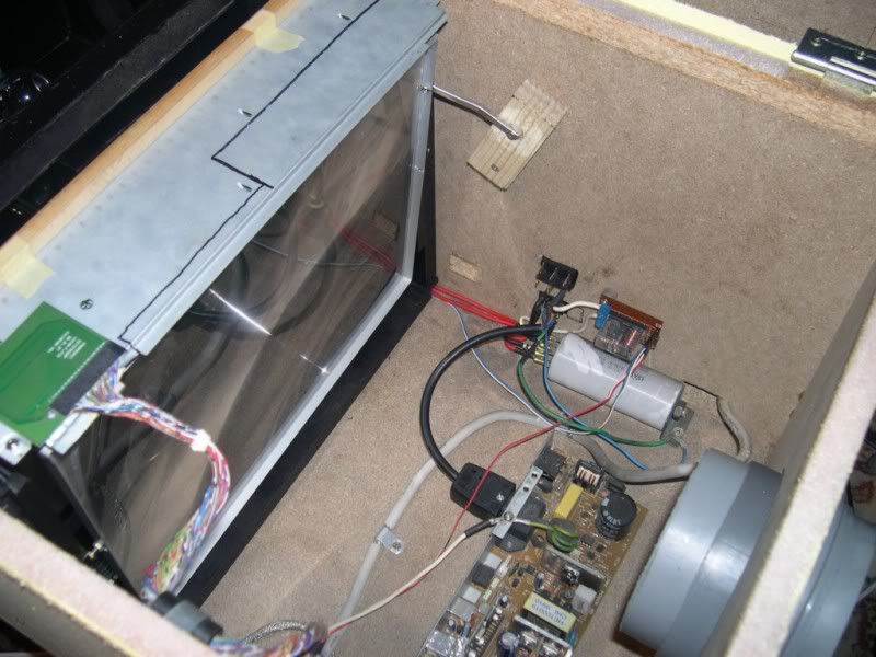

We started with an OHP and then modified to long throw lens to position the projector at ceiling height. The details are available at the following link to our web page:-

Getting back to my thread,
I found some nice things at a local repair shop.
They had loads of old crt projection tvs!
They were trashing several that were beyond economic repair. I found out that about 50 percent of all projection tvs use a front side mirror. The rest just a high quality regular mirror. They gave me one for free for they were just going to trash it too. Its 3 feet by 2 1/2 feet. Plenty big enough to cut to whatever size you need. Take a look at your local shop. They also have loads of free lens triplets off the crt tubes!!!

Thanks a bundle for your help. Lots of great ideas. Its nice to see actual pictures of the insides. I finally have everything to start construction. I hope to have it going by next week. I will post pics when its done.
