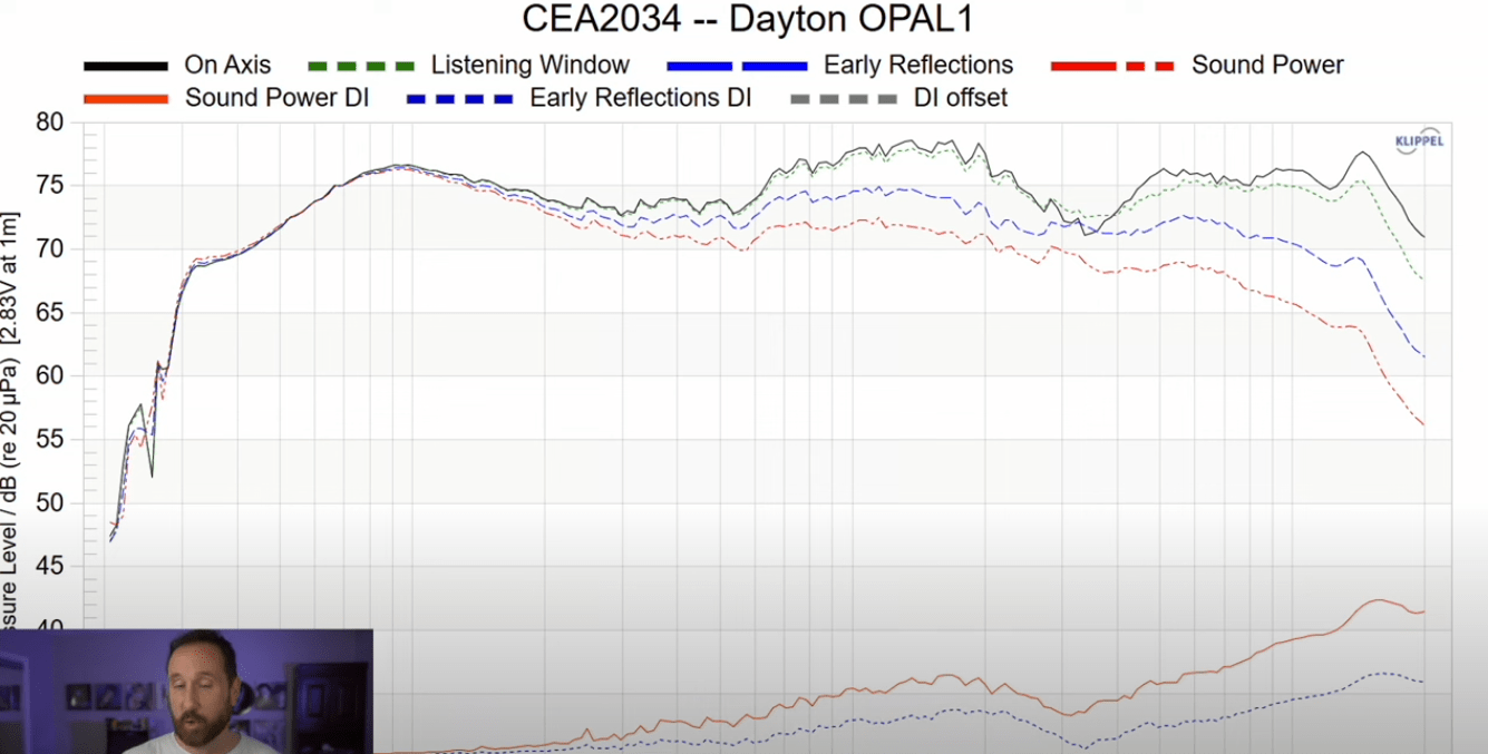

Look- for the money they have used good parts and it looks promising. Dayton is known for good value, good performing drivers of which I have used many. As far as I know Dayton have never produced a finished speaker designed in house that has performed well (nor have they tried?). I hope it performs well, but we all have known speakers that were less then the sum of their parts and some that were quite the opposite. I think it's a little premature to assume anything except it looks interesting. I personally hope they nailed it.

I agree the base cabinet and driver complement are decent foundation. I would not tune it to 30’ish Hz though. Tune it to 50Hz and let room gain handle the rest. It’s a tiny bookshelf and no one expects it to do 32Hz - and hence 78dB.
Would be interesting to get one to measure and redo the XO, if needed.
Even on my 5.25in TL (Galion Audio) design, I only took it to 44Hz and it’s got plenty of bass.

I feel like sound quality gets sacrificed squeezing lots of Xmax out of any drivers. Heavy suspensions, 4 layer coils, etc... all great for maximizing SPL at LF, but I am more interested in speakers without those particular design compromises. I feel like there's something to the transducer area/horn mouth size that has eluded most analyses. Maybe we're more sensitive to the size of radiation or IMD/doppler than we think, who knows, but I always find something lacking with small and inefficient speakers.
There was a demonstration of IMD/doppler at Burning Amp a few years ago, it was audible. Bob Blick is the first guy in this video and he was the one giving the IMD demonstration, unfortunately he does not give much of a description of the system setup. I believe it was 2 sets of identical sets of cabinets with 4" full-range drivers. He would run the top one full-range and then could on the fly crossover the low frequencies (200hz?) to the lower woofer. It really cleaned up the sound.Maybe we're more sensitive to the size of radiation or IMD/doppler than we think
These drivers aren't bad, they just scream active system.I agree the base cabinet and driver complement are decent foundation. I would not tune it to 30’ish Hz though. Tune it to 50Hz and let room gain handle the rest. It’s a tiny bookshelf and no one expects it to do 32Hz - and hence 78dB.
They make absolutely no sense in a passive design.
There are tons of other speakers that would fit that idea way better.
Even more so if you just double up the amount of woofers instead of using PR's
For 800 bucks I also expect something with a better directivity as well; waveguides.
agree. Would be better with two woofers, ditch the passives.Even more so if you just double up the amount of woofers instead of using PR's
How would you maintain the form factor? 2.5 way with a rear facing woofer?agree. Would be better with two woofers, ditch the passives.

good point. no passives, $599 a pair? I do like the look of the passives but I'm always too cheap to use them when a $2 piece of pvc will suffice.How would you maintain the form factor? 2.5 way with a rear facing woofer?
The PR’s allow deep tune frequency without a long narrow vent and keeps the cabinet small. Two larger drivers without PR won’t necessarily mean as low of bass F3. But will be more efficient for the rest of the range.agree. Would be better with two woofers, ditch the passives.
In a passive system that is and only when the tuning frequency is low compared to the volume of the cabinet.The PR’s allow deep tune frequency without a long narrow vent and keeps the cabinet small. Two larger drivers without PR won’t necessarily mean as low of bass F3. But will be more efficient for the rest of the range.
In practice two PR's are often similar in price or even more expensive than just another woofer.
A hybrid filter system would have worked wonderful here.
Still because of IMD, I would never use a single woofer at such low frequencies.

Meh, big mid hump would probably annoy me pretty quick. Still think the cnote is the speaker they've done. Anyone have a speaker using the RST that has a more neutral response? Always see them with a pretty decent on axis dip.
