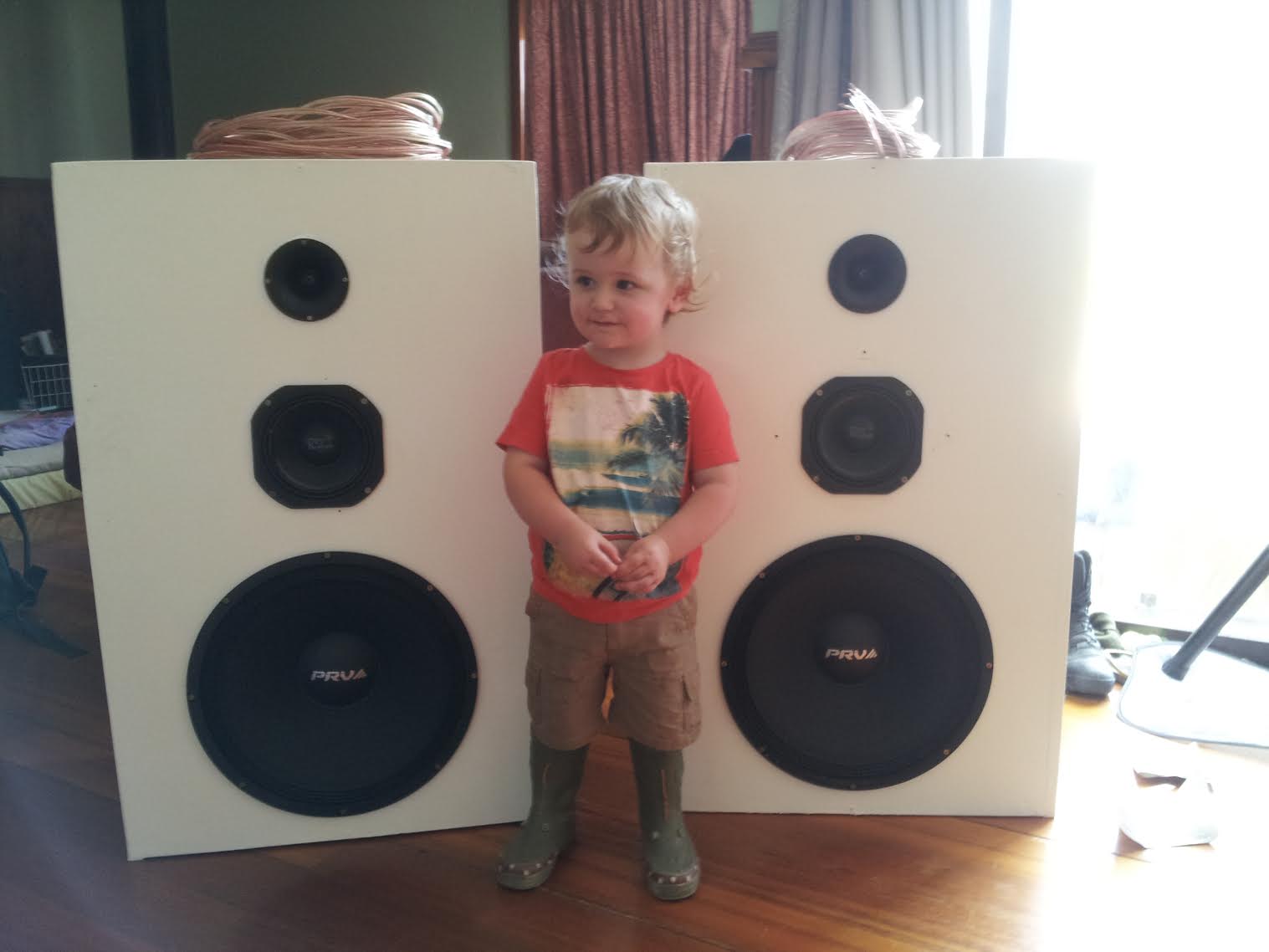

First up, the Plan. I wanted an outdoor PA system for the purposes of playing electronic music to small crowds, mainly for private use. As the plan grew, I realised it might be something other people wanted to hire (eventually).
It had to be super-efficient and run from a single 10A 240V (Australian) outlet. This also makes it easier to pwoer in remote locations ('doofs').
I wanted 2 large main speakers and a single sub. The mains would be mounted on stands such that the mid speaker would be at approx. ear height, with the tweeters a little higher so as to be able to pass overhead of the first row of dancers/listeners. I wanted a highly directional system so as to minimise the chance of annoying neighbours. As I said, I had very little money. They are white, because they are going to be painted by a local artist with a 'psychedelic' bent 😉
What I built is this:
No not the kid (though I made that too).
The subwoofer is yet to be built, however I have a high quality 400W@8ohm RMS Class D amplifier for it.
Tweeters: Vifa H25TG05-04
Mid: PRV Audio 6MR500-NDY-4
Mid-Low: PRV Audio 15W700
The mids are in a sealed enclosure, inside the main cabinet. Each driver is driven independently from its own amplifier:

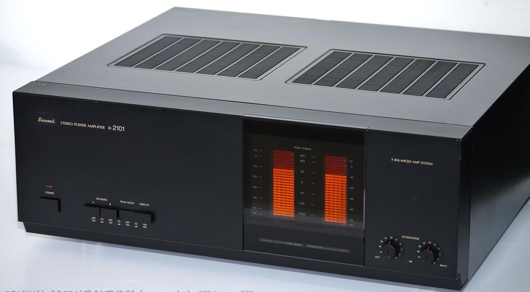

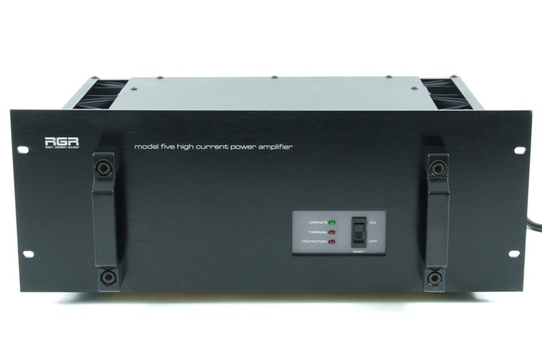

Tweeters: Roger Godinsksy Research Model Five Power Amplifier (2X200W@4Ohm)
Mids: Sansui B-2101 Stereo Power Amplifier (2X300W@4Ohm)
Mid-Low: Yet to be purchased Stereo Power Amplifier (2x400W@8Ohm)

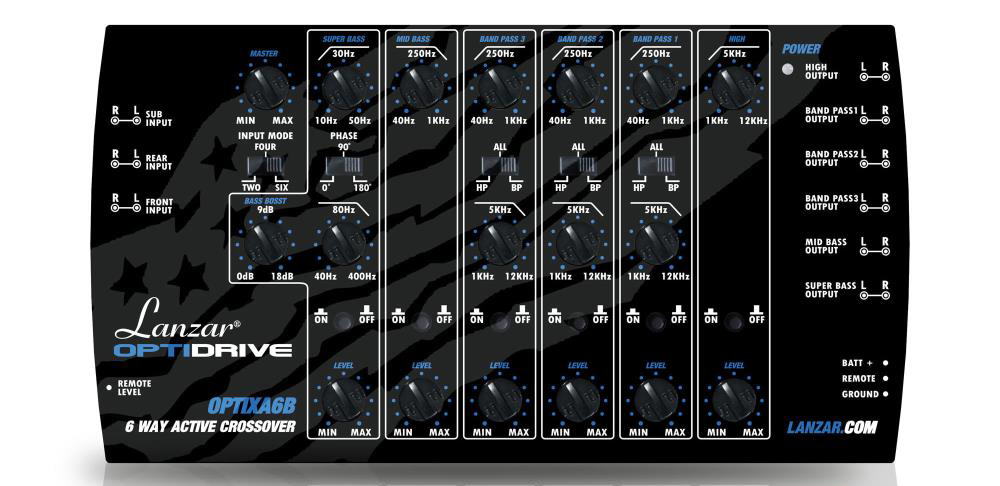

One of the really interesting budget 'cheats' I discovered, was a reasonable quality active crossover for a fraction of the price I would have paid for a professional active balanced crossover:
Lanzar OPTIXA6B. While Lanzar are the greatest name in audiophile equipment, their 'Optix' range is their 'Premium" range - and it has 6 separate stereo outs with adjustable LPF, HPF and bandpass.
Between this and a 2-channel 31-band graphic EQ (also not yet purchased), any required sound shaping can be done.
The downside is using unbalanced signals - but the quality of the amplifiers and their power supplies - so far - means that they are truly dead-silent, even at full power.

Lanzar OPTIXA6B active unbalanced crossover specifications:
SPECIFICATIONS
GENERAL
Total Harmonic Distortion @ 1KHz………………………………………………………0.04%
Signal to Noise Ratio…………………………………………………………………….>105dB
Stereo Separation…………………………………………………………………..……...>70dB
Current Drain………………………………………………………………………….……200mA
Remote Turn-on Time………………………………………………………………….….0.5sec
Recommended Fuse……………………………………………………………………..........1A
Dimensions.................…………………………………………………….1.6”Hx5.9”Lx12.8”W
INPUTS
Input Impedance
Front & Rear & Subwoofer…………………………………………………….….22K-Ohm
Input Voltage………………………………………………………….………….150mV~1.6V
OUTPUTS
Crossover Cut Off Slope…………………………………………………………..12dB/Octave
Maximum Output Voltage…………………………………………………………………….15V
SUBWOOFER
Low Pass Crossover Frequency………………………………………….40~400Hz
Subsonic Filter……………………………………..………………….Full/30Hz/50Hz
Phase Shift……………………………………………………….……………..0 or 1800
Bass Level Remote Control…………………………………………………….Wired
Rear (Mid Bass/Band Bass 3):
Mid Bass: Low Pass Crossover Frequency…………………………40Hz ~ 1KHz
Band Bass 3:
High Pass Crossover Frequency……………………………………..40Hz ~ 1KHz
Low Pass Crossover Frequency…………………………………….. 1KHz~12KHz
Front(HIGH/Band Pass 1/Band Bass 2):
High:
High Pass Crossover Frequency…………………………………..…1KHz~12KHz
Band Bass 1 & Band Bass 2:

A few thoughts:
- You really don't need 15" midbass drivers if you're going to use a sub. 12" drivers are smaller, lighter, and will provide plenty of kick down to, say, 80Hz.
- It might be worth using a compression driver based tweeter if you're aiming for high power levels. The horns used with compression drivers have much more directivity than small dome tweeters.
- You appear to be using class AB HiFi amps. I'd strongly recommend using class D amplifiers (Behringer iNuke are decent, and cheap), which will draw around half the current of your HiFi amps for the same power output.

- You haven't set any SPL/coverage goals, so an idea of roughly how loud you want to go, and how low you want the bass go to would give us a good idea of what to recommend.

Class D amps have terrible specifications and audio - period - unless you can afford to spend a small fortune. I can't. A Powersoft would be great.
They did 20 years ago. The extra efficiency and weight savings from modern switch-mode amplifiers are non-trivial, and shouldn't be discounted so easily.

In my price range, Class D amps are strictly for 1500hz and lower. At higher frequencies their sonic shortcomings become audible.
Feel free to correct me with a link to a Class D amp with specs that match or better the amps I have (not in power - in fidelity) for the same or similar price.
I go for top-end specs - on a budget. Weight is not an issue. Most of what is said here is just opinion because if you think low-end Class D amps are 'sufficient', then we are not on the same page.
They are not.
Check the specs of the equipment included. Then check the price.
I got ALL THREE amps for $870 (2X 1200W RMS@4 ohm >0.5% distortion, over 105dB unweighted!). All drivers: $50 + $200 + $300 plus shipping and currency conversion.

In your initial post, you said you wanted some directivity, so that you're not throwing sound at nearby neighbours. In response to this, I suggested that you use compression drivers and horns, since that's the easiest and cheapest way of getting some directivity. Compression drivers will also handle much more power than small dome tweeters, which again is useful to you.
In all, it honestly does look like you're assembling a powerful home-HiFi system, and using it for PA use. The design criteria are different, and we're trying to show you that.
