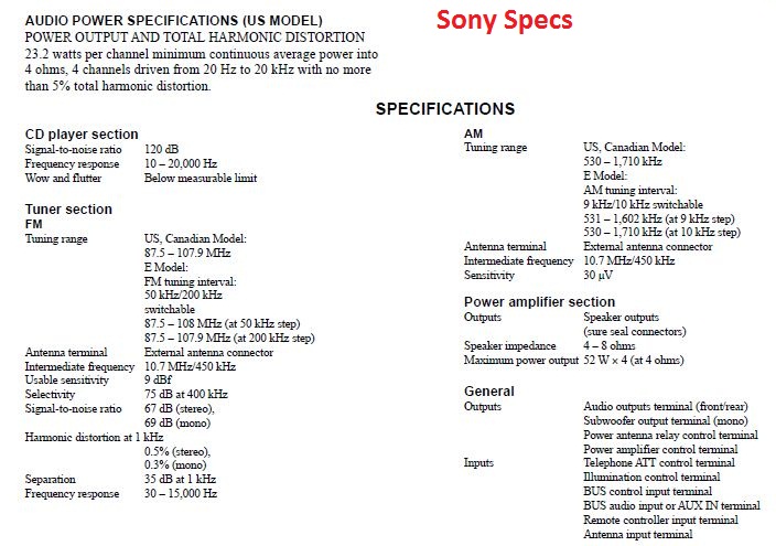

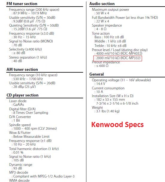

Yea, the sony having three rca outs and sub fadar.. However the kenwood seems well built.. How would one determine which is better based on these specs.. I am not using the internal amp so the watt it has isnt relavent..
I have attached a snip (below) of both the kenwood & sony. If anyone knows how to read these and tell which is better and why plz feel free to post back
Ok I just noticed you say the kenwood, but I already waisted the time to upload the pics. I dont understand S/n Ratios and all that. I'd like to know how people look at specs and determine the better of product.. I will look them components up as I know these house speakers I got upfront will blow soon... They are driven by KAC-927 which is 800X1 and the way speakers are wired 200x2@2Ohm all 4 on this 2channel till I get another 2channel to drive the rears separately

I don't think you could hear an audible difference from the specs they give. The crossover in the sony is a big win over the kenwood though so between the two I'd go with the sony. The sony decks also started claiming a very high s/n ratio for the cd section in the past couple of years.

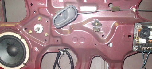

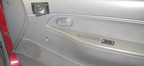

The new amp Got is a Coustic Power Logic Amp Model - Amp 360
I have this running to my rears, KAC-927 to the fronts (by Itself now not with rears) as well as the monoblock. I swapped out the Kenwood for the sony.. I know its cheaper but it has built in crossovers. My question being for that Coustic being 65W RMS it reallly put alot. I have the gain all the way down otherwise my rears pop with the bass. As you may know its an old school without crossover. If I set the crossover on the deck at 125 or 75 (i belive) then both front/rear rca output are effected.. but sub output is not. Would the stock preset xover frequency sound better at the deck for both amps, or should I leave it off and keep the rears at full and the fronts set with the amps built in variable xover? The crossover I bought I sold it thank god.. so that solved my engine noise.. but what would be the best way to set this up to the correct frequencys? Also I am thinking about putting the diamond xovers I got that go on the speaker side. Can you use a passive crossover with active crossover set? (VIA Deck or amp) or will they conflict? I only ask because I have a 11Uf (a cap off a 6x9 tweeter) for my tweeters, and mids directly to the amp and many say this is not sufficiant.. How would I get active and passive work together.. as I am still confused about using 2 crossovers..
Did I do it right?
Ok recap
Sony Headunit (3 Rca outputs) [sub/rear/front]
Kac927 2channel amp (on Fronts)
Old School Custic (On Rears)
Monoblock (On Sub)
I set all crossovers to full EXCEPT on monobock.
Set headunits HP to 78 (which appears to crossover front/rear)
Set headunit LP to off (Because on the monoblock you cant turn it off)
Installed a set of diamond crossovers to replace the caps I was using for the tweets (From blown 6x9) on the front speakers...
Rears are coaxial and I've set the gain on this amp a lil lower...
Is this optimal setup with what i've got now? also should I cross the monoblock to 78 to match the HP of 78?
Thanks in advanced. Here is some pics of the speakers in front and crossovers I installed...
