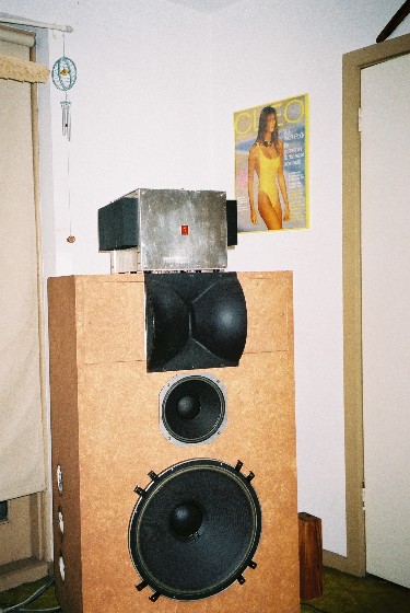

Here is an image of my system which uses a passive crossover with 2nd order slopes for the bass/mid crossover @300 hz , then a neat 2nd order AllPass network for the mid/high croover @1khz, so the mid and high pass outputs are in phase.
