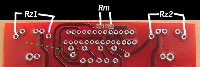

Hi, I've got a pair of Brain's LM4780 boards. I notice the schematic has Rz1 and Rz2, but they are not on the board??? where do they go? Also, do the R and C numbers from the schematic match the corresponding ##'s on the board? Hmmm.....In fact it looks like the outer sides of Cz1 and Cz2 (on the board) do not connect to anything at all (no traces)?
I'm sure there is a thread here but after 45 min I cannot find it.
In addition there are some unlabeled pads on the back of the board, what are those for?

I am sorry for the confusion. Here is how the resistors mount on the back of the board:

Thanks Brian, so the ##'s on the schematic otherwise line up with the R and C##'s on the board?
Also, just curious, whats the trace (below-- green arrow) for?

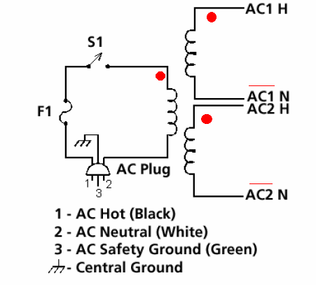

OK, great. I see for the PS you have the other guide, but its not quite exactly the same as the boards. I've always been confused by the way the AC1 and AC2 are labeled on these boards but I think I've figured it out.
Is the attached image the correct way to hook up the diode board to the transformer? Note I've added polarity markings to the transformer and a not "____" to the lower AC1 and AC2? I suppose it does matter how the secondaries hook up, you just cannot randomly use any orientation for AC1 (one winding) and AC2 (the other) without paying attention to the polarity of the windings?

That power supply image is correct. The polarity labelled is correct. Sorry for the confusion and lack of documentation.
