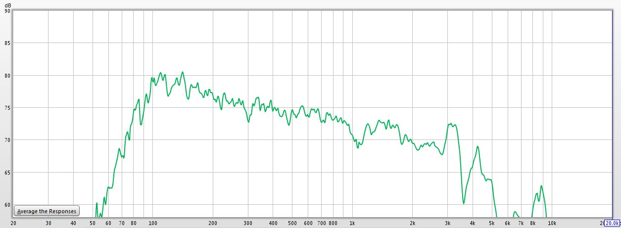

This is a 3rd party close mic measure of the woofer in a box which I found on the web which is pretty consistent with what I’m hearing on a narrow test baffle. With such a high QTS, I suspect an actual f3 around 60hz in room with 9 per side and some DSP manipulation.
What‘s most impressive is the response from 250 to 1k…..very smooth. Crossing at 800-1k should be super simple. The question is whether or not a line of 8 of the GRS tweeters can go that low and still play clean up to 100db.
I can’t say that the woofer breakup in the 3-5k range has manifested as poorly in listening as it shows in this measurement though…..as I mentioned earlier, it’s more of an energy storage thing to my ears. It should be waaay down with a 2nd order low pass filter though. I hope to be able to use that little 3db dip at 1k to my advantage.
