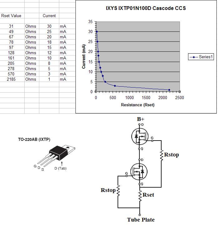

Something along these lines could work. I now place the gate stoppers inside the zener protection diodes, but the basic topology works quite well. You can run well over 100 mA total, as the DN2540 has a higher IDSS than the IXYS. Benefit to using the IXYS on top is two-fold: you allow greater Vds for the bottom device, and the capacitance of the IXYS is much smaller (Gary Pimm measured 2.25pF for the IXYS and 32pF for the DN2540).
Compare that capacitance to 167pF for the IXTP6N100D2, you could get away with a lot of paralleled IXYS and still have theoretically better performance. No doubt there is a law of diminishing returns, as well as cost.
The only trick is getting a bottom device suitable for currents greater than 150 mA. Possibly toss the IXTP6N100D2 in the bottom...

If i'm understanding it correctly, in a cascode setup, the capacitance of the upper (pass) device is no big problem. The lower device is in series with the upper, so the resulting capacitance of both is always lower than either.
The lower device can be less voltage, but since it is in series, not less current.
Correct?
Thanks for the schematic! Do you have calculations with it? (to get some approximate starting values for resistors)
Do I understand correctly that it doesnt mather wich of the two FETs has low Ciss? As they are in series?
Paul
Pauldune, I believe you are correct based on some fairly extensive experimentation. If the top fet has high Ciss it will pass AC, but if the lower device blocks it because it has low Ciss then all is good.
Also bear in mind Ciss decreases dramatically with a lot of devices as the voltage increases and the depletion zone gets wider.

Seems to me is one would be pretty good as lower device:
IXTP02N50D
http://ixapps.ixys.com/DataSheet/98861.pdf
It has pretty low Ciss(120pF) , a fairly high cutoff Vgs (-5v) ,has 200mA Id minimal based on junction temp. If it is cool can handle op to 800mA; in the CSS it will be very cool with VDS of approx 5V/200mA. And it can handle some abuse because its a 500V device.
Am I right in my assumptions?

excess parasitic C is still a fundamental limitation even with cascode - the current to charge and discharge the parasitic C have to come out of your Id
only the current in the Cgs of the upper pass device can be substantially fulfilled by the local current loop if you use a floating Vbias returning the current to the control device source
do always use the lowest current rated/lowest parasitic C part that fits the job

@jcx Correct me if i'm wrong, but the two parasitic c's in a cascode are in series. If two capacitors are connected in series, the resulting C is always smaller than the smallest of the two. To me it looks like no problem, if one of the two c's is small.
This is good advice. The lower the parasitic capacitance of the device, the better the high frequency impedance performance. What I've found with most of these depletion mode MOSFETs is they are best used between 5% and 30% of their rated Id. Outside of this the Rset resistor values become extreme on either end.
