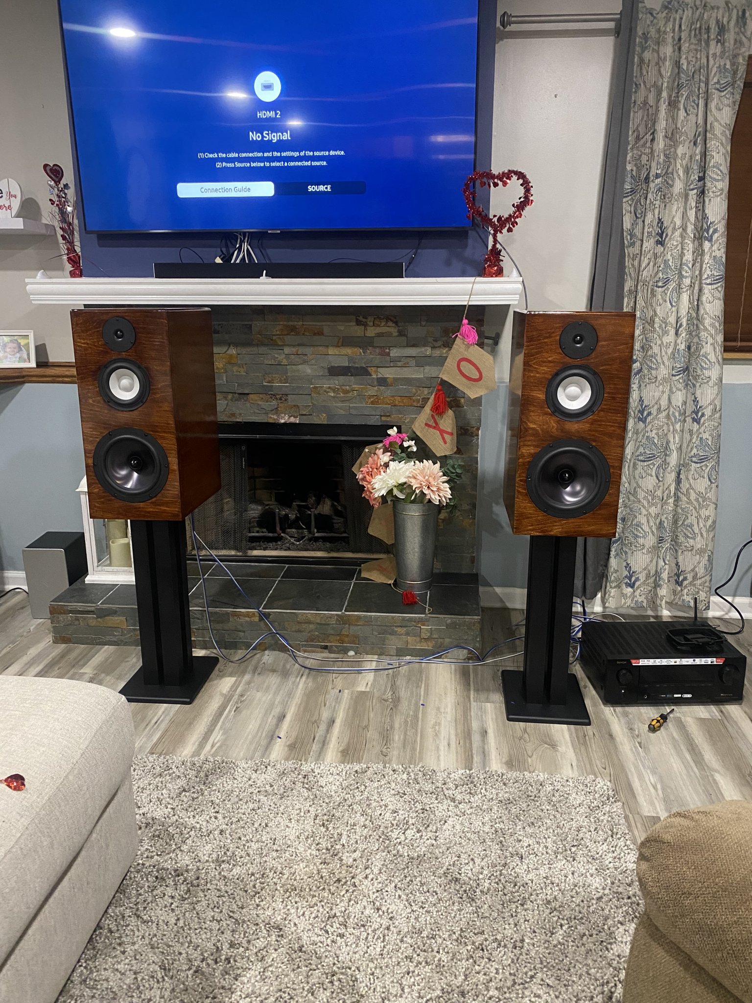

What amps are decent and affordable amps that you suggest? I’m new to this and have always been in to speakers but nothing on this level. I’ll send pics of the finished speaker. I upgraded the capacitors and resistors and using Baltic birch for the build. Really like your buildings and can’t wait to hear it. What do you suggest for speaker damping? I got some 1 inch pyramid foam and was thinking of using some insulation or acousti fil.
What amps are decent that won’t break the bank? I’m honestly really new to this but liked your designs and always been in to high end speakers but never built anything. Finally got my Baltic birch and pvc and will start the build this weekend. We always had b&w speakers growing with a denon receivers that my parents listened to but finally getting my own setup and like the 3 way design.FWIW, I've had amps for the last 30 years and little personal experience with receivers. That said, of the ones I've listened to, Marantz has been my favorite without spending big money. I'd suggest at least 100 watts per channel at 8 ohms. More power is better.

Your Travelers are beautiful! OK, I'm going to join the crowd with a "garage speakers"???? Really??? They are living room/listening room quality sound wise and your finishing skills are superb so looks wise they could fit anywhere! Beautiful job!
Now that I got that out of the way, the Travelers were not designed with an option to plug the mid tunnel. Basically, the Finalists plugged were just like other conventional speakers sound stage wise and included for temporary use closed back for difficult WAF situations.
Curt designed all of our collaborations to be positioned without any toe in for me with the optimum listening position 15-20 degrees off axis. Ear level should be between the tweeter/mid for best imaging.
The Travelers will benefit from listening room positioning in a normal sized room with 100+ real watts. You might consider giving them a listen in the house with more power and try my positioning suggestions. I think you'll be surprised at what they can actually sound like. 🙂

Have to finish setting everything up completely but best sounding speaker I have ever had and my first build turned out well but some changes I’d make on the next with small mistakes on the wood.
