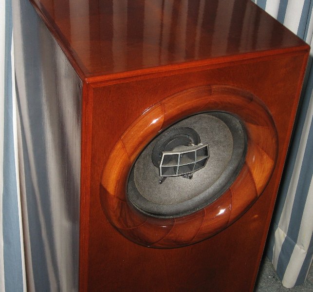

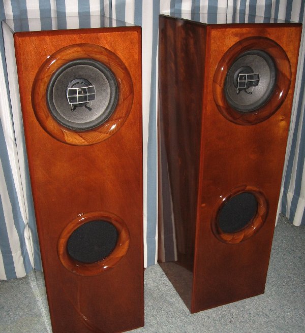

If you really want bass response, then have a look at these beauties that I built... used some vintage PIONEER PAX A20 drivers... They sound fantastic and a really rich bass, yet not overpowering.... and full and bright mids and highs....

Oh yes, it looks like you are quite handy with the woodwork tools! 😎

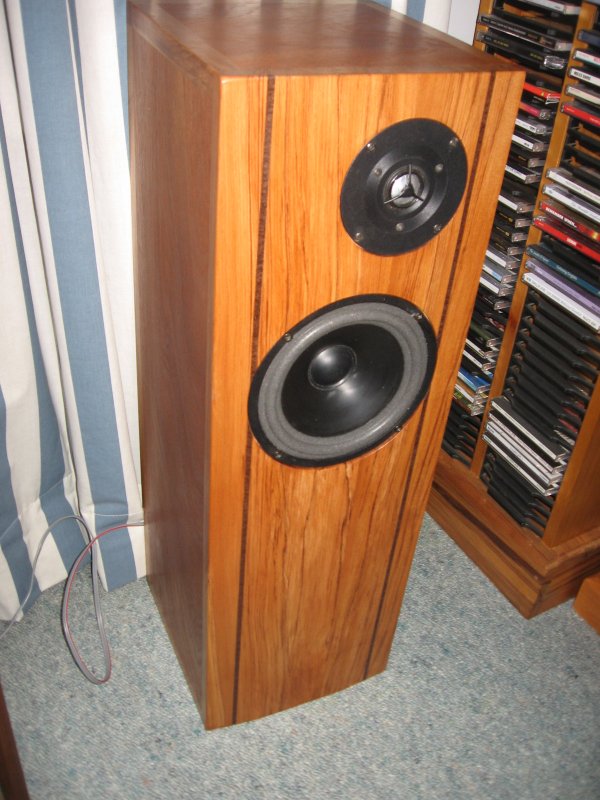

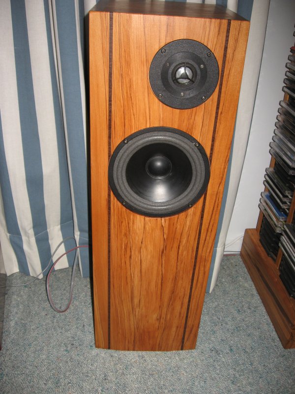

Cabinets actually built....
Hello there Folks, I actually built those ML cabinets using some OLD VIFA Drivers and Tweeters. I rebuilt them and even made NEW Domes for the tweeters... So being a Toolmaker does come in very handy some times....
They do sound VERY good and I have just lifted them up by 280mm and tilted them backward a bit. The whole 'stage' seems so much brighter and complete at this new height.
