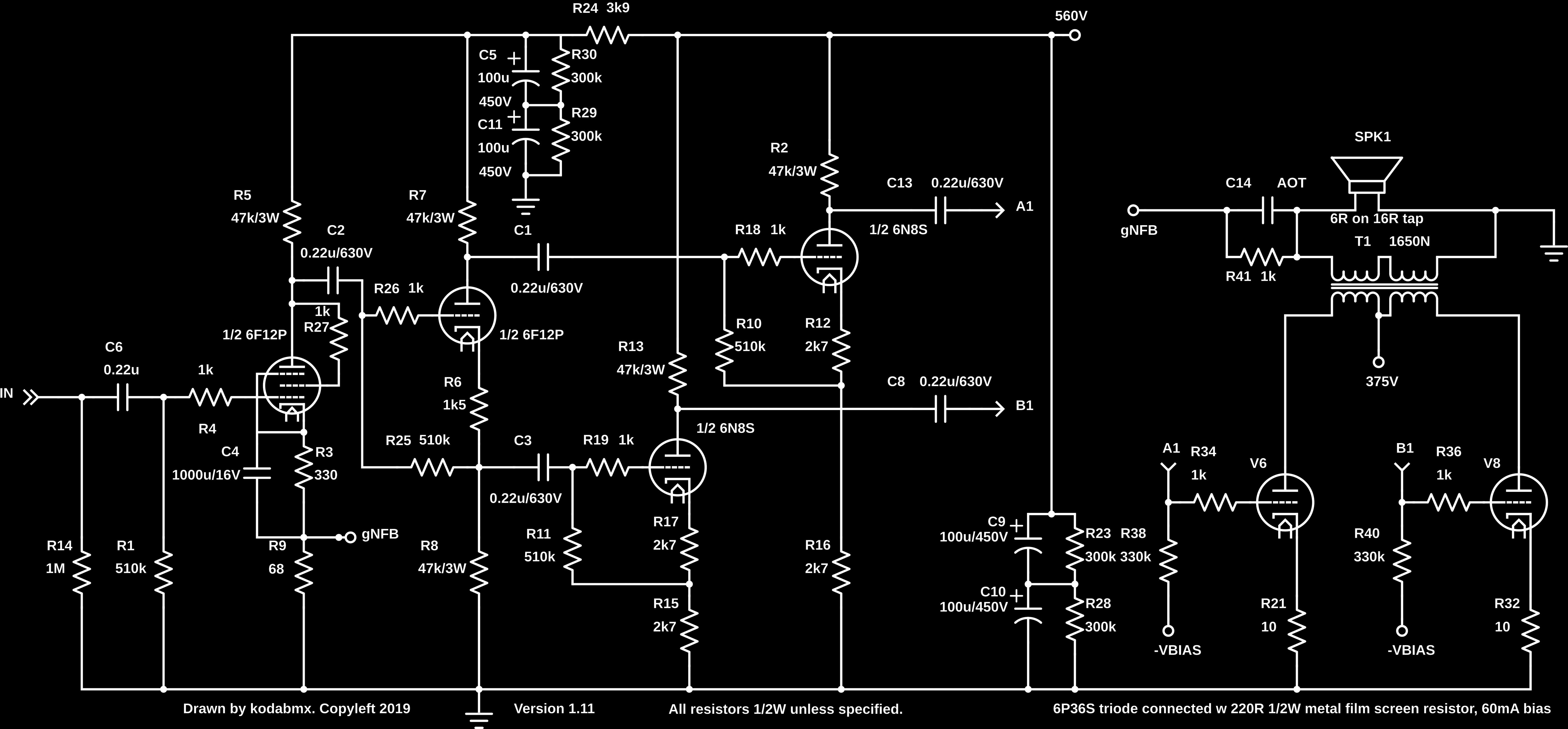

Mathetronics…R38/R40 are 330k, not 510k, so that pole is different than the first two. Not 15Hz of course, but higher than 1.6Hz…
Z = 1/(2πFC) … now rearrange
F = 1/(2πZC)
F = 1/(6.28 × 0.22×10⁻⁶ × 330×10³ )
F = 2.2 Hz.
Just saying,F = 1/(2πZC)
F = 2.2 Hz.
GoatGuy ✓

Have you tried a 3200 Ohm primary (8 Ohm tap)?
George (Tubelab) gets good results with a lot of TV Sweeps using that impedance range and 150V on grid 2.
No, I haven't. Grid 2 is tied to plate. A quick SIM in PPcalc says the difference is about 10W of output power (30W vs 39W), higher 4rd harmonics but lower 5th harmonics...
I might try it, as the output transformer is rated at 318mA and the circuit as built will peak almost 600mA.
So now that I've finally had a chance to beat the crap out of it, I'm impressed. I mean, I could make a similar amp with Triad toroids for far less money, but they would be a tight fit on a 10x17 chassis unless I stacked them.
Now I get to wait for Pavel to repair my bias board for me. Then I will install it and have a "set it and forget" system that makes tube wear and changes seamless...

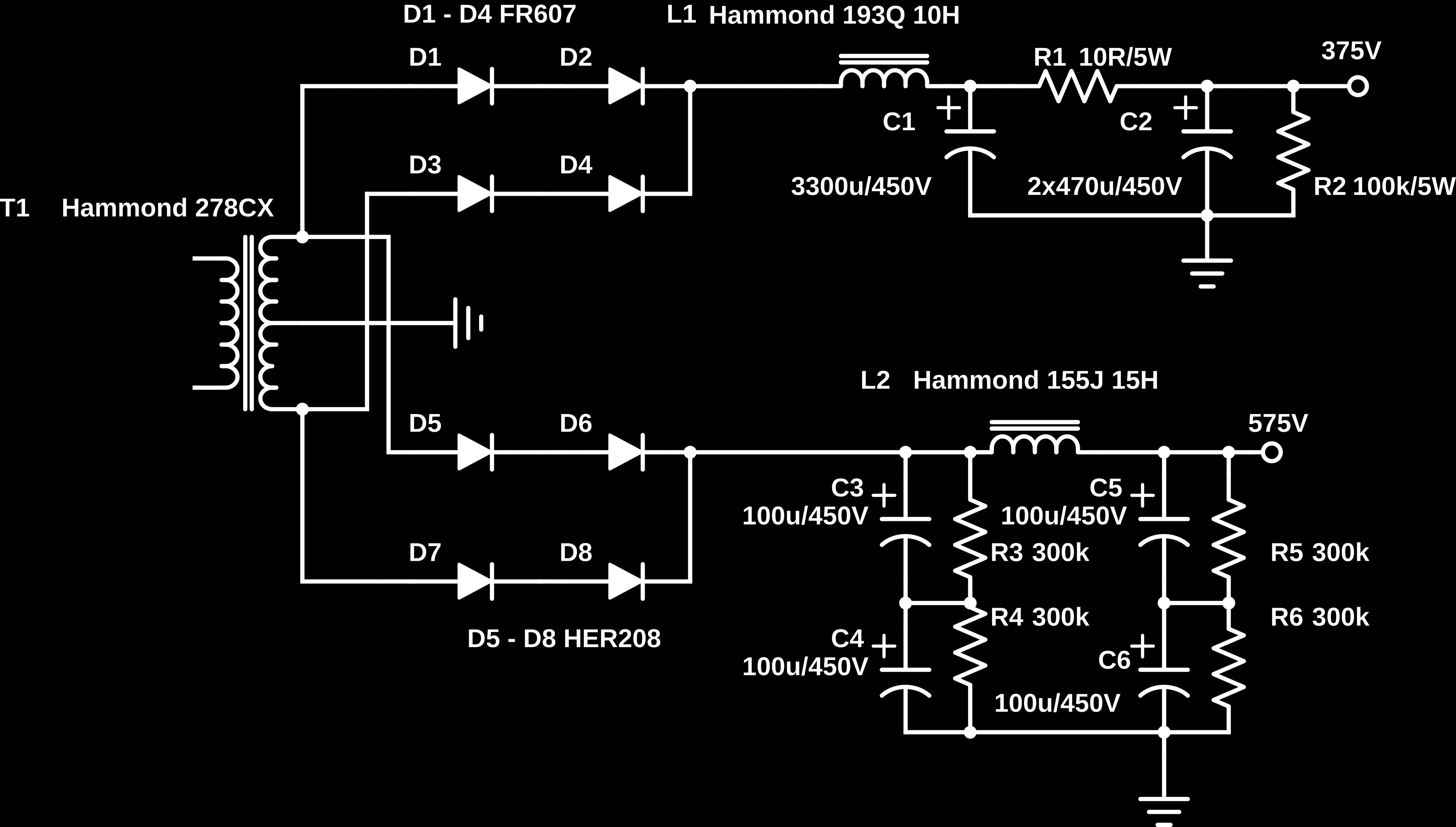

Agreed. I've been running them at 340V/90mA for months. This build is scrapping vacuum rectifiers for SS diodes, so the voltage will be higher.
Very impressive for a tube with a spec of about 16-18 watts dissipation for plate and screen combined. I have some 6P36S lying around; dug one out to take a look and visually compared it to a 6P3S-E. The plate structure on the 6P36S looks bigger than the 6P3S-E plates. I have used 6P3S-E for many years with 450 V / 40 mA (UL-PP, 6k6, 35 W) without any problems, so the datasheet plate dissipation on the 6P36S seems very conservative. Does anyone have similar long term experience with 6P36S and their power and endurance limits?

Interesting project that I might want to build. I have a few questions please.
1. Could you comment on how this amp sounds. I have read many of your threads on various amps that must have been good-sounding too. How does this one compare. How much power output?
2. Would you recommend the Triad toroids in stead of the Hammond 1650N based on performance or cost? Which of the VPT-18 transformers would be the right one?
3. Why did you include the driver behind the phase splitter. I thought the 6GB5 does not need a driver in pentode, UL mode, so I assume you needed it for driving the 6P36S in triode.
It sounds clean and transparent, like any good amplifier should.
I usually go with the Triads based on cost. They also handle far more current, and have a lower DCR increasing output power. VPT18-5560 should be fine. Use two per channel wired series interleave. See my 6P45S monobloc thread for how to wire them.
The VA/PI/Driver is a universal design I use based on the drive requirements of sweep tubes in triode connection needing 60V-80V RMS drive to clip. If wired in pentode mode, the 6N8S section could be omitted. Use a screen voltage of ~150V.

Ok. One more update to the design.
I added an RC filter to the main power supply. This reduces ripple to ~8mV.
I also cleaned up and corrected the main schematic. The grid stoppers are in the right place now, and the values are correct.

Question for those among us with "mathing" skills.
If Ra-a=4300 and screen taps are at 40%, does that mean Rs-s = ~2000? I'm looking for a way to get lower Ra-a from these but still be able to switch 4R or 8R secondary instead of using 16R for 6R to reflect the lower Ra-a.
Screen taps are shown as % of turns. Impedance is related to the square of the turns ratio. So 40% of the turns on the primary corresponds to 16% of the impedance ratio. So Rs-s would only be 688 🙁
anyway, having fewer turns in the opt primary results in lower inductance, not a good scenario....
